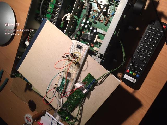

Marcel27
Joined: 13/08/2024
Posts: 104
Posted: 07:08pm 16 Mar 2025
The test is positive. The concept works great. I increased the CNTR form 5 into 2000, 6 into 2001 and the GP1 and GP2 are set to 0 for break. GP1 High is clockwise, GP2 High is counter clockwise. Now just assemble it neatly and then the endurance test can begin.
Edited 2025-03-17 05:34 by Marcel27

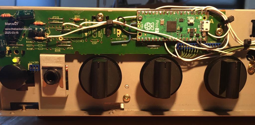

Posts: 9115
Posted: 07:21am 17 Mar 2025
Oh, very artistic. :)
You're not going to wire-wrap it?  ;)
Marcel27
Joined: 13/08/2024
Posts: 104
Posted: 02:23pm 17 Mar 2025
I would have liked to do the wire wrapping but decided against it because the pins were too long.
Neatly built in. For me, good is good enough. I mounted the IR sensor on the original board, pin compatible, added the 180 kOhm to the senor output and ground to adjust the input voltage for the Pico 2. Added a diode in series with the +5V line to the VSYS input in case you connect an USB cable and added some jumpers to get signals at the right places.
I discovered that when the amplifier is switched off there is still 5V on the Pico. So that thing is always thumping.
