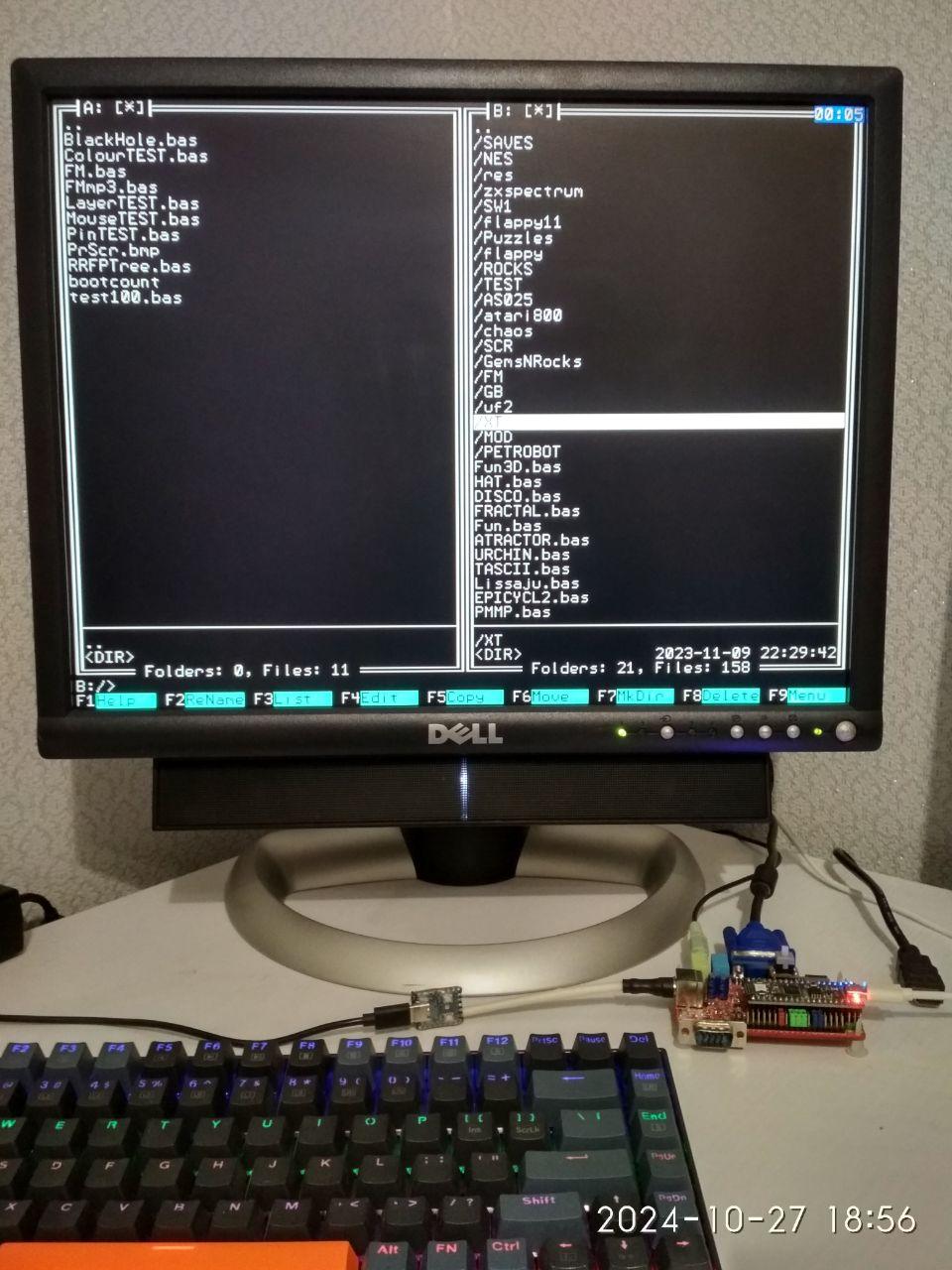

  Mixtel90 said  Oh, and I've never seen a VGA monitor for £5 in a charity shop. AFAIK they aren't allowed to sell them unless they have been PAT tested now, and it costs a lot more than £5 for the test unless it's a fake label provided by a cowboy. We did find a poor quality TV for £10 though, with the remote missing. It has VGA and HDMI though, although the overscan is so bad that they are virtually useless. :)
 Here in Ukraine we have a lot of second-hand computers from Europe. For example, I bought a Dell 2001FP monitor with VGA, DVI, C-Video inputs and a USB Hub for 10 US dollars for my PicoMite lessons.
Yes, I like your PicoTower design, but the only hardware available to me so far is the Murmulator and Pico2 for it.
There in the photo, that gray button on top, is the VGA222/VGA121 video circuit switch.
Best regards, javavi.

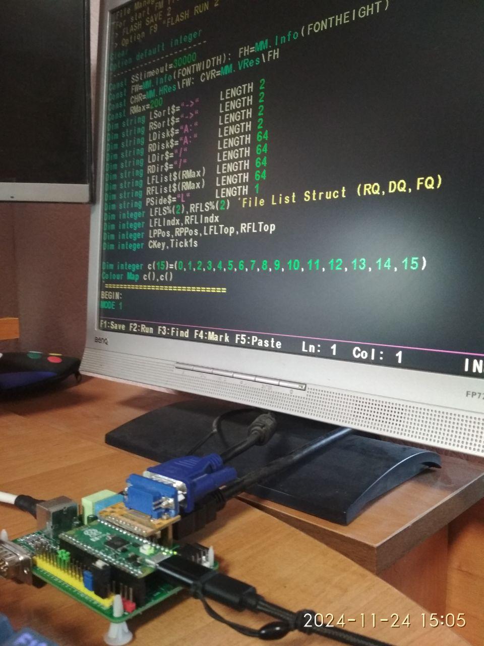

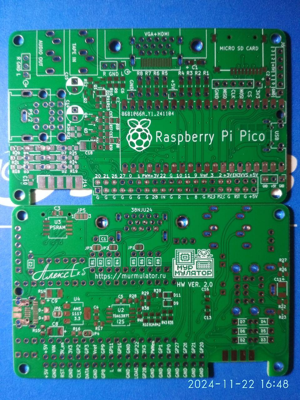

I checked the operation of the latest PicoMite HDMI firmware on the Murmulator2 board with a parallel-connected VGA monitor connector.
Despite the crooked layout of the HDMI video pins of the HSTX Murmulator2 board and the parallel-connected VGA interface, it works perfectly at a high HDMI resolution of 1024x768
Posts: 8965
Posted: 02:34pm 24 Nov 2024
That's good news for PicoTower, Javavi. :) It doesn't change PicoGAME HDMI though as there simply isn't room for the extra bits involved. There would be no support for the HDMI connector as its fixing holes go nicely through the USB-TTL converter and the HDMI socket - even if I move the Pico further down. It's not going to happen on this one.

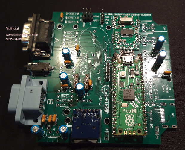

Posted: 02:06pm 01 Jan 2025
Hi Mick,
Progress is being made. Not all parts are in yet, but we are half way...
Posts: 8965
Posted: 03:51pm 01 Jan 2025
Looking (almost...) good!
I'm afraid you have a problem with the USB hub.  :(  It should have the crystal toward the PCB and be on little legs. I'm annoying, I know. It's a technique I wanted to try after having to remove one from an earlier test board when it was soldered hard down on tiny stakes. I figured that if the constructor had to leave a gap then at least they might be able to cut the wires. I might see about getting some 2mm pitch connectors to try.
I find the HDMI socket to be by far the most difficult bit to fit. However, by cleaning both pins and board and keeping the amount of solder paste applied to the absolute minimum you get less tendency to form solder bridges in the first place. This is a "good thing" as getting rid of the little sods at that pitch is a pain.
Posts: 5994
Posted: 09:55pm 01 Jan 2025
Hi Mick,
Oops, that is unfortunate. I should have read the manual better. The hub is SMT mounted (with proper kapton insulation under it). Will be a bastard to get that off again. And the holes are like 2mm pitch, so can't use pin headers. Need 20 individual wires. ..
Have to keep that for next week. When I am back in the office I may find someone with a hot air system that can remove the hub. sh*t...
EDIT: when the hub is mounted so high up, you can never fit the micro USB in the pico2. So you have to take it out of the socket. Why did you add the DIP switch for the USB disconnect (that I jumpered for now). No use, when you take out the pico2.

Posts: 8965
Posted: 11:07pm 01 Jan 2025
The socket on the Pico ends up about 12mm up (8.5mm+2.5mm+1mm PCB) using normal headers. You need plug thickness, but you should still get 8mm or so. There's nothing on the bottom of the hub and the highest component is the crystal, so it should take up about 5-6mm upside down. It certainly looked like it would fit when I was messing about. :)
From Alpha I discovered that if D+ and D- were connected to the Pico Windows wouldn't recognise it and you couldn't load MMBasic. It was easy to disconnect them just while doing that. I'm trying to make it so that you don't need flying leads to the pico for any of the four signals that I'm using though, - hence the extra pins - and I simply don't like removing the Pico to reload MMBasic. That led to looking at switches rather than the jumpers that fumble-fingered people like me keep dropping.  :(
I've found 2mm pitch turned pin male & female headers on AE so I'm going to get a few and try mounting one of these hubs as a plug-in module using 5 strips of 4.

Posts: 5994
Posted: 01:56pm 06 Jan 2025
Mick,
The hub desoldering worked, also the HDMI connector was mounted.
