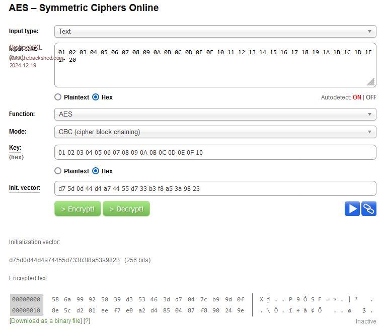

BishopXXL
Joined: 13/01/2019
Posts: 42
Posted: 06:05pm 18 Dec 2024
Hi, short test with "CBC" - worked
Init. vector:
Dim float iv(15)=(&HD7,&H5D,&H0D,&H44,&HD4,&HA7,&H44,&H55,&HD7,&H33,&HB3,&HF8,&HA5,&H3A,&H98,&H23)
Bishop
