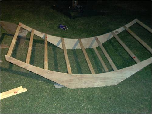

Hi Lee
Many thanks for your post, and the links (that I have yet to look at). To answer your question on location, I live just North of Brisbane.
The parabolic trough in the photo looks as though it should have been able to gather some useful heat, but I would be interested to know how the sun was to be tracked with it.
From my reading, it appears that a properly set out parabolic trough is like a spotlight in reverse. Unless you can somehow keep it accurately pointing directly at the sun as it moves across the sky, its energy gathering capability falls away dramatically. You almost need something like a gymbal mounting and the shadow from a set of cross hairs for this (or better yet, an automatic tracking system).
It also looks as though the tube at the focus is highly polished, which is just the opposite of what you need to absorb heat. Maybe a coat of black high temperature exhaust paint would have helped (providing that you had some way of then removing the heat energy that you were collecting, like filling the tube with water).
Don

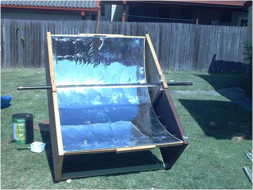

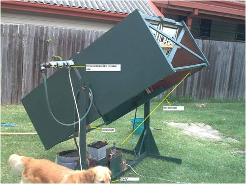

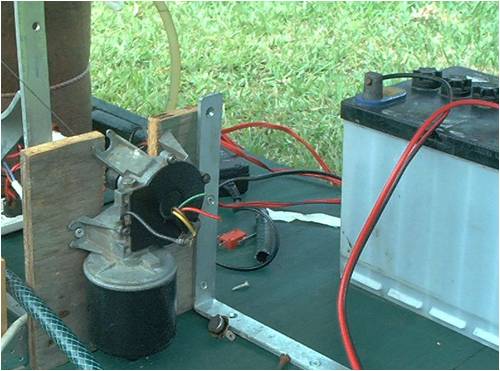

Hi Don,
Tracking was achieved using a circuit that a technician friend of mine built using a couple of green LED's but just noticed you can buy one ebay for $22!
http://cgi.ebay.com.au/basic-LED-Solar-Sensor-unboxed-solar- tracker-DIY_W0QQitemZ200419562043QQcmdZViewItemQQptZAU_Gadge ts?hash=item2ea9efd23b
The sensor circuit controlled a windscreen wiper motor hooked to a 12v battery. A cable was wrapped around the spindle & seemed to move at the right speed. A counterweight was used on the other side. I used thin cable that would break in event of a failure (tremendous torque potential of motor) There were some reed switches at each end to stop it going too far. Seemed to track the sun pretty well.
This design of trough has a major flaw. Because the sides are enclosed, as the sun goes off axis, the light shines on the sides (caught on fire once!). What you need is open sides & the receiver needs to extend further out the sides. It's probably better to build wider rather long as I did.
Here is a second prototype which was better. I'll see if I can find more pics of it.
The receiver is actually black. It's copper pipe that I painted with flat black paint. It just looks shinny when the light is concentrated on it.
Hope this helps.
Lee.

Thanks for the further comments re the tracking of your collector trough. As the width looks to be about 4 times the depth, and the collector pipe is about level with the top of the sides, I assume that it is set out as a classic top focus parabola (y = 4X sq, etc).
I am intrigued at the use of the 2 LEDs as part of the tracking circuit. Were they being used as the actual photo detector devices (which I believe is possible), or were they just being used to indicate when the electric motor was running?
Another question is, what did you do with the heat energy that you gathered?
