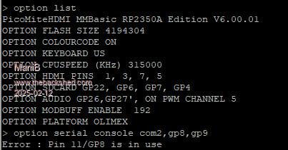

Hello everyone,
I received the Raspberry PI Pico 2 (RP2350) today and, as expected, successfully installed the PicoMiteHDMIV6.00.01.uf2 by typing "OPTION RESET OLIMEX" via PuTTY on the Pico's USB connector.
However, I tried for a long time because my EIZO monitor persistently did not display an image. Only after a lot of back and forth did I connect my Samsung monitor, and lo and behold, I could see something immediately. I had already connected the 5V solder bridge on the underside of the Olimex board yesterday.
But I can't get the PicoMiteHDMIUSBV6.00.01.uf2 to work.
After the installation I have to blindly type “OPTION RESET OLIMEX” with my USB keyboard. So I connected my Logitech USB keyboard to the Pico using a USB-C adapter cable and typed it in blindly - without success.
And the suggestion to connect to the Olimex board via USBtoSerialAdapter in order to make the entries via PuTTY also fails with the error message
> option serial console com2,gp8,gp9
Error : Pin 11/GP8 is in use
Now I'm really at a loss ;(
Posts: 2991
Posted: 11:36pm 11 Feb 2025
Confusingly, your screenshot shows you have the HDMI version of the firmware installed, not the USB HDMI version. My comments below assume you have the USB HDMI version installed (if you want the USB keyboard to work!)
With the USB variant of the firmware installed, the serial port is automatically set for you.
Simply connect your USB-to-Serial module to GP8 & GP9 (refer to manual for which is Tx and which is Rx) and provide the Pico with power too via the Vsys input (or Vbus - again, refer to manual).
You also need to set your terminal baud speed to 115,200.
This will hopefully get you going…..

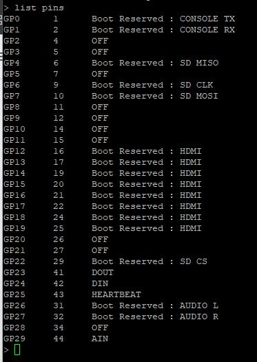

Posts: 3375
Posted: 01:00am 12 Feb 2025
Yes, without USB enabled GP8 & GP9 would be for a PS/2 keyboard.
Type LIST PINS to see what all the pins do.

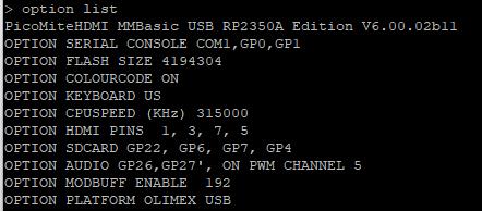

1- use the option list I posted for olimex usb which sets sound and sd card and usb to ttl converter.
2- as above 1
3- a usb keyboard should show on boot. it can be a wireless dongle for a mini keyboard with a mouse touch
Connected to COM3 at 115200
> option list
PicoMiteHDMI MMBasic USB RP2350A Edition V6.00.02b0
OPTION AUTORUN  ON
OPTION FLASH SIZE 4194304
OPTION COLOURCODE ON
OPTION KEYBOARD UK, 0, 0, 600, 150
OPTION CPUSPEED (KHz) 315000
OPTION HDMI PINS  1, 3, 7, 5

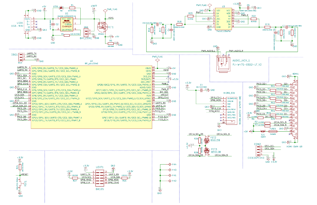

Posts: 11827
Posted: 06:02pm 12 Feb 2025
The Olimex board has a three pin header connected to GP0 and GP1 which can be used for a serial console (DBG1 in the schematic). If you use OPTION RESET HDMIUSB it will set the serial console on GP0,GP1 to use this header rather than GP8,GP9.
So, load the HDMIUSB firmware, connect a USB-UART to pins GP8,GP9 (easiest direct on the Pico2 before plugging it into the Olimex and on a computer console type:
OPTION RESET HDMI USB
Everything will then be correctly configured
Now plug the Pico2 into the Olimex board and connect the USB/UART to the three pin header, plug in the HDMI and you are good to go.
Edited 2025-02-13 04:03 by matherp

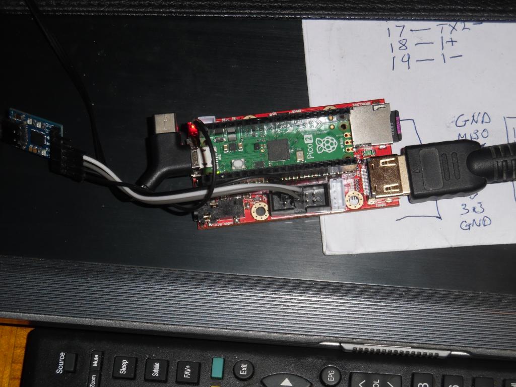

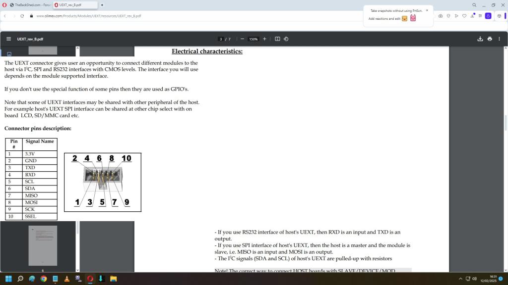

is it this board?
Posts: 2807
Posted: 06:09pm 12 Feb 2025
I connected usb to ttl to this socket.
Edited 2025-02-13 04:14 by stanleyella

Posts: 2807
Posted: 07:33pm 12 Feb 2025
if it's the same board I use the usb to ttl to program from mmedit and it supplies the vcc pin but the board has a mini usb to power the pico and the 5v from usb to ttl is not needed. both ways work ie power board from 5v or use the usb to ttl 5v . but that was frowned about
ManiB
Joined: 12/10/2019
Posts: 168
Posted: 07:59pm 12 Feb 2025
Hallelujah, I've got it working after all.
It's actually done in just four simple steps:
1. Flash the Pico 2 with PicoMiteHDMIUSB flash
2. Connect a USB keyboard to the Pico 2 (if necessary with a USB-C to USB-A adapter)
3. Type in the following command and confirm with ENTER
  OPTION RESET OLIMEXUSB
4. Reset the Olimex board and be amazed
