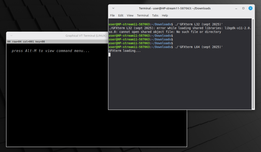

Posts: 2552
Posted: 03:10pm 01 Jan 2026
  Doktorn said  Franks binary (project1) runs on my RPi 3B (bullseye 32) but NOT on my
RPi 4B (bullseye 64). No error messages, just no go.
so if you try to run it from a terminal window (the equivalent of a command prompt in winXP), there are no error messages reported on that terminal window?
i just tried both L32 and L64 versions of the GFXterm binary from GitHub on a clean install of Linux Mint 22.3 XFCE (INTEL processor). this is the results i saw:
note the 32-bit binary produced a similar error message to what Jim was seeing, while the 64-bit binary ran fine. i was then able to add some 32-bit packages to allow the 32-bit binary to run.
for INTEL platforms, the required incantation was:
sudo apt install build-essential libc6:i386 libstdc++6:i386 libgtk2.0-0:i386 libatk1.0-0:i386
(from: https://forums.linuxmint.com/viewtopic.php?t=324997)
this all suggests to me that we will need both 32-bit and 64-bit versions of GFXterm for ARMHF in order to avoid 64-bit Raspbian users needing to jump through hoops installing additional libraries.
i also suspect that Jim may have ended up with a 32-bit version of Lazarus/FPC. likely 64-bit Raspbian out-of-the-box contains enough smarts to run a 32-bit non-GUI application, but not enough to run a GUI (in particular GTK2) application; the Lazarus IDE is just a GUI GTK2 application, while the FPC compiler (used by lazbuild) is a non-GUI application.
hopefully the above makes some sense - it is 4am here and well past my bedtime!
rob   :-)
