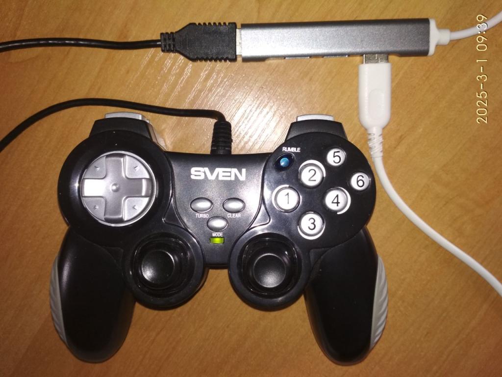

javavi
Joined: 01/10/2023
Location: Ukraine
Posts: 568
Posted: 08:05am 01 Mar 2025
   .vid=0x11FF,.pid=0x3331,
   .b_R1={6,3},
   .b_START={6,1},
   .b_HOME={6,6},
   .b_SELECT={6,0},
   .b_L1={6,2},
   .b_DOWN={1,192},
   .b_RIGHT={0,192},
   .b_UP={1,64},
   .b_LEFT={0,64},
   .b_R2={6,5},
   .b_X={5,4},
   .b_A={5,6},
   .b_Y={5,5},
   .b_B={5,7},
   .b_L2={6,4},
   .b_TOUCH={6,7}
gamepad configure &H11FF,&H3331,6,3,6,1,6,6,6,0,6,2,1,192,0,192,1,64,0,64,6,5,5,4,5,6,5,5,5,7,6,4,6,7

javavi
Joined: 01/10/2023
Location: Ukraine
Posts: 568
Posted: 10:42am 01 Mar 2025
  matherp said  If you post the diagnostics when also moving the analogue sticks we can probably get those working as well
This gamepad is essentially an analog PC joystick. It has two modes: analog and discrete (in which only extreme values ​​for the directions of the analog sticks are set)
The D-Pad processes the extreme positions of the left analog stick.
| 7F | 7F | 7F | 7F | 7F | 0F | 00 | A0 |
 X1   Y1   Z1   X2   Y2  But1 But2 Stat
X1,Y1 - Left Analog Stick
X2,Y2 - Right Analog Stick
Left - X1=00
Rigt - X1=FF
Up   - Y1=00
Dn   - Y1=FF
But1 - B   A   Y   X . 1   1   1   1  (bits)
But2 - Rt  Lt  R2  L2  R1  L1  6   5  (bits)
Stat - A0 - Discret
      20 - Analog
Edited 2025-03-01 20:50 by javavi

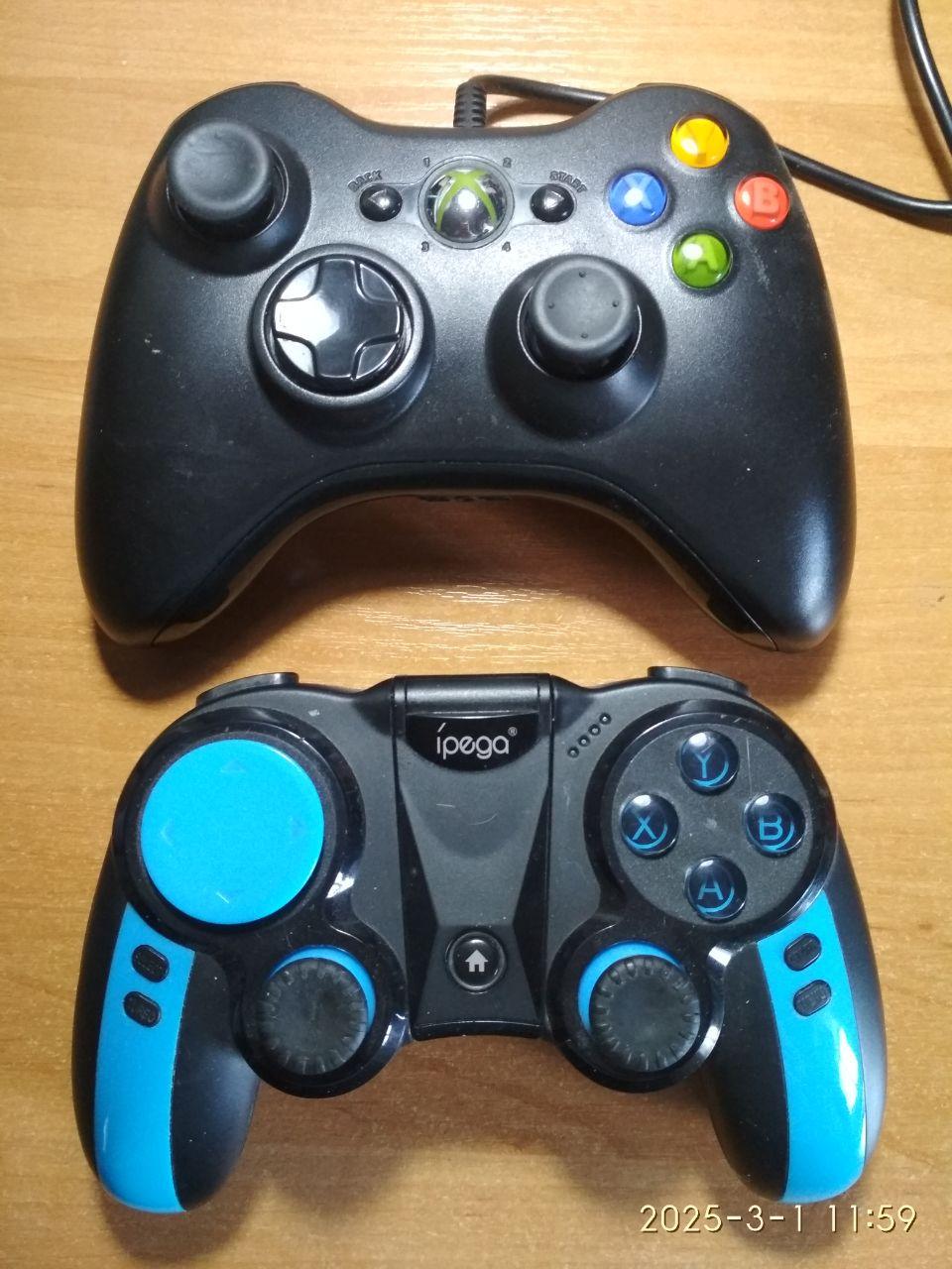

javavi
Joined: 01/10/2023
Location: Ukraine
Posts: 568
Posted: 11:10am 01 Mar 2025
I also have two joysticks for the XBox 360 system.
They are not recognized by the test program at all.
I wish they were also supported by the PicoMite system.

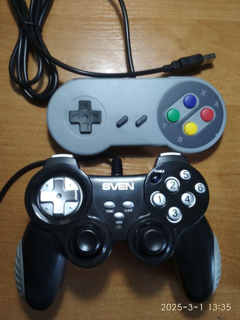

javavi
Joined: 01/10/2023
Location: Ukraine
Posts: 568
Posted: 11:48am 01 Mar 2025
In terms of the report form, this SVEN X-Pad is similar to the top USB SNES gamepad that the PicoMite system currently accepts. They differ only in the VID/PID code.
I think that there are a great many such gamepads, similar in report only from different manufacturers!
They can also contain a different amount of information in the report from the number of axes and buttons.
And it would be better to recognize them by the USB HID device descriptor.
