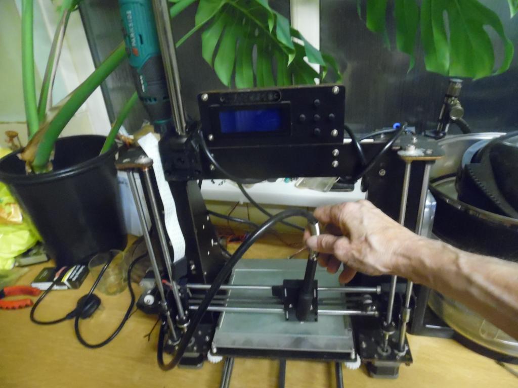

As said I got two 3d printers and one's just sitting there. I'll strip the extruder so just the carriage and sort a router head. it may work??

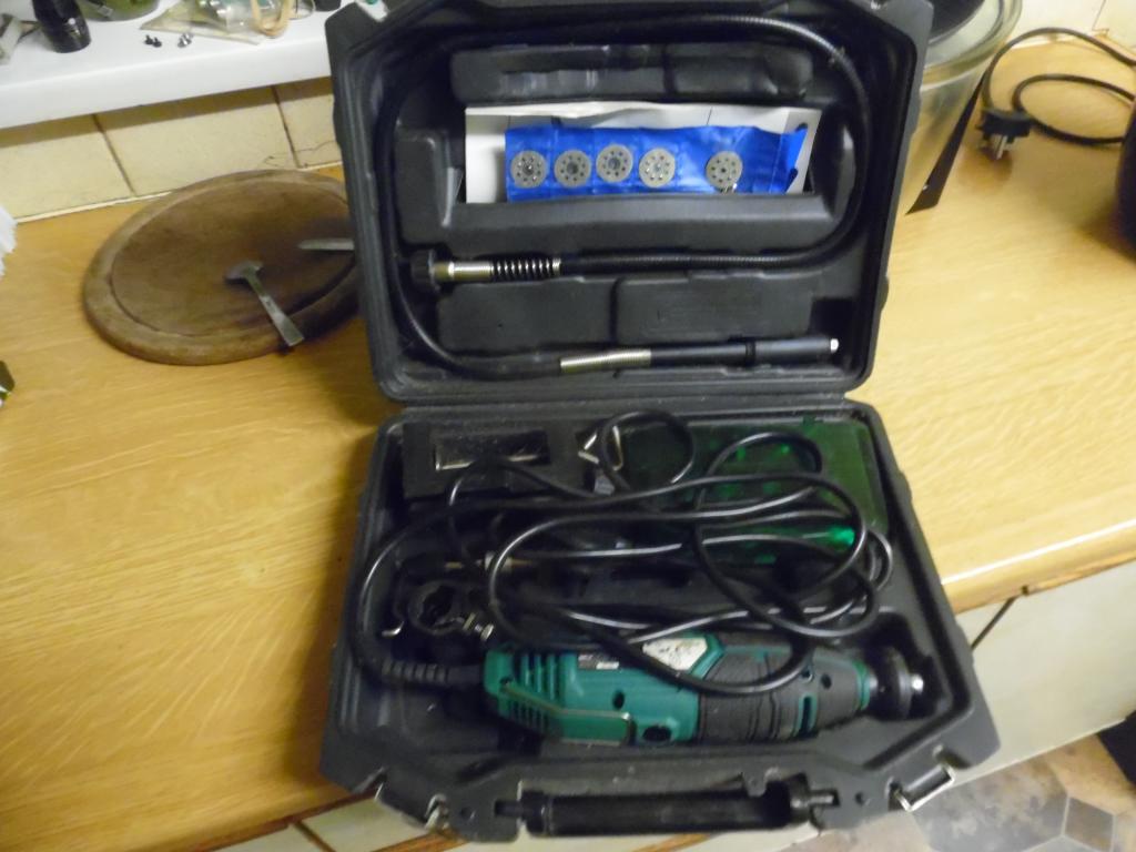

I looked at my lidl dremel and it got a flexi drive which might be a lighter option.
Edited 2025-03-04 05:09 by stanleyella

  stanleyella said   I'll strip the extruder so just the carriage and sort a router head. it may work??
yes why not, if the body of your printer is stiff enough. I looked for so long but from the ratio price/preciseness I think, that Proxxon is the best low cost choice.

thanks for the advice, as said I think it hanging as it's meant to with flexi drive might work, it would need a smaller mount, pipe clamp maybe. see what happens and software to use as it's not a 3d printer adding layers it's going the other way.
let you know progress
Posts: 2807
Posted: 10:21pm 03 Mar 2025
got to make a bracket for the "dremel" extension drive. stripped the extruder and heat bed stuff.

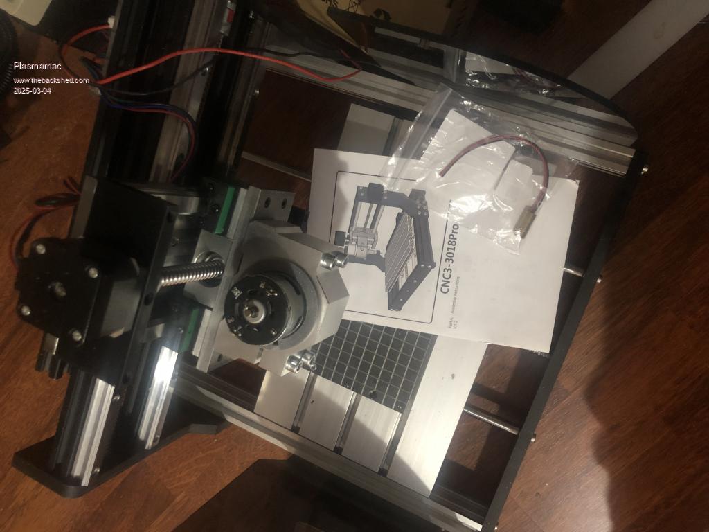

Plasmamac
Joined: 31/01/2019
Posts: 620
Posted: 11:13pm 03 Mar 2025

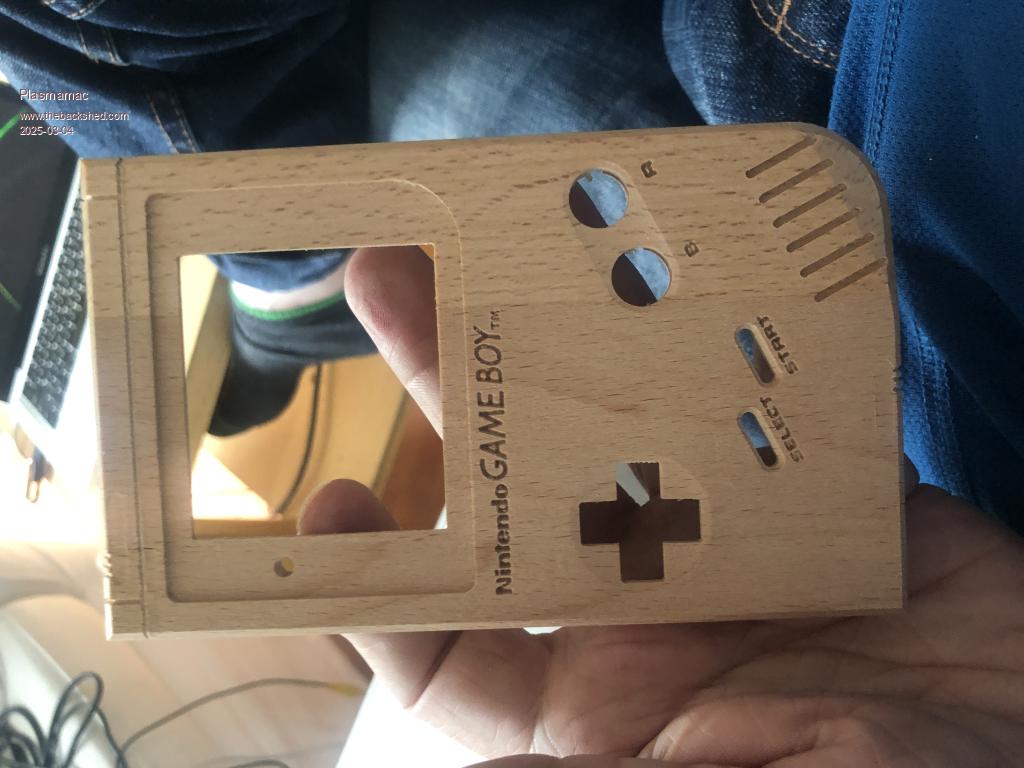

Got a cheap 3018 pro from a big seller for 100 bucks , build some stiffer axis because the original are death after
A friend helps with some Alu parts and ready.
A little motor is my Spindel and works like a charm.
Plasma

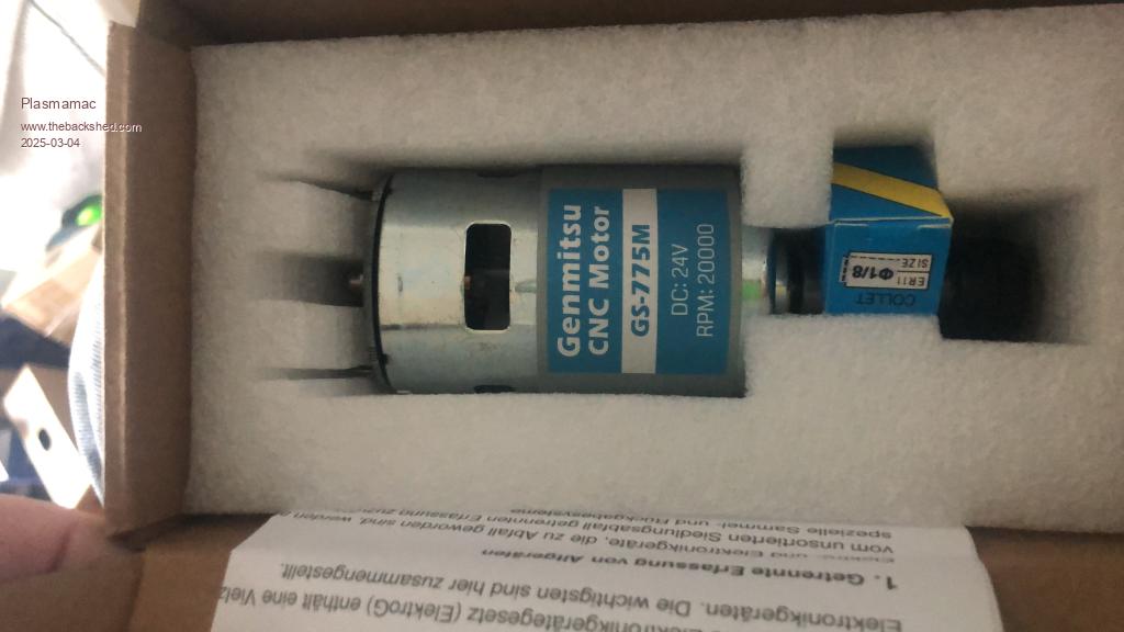

Plasmamac
Joined: 31/01/2019
Posts: 620
Posted: 11:22pm 03 Mar 2025
Hope it helpd

Posts: 5994
Posted: 08:11am 04 Mar 2025
Nice....
A wooden Gameboy...

Posted: 08:23am 04 Mar 2025
  Plasmamac said  Got a cheap 3018 pro from a big seller for 100 bucks , build some stiffer axis because the original are death after
Your result looks very nice!
And it is always good to have friends as the modifications are well done.
But in the end, it is always the same conclusion, that you have to modify and
rework or it is not really usable.
Are the axes driven by trapezoidal spindles? Did you try to mill a PCB as it is harder than wood?

  stanleyella said  got to make a bracket for the "dremel" extension drive. stripped the extruder and heat bed stuff.
I doubt that you will get satisfying results. The A8 looks like I know it and this construction is definitely not stiff enough.
The extension drive will be dead after 3 hour nonstop rotating (I guess).

Posts: 8965
Posted: 10:46am 04 Mar 2025
Those flexi drives aren't up to it. They are too stiff and you would need to sort out some sort of lubrication or it will jam repeatedly. They are fine for their intended use, but not for running for a long time.
There are many pretty high power motors on AliExpress, some with chucks. Is 12V 960RPM ok? There is a package with motor, bracket, speed controller & mains PSU for £22 +vat
Still need a chuck though. That's a geared one. There are basic motors but the spindle speed can be pretty fast!  inclusive kit
775 with chuck & bracket
Edited 2025-03-04 20:54 by Mixtel90
