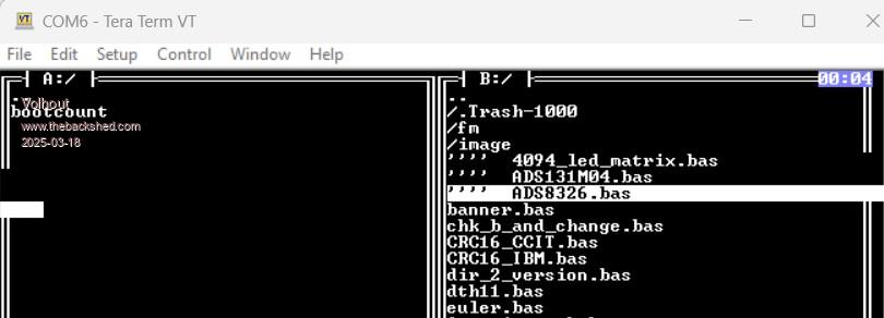

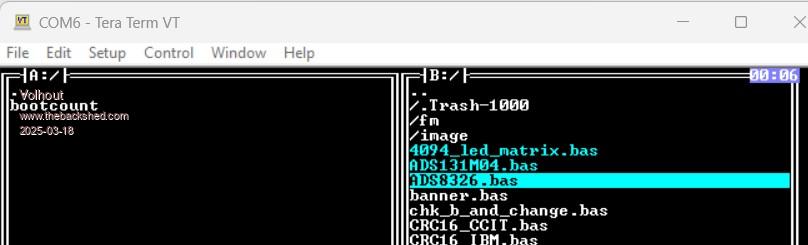

Posts: 6100
Posted: 07:14am 18 Mar 2025
Hi Michel,
Something went wrong. FM 02029 vt100 tested on V6.00.02rc5 on a RP2040GEEK.
This is 02026 when selecting 3 files (teraterm).
This is 02029 when selecting 3 files (teraterm).
