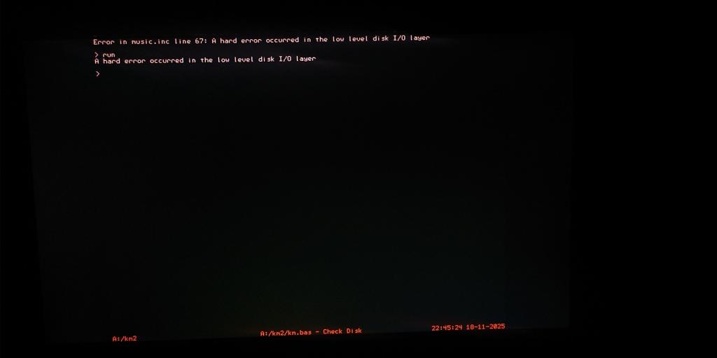

Posted: 03:40pm 18 Nov 2025
Hello Gerry,
Thanks for the b6.
Unfortunately, the USB keyboard is still causing problems. After a longer break (a few minutes) of the CMM2, I need between 3-5 resets to get the keyboard working. If I use the on/off switch, I need more like 8-10 attempts.
If I only need one reset, it can work immediately, but unfortunately this is not always the case :-(
I NEVER had this problem with the last official release version V5.07.01. It only started with the betas.
A second issue is that after a few minutes of play, the game Knightmare throws this error: ‘Error in Music.inc line 67: A hard error occurred in the low Level disk I/O layer’. The line number varies, regardless of the firmware version. LeoNicolas thinks it's not a problem with the programme, but rather a problem with the firmware?!?

Posts: 12058
Posted: 04:35pm 18 Nov 2025
Gerry, you could try squishing the image up to fit in blocks 0-6 again and see if it makes a difference,
My very bog standard Lenovo KU-0225 always connects perfectly with b4 but won't connect at all with b6. I ran Knightmare on b4 and it didn't stop in the few minutes I was playing it.

  disco4now said  V6.00.00b7
Recompiling for size seems to fix the keyboard connection issue.
Yes, it truly does! Thank you.

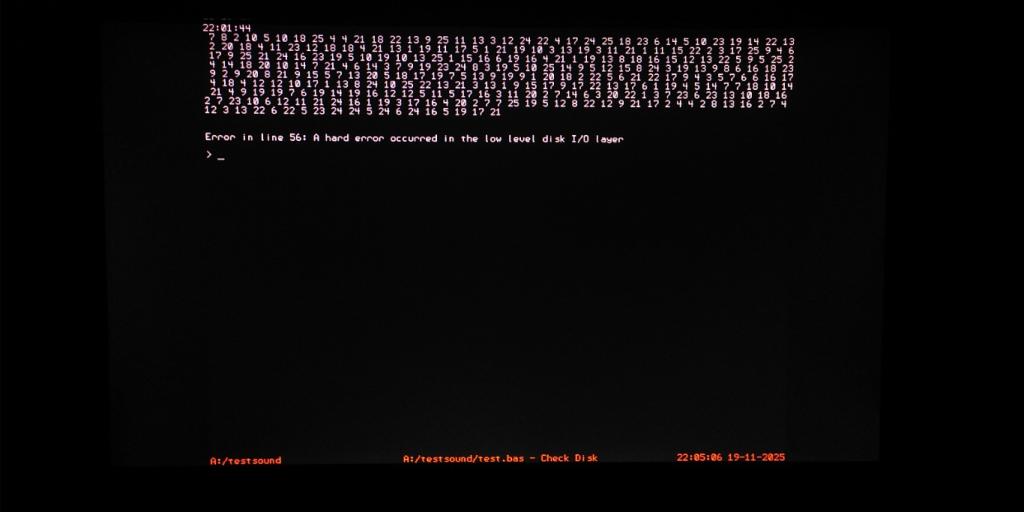

The only thing left is the crash with music effects (Could it be due to dynamic path assignment? Because Files goes haywire when you try to switch to a subfolder (just try it 2-3 times) ... you can see it in the status bar!). I actually wanted to use my graphics grabber for this, but it's currently bricked due to a firmware update. I'll try it with my mobile phone.
But just start the game, set the difficulty to Easy and Stage 1. I can't reach the final boss. The game crashes shortly before that with this screen. Restarting is not possible. The only thing that helps is resetting the CMM2.
The new b7 is really helpful for this, the keyboard is there immediately :-)

Posts: 12058
Posted: 08:26am 19 Nov 2025
  Quote  Recompiling for size seems to fix the keyboard connection issue.
Gerry, Thinking about this overnight, I can see three things to try.
First, individually set the HAL routines to compile Os but compile the rest O2. This would test whether there is a compilation issue with the USB HOST issues. My guess is that this won't be the problem but who knows?
The second is to modify the load file to set up a separate psect in flash area 7. Then allocate specific routines to the psect (e.g. all the maths routines). This would reduce pressure on areas 0-6 allowing many more files to be compiled O2.
Finally, would be to try different versions of the GCC compiler. I think the problems may have really started at a compiler change with an update to the CubeIDE version but can't prove this. Moreover, I don't know in CubeIde how to use a different compiler.
I don't have a version of the current code that compiles. The version I copied from Dropbox gives multiple errors but that may be me not integrating it into my workspace properly. I can though have a play with b4 and see if I can make any progress with that

Peter,
I have been trying  a few of those things. I will try a few more. The Beta7 I published seems to be OK for the keyboard. It actually extends into flash area 7, not sure if its code or just the load file stuff.
The compile does give about 15 warnings on the REGEX stuff. I will update dropbox with the beta7.

  matherp said  Try this version of b7. This is fully up-to-date with Gerry's changes and has my memory frig to re-optimise performance.
I did that. The keyboard also works immediately. No improvement when playing the game. After the crash, "files" can no longer be accessed; the only solution is to reset the device.
Posts: 12058
Posted: 05:39pm 19 Nov 2025
  Quote  After the crash, "files" can no longer be accessed; the only solution is to reset the device.
Sounds like an application issue assuming someone else can replicate. Nothing really Gerry or I can look at unless someone can re-create it with a simple test program.
homa
Joined: 05/11/2021
Posts: 724
Posted: 09:12pm 19 Nov 2025
As requested, here is a small test program. Run it for about 3–4 minutes and the bug will appear.
testsound.zip
Edited 2025-11-20 07:13 by homa
Posts: 12058
Posted: 10:59pm 19 Nov 2025
Running at the moment 15 minutes and no issues (my b7). Will leave it running overnight but I suspect the issue is in your environment SD card or PSU
