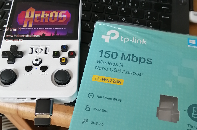

Tom,
I have now found a supported WIFI adapter that is supported by ArK Os.
tp-Link TL-WN725N
SSH access tested and working. I will try again later this week to work through your instructions.

Posts: 4405
Posted: 09:20am 04 Jun 2025
  Gadgetguy said  On a related note, can i use (after all is set up) a usb keyboard connected to the r36s via the usb otg port?
I believe so.
What I have explicitly tested is attaching the wireless dongle from my Logitech K270 keyboard to the R36S via OTG and the keyboard then works inside an MMB4L game.
What I have not tried to do is work out how to get the R36S to display an actual Linux terminal on its display (I always SSH), perhaps this is an exercise for the reader ?
  Martin H. said  I have now found a supported WIFI adapter that is supported by ArK Os.
tp-Link TL-WN725N
Dare I ask how many WiFi adapters you went through before finding one that worked ? - the only one I had just worked so I have no idea of the extent of the issue.
Is the "adapter" between the WiFi USB-A and the R36S USB-C a specifically OTG adapter or just a "generic" A <-> C adapter ? ... some sources assert that OTG is meaningless wrt USB-C ... but that assertion may only be valid for USB-C <-> USB-C connections.
Edited 2025-06-04 19:50 by thwill

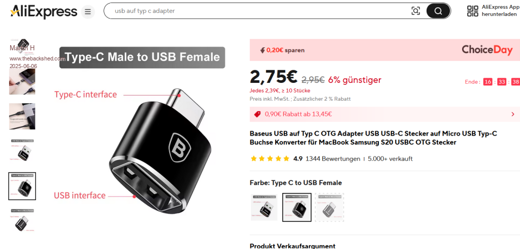

Posted: 04:02pm 05 Jun 2025
I Used this USB  A <-> C adapter, that was offered as OTG adapter
I tested 6-8 USB Wifi-adapter, everything I had lying around here from Raspberrys to 3D printers and similar.
Edited 2025-06-06 02:05 by Martin H.
'no comment
Posts: 4405
Posted: 04:36pm 05 Jun 2025
  Martin H. said  I tested 6-8 USB Wifi-adapter, everything I had lying around here from Raspberrys to 3D printers and similar.
That is a lot!
Did you try them all with the OTG adapter, or did you try, and dismiss as non-functional, some of them before you got the OTG adapter ?
