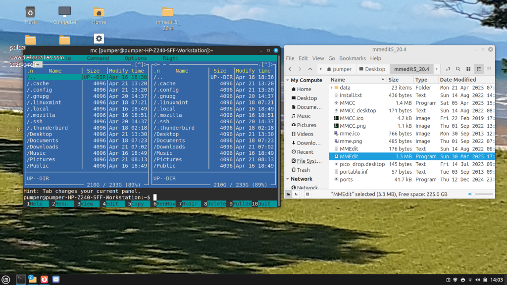

palcal
Joined: 12/10/2011
Posts: 2053
Posted: 04:05am 21 Apr 2025
This is all I can get...
I seem to be in the wrong place. This is completely new to me and I'm a bit out of my depth.
palcal
Joined: 12/10/2011
Posts: 2053
Posted: 04:07am 21 Apr 2025
I don't know how to navigate to the desktop in the terminal.

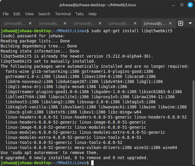

  Revlac said  Thanks  SimpleSafeName
That MC is nice,
Didn't see this before,
libQt5WebKitWidgets.so.5
...Imagine a picture here...
Will check back later have other work to do now
Excellent! Glad that it was helpful. :)
I have found that mc is the best way to see what is going on.
Now for libQt5WebKitWidgets.so.5, you should be able to manually install it with this command:
sudo apt-get install libqt5webkit5
I did this for some other program that required QT so I had no problem running MMEdit (well, assuming that was the only thing that I did differently. There's no telling until libqt5webkit5 is installed).
Even though I already have it installed, I did a fake install to see if apt-get was aware of it:
Notice that it located libqt5webkit5? I seem to recall that I had to point apt-get to the correct sources, but it should walk you through that part.

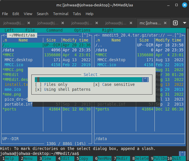

So looking at your screenshot, you are in your Home folder. Good. So if you haven't already created a directory for MMEdit, hit:
'F7'
Type in 'MMEdit' and hit Enter. This will create your MMEdit directory.
The cursor for mc will park itself on the newly created MMEdit directory. So please hit Enter. That will take you into your new directory.
Now hit 'TAB' to travel to the opposite panel. Navigate to your Downloads directory and locate MMEdit. (or wherever it is located).
Highlight the 'mmedit5_20.4.tar.gz' file and hit 'Enter'. This will cause mc to open the .tar.gz file. This works for .zip files too (and many other types of compressed files as well).
Important!!
Because you are operating on a compressed file and not in a directory, mc does not select (highlight) the directories when you select them as instructed in the next part.
Hit '+', a popup box will appear. If this is the first time that you do this, it will be empty. Hit '*' to tell the selection box that you want all of the files as well as all of the directories selected.
And again, if you are operating on a compressed file (mc will let you know), you may (will?) have to select your directories manually.
What mc looks like when it has opened a compressed file:
And to select/deselect a single file, hit the Space Bar.
Now hit 'F5' This will copy all of the selected file from one panel to the opposite one.
Hit 'TAB' to go to the opposite panel.
Hit 'Control-O' to get you to the terminal.
Type in './MMEdit' and hit enter.
Please left us know what it complains about. Thanks!

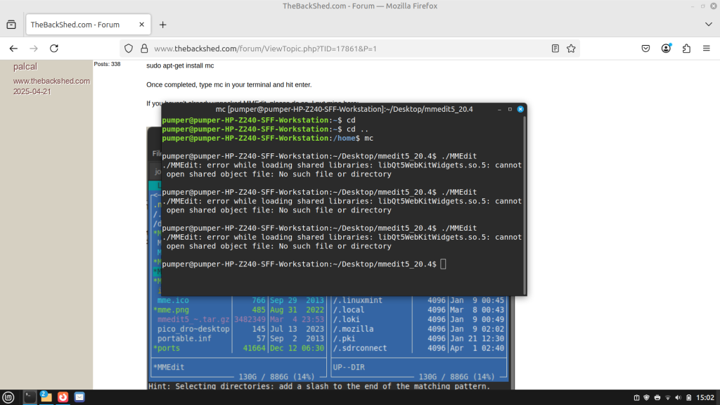

palcal
Joined: 12/10/2011
Posts: 2053
Posted: 05:03am 21 Apr 2025
Is this what you wanted....
Revlac
Joined: 31/12/2016
Posts: 1309
Posted: 05:16am 21 Apr 2025
Ok thanks,
Got MMEdit working for me.
Yet it looks so similar to the one in the Readme file, although that one has "default" in front.
Happy now.
Cheers Aaron
