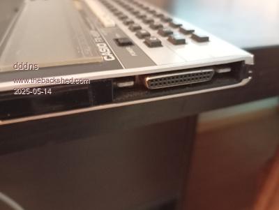

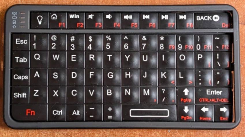

This is the minimum size I'd suggest.
They even bigger question is the display.

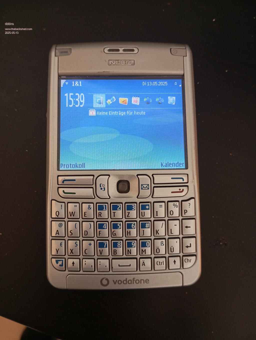

My E61 I own since 2005. So nice and so ugly to handle.

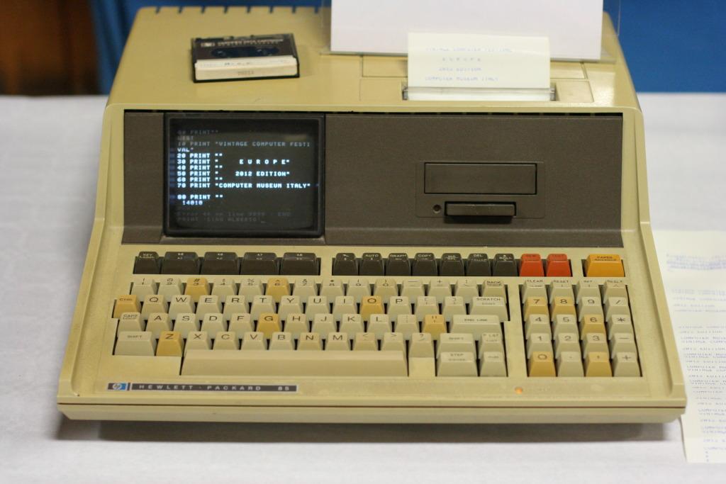

PeteCotton
Joined: 13/08/2020
Posts: 667
Posted: 06:30am 14 May 2025
  Nimue said
  dddns said  I suspect there would be a market for a HDMI version in the form factors of something like the Pi400 or AcronElectron.  Something with a real keyboard, all in one type affair
Yeah - I think I agree with this. My problem with the calc format - is that I can't see anyone writing any sort of substantial program with those tiny keys. That's not to say it wouldn't sell a bucket load - just that I'm not sure what market it is filling.
One of the many ideas I've been toying with (and failing to make time for) is a proper desktop "calculator", like the HP 85. I think that would be brilliant. These guys were used a lot for interfacing to instrumentation - so maybe a sort of HP85/PLC hybrid that people can use for full blown I/O.

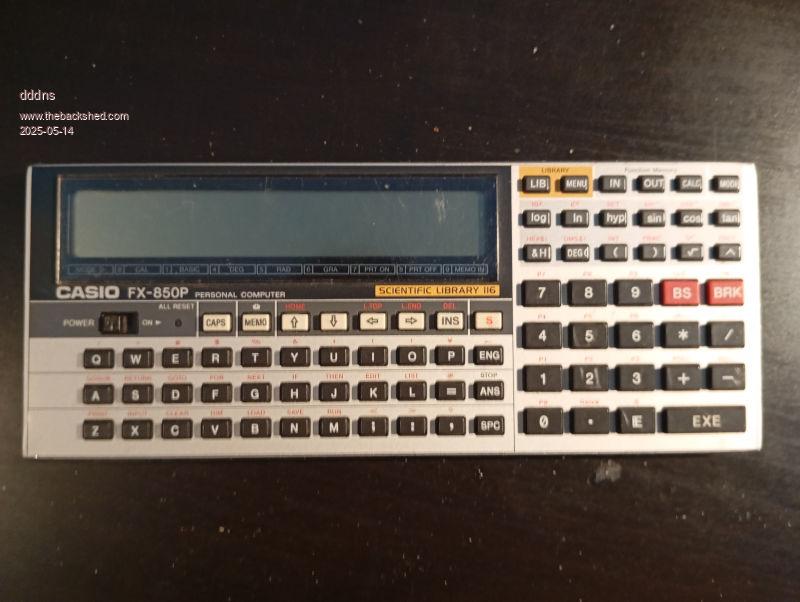

dddns
Joined: 20/09/2024
Posts: 924
Posted: 06:52am 14 May 2025
Oh Pete, you made my day. It's a beauty! :*
Again and again impressive to see, how advanced we were already in the 80's.
The question how good a device is to handle is the main criteria beside functionality if it stays and is accepted. In the 80's they already paid enormous attention to this aspect resulting e.g. in all the Ti calculators with brilliant keybaords and then Casio simplifying it but keeping or enhancing the usability. This is with me since 1985 and bound me so many hours at that time as it was soo! nice to handle:
I really have to change the batteries and see if it still comes up :) ..but I think so :))
Frankly speaking I'd say, this is still _up_to_date_ !!!

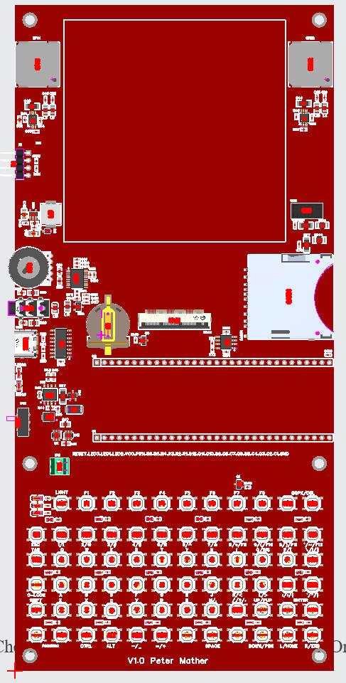

Posts: 12060
Posted: 04:29pm 08 Jun 2025
Just for fun I thought I'd wiffle up a quick design
638d583c-054c-4da4-8a17-665bf62057e0.pdf
This uses the 64pin DIL RP2350B module as the CPU and just adds known working bits and pieces from my various designs: Battery power and charging, RTC, I2S audio and stereo amplifier, On board ESP for wifi connectivity, SDcard. It uses a discrete keyboard and would be laid out to fit this overlay.

Posts: 12060
Posted: 06:49pm 08 Jun 2025
Laid out but not routed. Board is 108x225mm
  Quote   Just one question, is there any way to include an hdmdi display?
That would be a completely different design - so no.
Cost about USD32 in 5-off quantities (cheaper in bigger numbers) + the cost of one of my 64-pin DIL modules which adds another USD20
For those new here: I don't sell anything, I just make the design files freely available.
