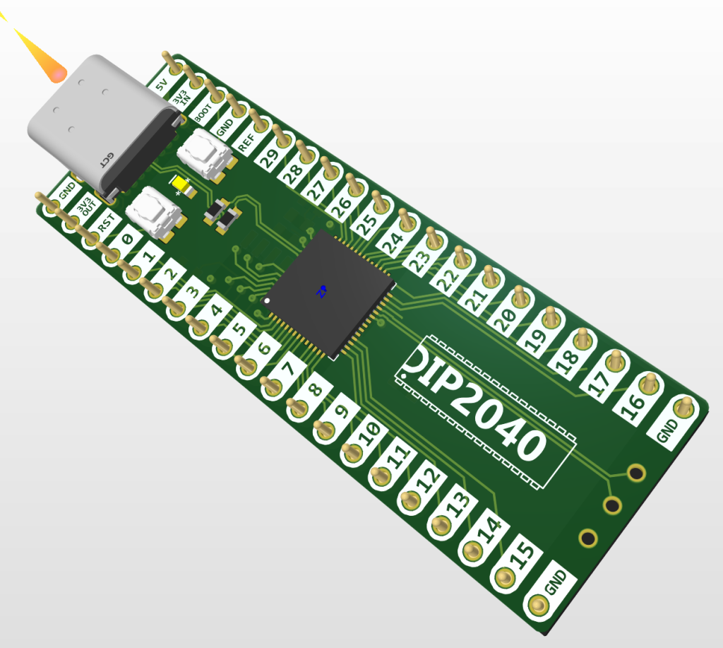

  Quote  I wish they would make a dip40 or dip68 (like the 68000) package... (with ALL the gpio's brought out and ditch the on-board noisy regulator. only USB-C , reset and boot button and flash/psram on the qspi). i may have to roll one.... the current boards are wider than a standard DIP40
Not quite what you want but...
They have the same footprint as a standard Pico RP2040 but these have all the GPIO pins, a linear reg, USB-C and 16MB flash. Select the Purple 16M one.
There are many other sellers with this module so it is worth shopping around.
One with a better view of the pins Scroll down to the description.

Posted: 04:24am 10 May 2025
More something like this : Fits a standard DIP40 socket without overhanging.
