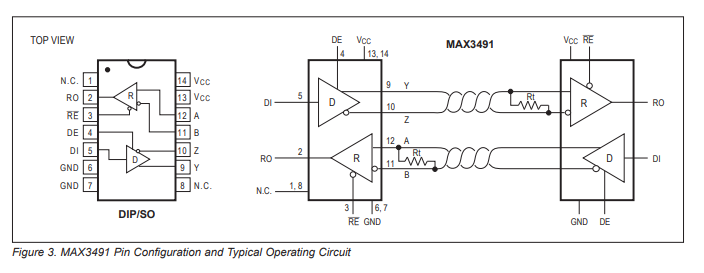

  dddns said  this maybe?
Another possible way
Heck, what is wrong with me
All of my existing UART comm's are Full Duplex, differential transceivers and they have, wait for it.....ENABLES
This is all I need to do (I think) and then get creative with how to make the node-of-interest, active:

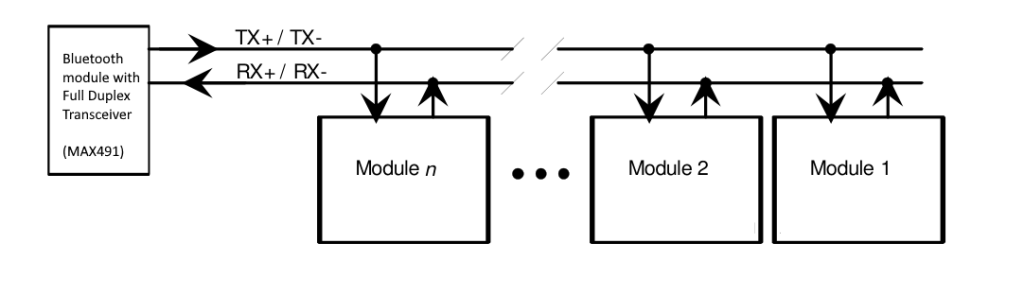

I think you don't need to worry about the enables.
If you have everything active and just establish some ground rules (a protocol) then everything will live nicely. yours is a wired version of a wireless network.
I did a star on several installations of a snooker table manager using scores of HC-12 433MHz modules hidden in the ceiling roses of the lights over the tables (and a few other exotics). Each had an address and only the master could initiate conversation (to prevent collisions) and the protocol kept everything tidy. In the production kit, I took this a  stage further with multi-channel wireless on some devices to act as proxies and cover blind-spots. That got complex but it worked - would recommend "flatness" of your network   Each slave ran identical software which was really nice, configured at install time and saved in Flash. Incidentally, this was the point I moved into the abyss because versions of MMBasic after 5.0408 erase the flash when you load your prog... I just couldn't do the re-config on 200 modules just because I uploaded new software... but 5.0408 is rock solid so I am not complaining.
write-up here  with working code. And here  is a vid of two micromites, and a MMX all talking to some VB on my laptop (the master) actually doing it with that protocol
No reason the same thing wouldn't work on wired multi-drop - the transmission medium is irrelevant if you consider the protocol only wants the data to move reliably. In my SIL module, I have made provision for multi-drop with a single diod and it work with a similar protocol really well over small distances (few metres - it's only 3.3V). The key really is having a layer of your software over the comms port, then you can do it on the cheap if you don't want to use hardware modules

  CaptainBoing said  I think you don't need to worry about the enables.
This is a bit different, bud.
Yes, my standard 4-wire multidrop works as you described although I do use the TX enables on the slaves whereas the master has RX & TX permanently enabled.
But what I'm looking at here is a way to have one console connection talk to multiple slaves, albeit one at a time. If I need to edit the code, etc. on a particular node, I want one connection but be able to talk to the selected node. All other nodes (PicoMites) need to be totally isolated from both TX & RX.

Phenix,
They call that MODBUS (RTU / ASCII).
You do not have to use RS485 hardware interface. Your RS232 multidrop will also work (short distance). MODBUS is designed to be addressable and robust (CRC).
I have already writen a MODBUS RTU master. And a MODBUS spy, it would not be too hard to also make a MODBUS slave running on a Pico, since all the blocks already exist in the master.

You missed it
This is about using one console/terminal connection for a string of PicoMites. Need to select/isolate the devices.
My main control network is separate. I have chosen Network Modular Control (NMC) for the control network, due to better efficiency:
