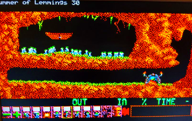

little demo
Lemmings.zip
'no comment
Posts: 6195
Posted: 03:26pm 19 Aug 2026
Nice !!!
Only the HUD need new pixel art. The rest looks fine for this small level.
The movements are fast , even with 50 on screen.
Compliments ... !
Envision mouse control ?
Edited 2026-08-20 01:27 by Volhout

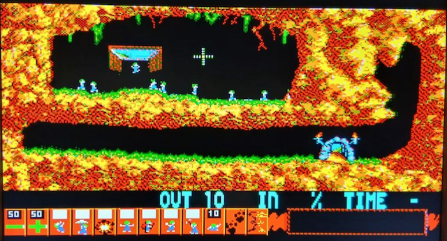

This is what it might look like
'no comment
Posts: 6195
Posted: 09:46am 20 Aug 2026
Hi Martin,
The new HUD is a major improvement.
I think your demo is impressive, but it will be near impossible to use it as a basis for a game becuase memory.
You use both framebuffer and framebuffer layer. That leaves 37k free heap , from which 28k will be reserved for variables. Hence only 9kbyte to work with.
Currently the game screen is an image, and as such you could try to make a game. Then 9kb would be good enough. But when you start using the tiles for the game screen, you need an array for just the game screen, and your 9kb is gone.
It would be much easier when you use either L or F buffers, or design the game around graphical game screens. If that is at all possible. I haven't thought through it far enough to see if this is possible. Digging holes would not be a problem, explosions would not be a problem (dirt gone..is dirt gone).
Maybe it can be done... complexity would be if a game screen is larger than visual area. When scrolling through modified landscape (dug holes that scroll outside the visible screen, must re-apear when you scroll back). I think it could only be done when each level constrains to visible area.

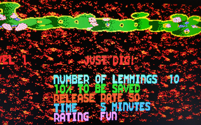

In normal gameplay, an info card appears before each level, describing the level. That is precisely when there would be enough time to reload the elements and tilemap for the next level. In the game itself, the rules for the individual Lemming types, which the programme processes, are only ever needed up to the next step.
So, for example, if a ‘Walker’ realises it no longer has any ground beneath it, it would fall (this is entered as the object type for this sprite, and the y-position is used to determine, upon ‘impact’, whether the Lemming survives or might even have a parachute). etc.

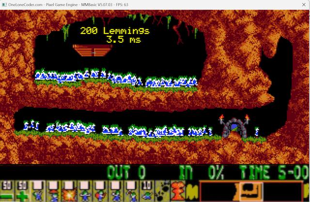

Nice, You’ve used the full-colour PNGs
Here is a little Video of the Pico Demo
I don’t have CMM2, but with a few minor tweaks, your script will also run in mmb4windows
'MMB4W
OPTION BASE 0
OPTION EXPLICIT
OPTION DEFAULT NONE
CONST LEMMINGS_NUM=200
CONST LEMMINGS_SPEED=60
CONST PAGE_DISPLAY=0
CONST PAGE_BUFFER =1
CONST PAGE_SPRITES=2
CONST PAGE_BACKGND=3
CONST LEM_X=0
CONST LEM_Y=1
CONST LEM_Dir=2
CONST LEM_Anim=3
CONST col_BLK=RGB(Black)
DIM Integer Lem(LEMMINGS_NUM,4)
DIM Integer nr
mode 3,16
PAGE write PAGE_SPRITES
load PNG "img/lemmings1.png",0,0
PAGE write PAGE_BACKGND
load PNG "img/level01.png",0,0,8
load PNG "img/hud.png",0,160,8
play modfile "tenlemmings.mod"
Lem(0,LEM_X)   =280
Lem(0,LEM_Y)   =120
Lem(0,LEM_Dir) =int(RND*2)
Lem(0,LEM_Anim)=int(RND*8)
for nr=1 to LEMMINGS_NUM-1
 Lem(nr,LEM_X)   =36+int(Rnd*166)
 Lem(nr,LEM_Y)   =choice(nr<LEMMINGS_NUM/2,50,120)
 Lem(nr,LEM_Dir) =int(RND*2)
 Lem(nr,LEM_Anim)=int(RND*8)
next
DIM Integer lx,ly,di,an
DIM Float tim,T,D
PAGE write PAGE_BUFFER
do
 tim=TIMER+60 : T=TIMER
 PAGE copy PAGE_BACKGND to PAGE_BUFFER
 Text 120,18,str$(LEMMINGS_NUM)+" Lemmings","C",7,,rgb(yellow)
 Text 120,27,str$(D,4,1)+" ms","C",7,,rgb(yellow)
 for nr=0 to LEMMINGS_NUM-1
   lx=Lem(nr,LEM_X) : ly=Lem(nr,LEM_Y) : di=Lem(nr,LEM_Dir) : an=Lem(nr,LEM_Anim)
   blit (di<<7)+(an<<4),0,lx,ly,16,16,PAGE_SPRITES,&B100
   an=(an+1) mod 8
   if di Then
     inc lx,-1 : if Pixel(lx+4,ly+8)<> col_BLK then di=0
   else
     inc lx : if Pixel(lx+12,ly+8)<> col_BLK then di=1
   end If
   inc ly,choice((Pixel(lx+8,ly+16)<> col_BLK),-1,1)
   Lem(nr,LEM_X)=lx : Lem(nr,LEM_Y)=ly : Lem(nr,LEM_Dir)=di : Lem(nr,LEM_Anim)=an
 next
 D=(TIMER-T)
 PAGE copy PAGE_BUFFER to PAGE_DISPLAY,B
 do : loop until TIMER>=tim
loop until keydown(0)>0

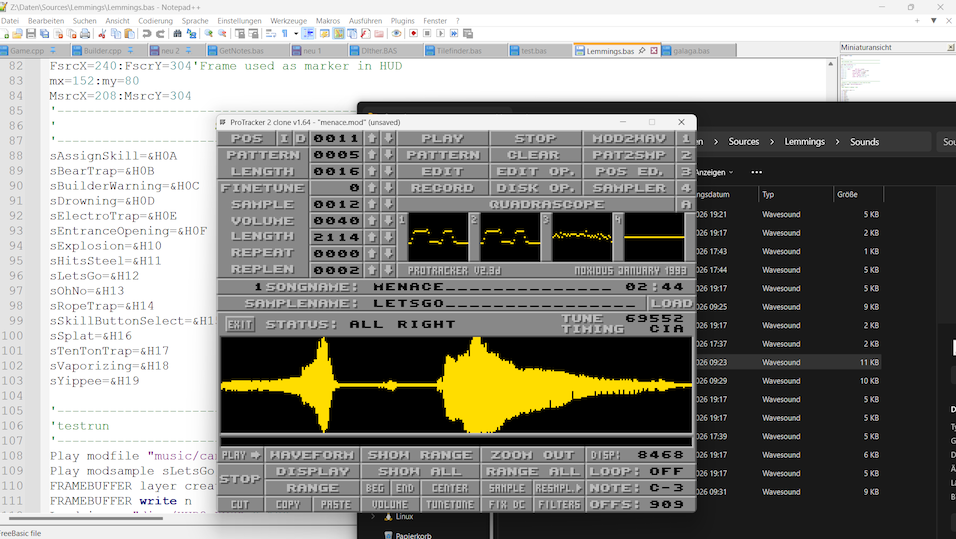

Volhout,
I’ve summarised the music here and added the sound effects
'                     SoundFX Samplenumbers in MOD
sAssignSkill=&H0A
sBearTrap=&H0B
sBuilderWarning=&H0C
sDrowning=&H0D
sElectroTrap=&H0E
sEntranceOpening=&H0F
sExplosion=&H10
sh*tsSteel=&H11
sLetsGo=&H12
sOhNo=&H13
sRopeTrap=&H14
sSkillButtonSelect=&H15
sSplat=&H16
sTenTonTrap=&H17
sVaporizing=&H18
sYippee=&H19
It was a durty job, but someone’s got to do it
Music.zip
EXCEPTIONS
sfx.mod no music, only the SFX
awesome.mod,beastI.mod,beastII.mod and intro.mod just Music no SFX
In addition, the animations for entering and exiting have been added to the sprite sheet
Martin

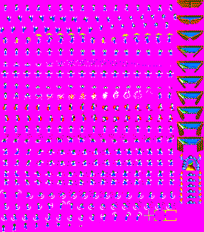

Harm,
To be able to work with it, if you’d like to use the template.
Dim ssrc(15,4)
'Lemming types and attributes
'Sourscoordinates 0=xr,1=yr,2=xl,3=yl,4=Number of Animationframes
'(where to find the sourcesprite)
'Climber
'Floater
'Exploder
'Blocker
'Builder
'Basher
'Miner
'Digger
'----- Not assignable -----
' Walker
' Faller
' Shrugger
' Flipper
' Splatter
' Homer
Const LemWalker=1
ssrc(1,0)=0:ssrc(1,1)=0: sprt(1,2)=128:ssrc(1,3)=0: ssrc(1,4)=8
Const ALemClimber=2
ssrc(2,0)=0:ssrc(2,1)=16: ssrc(2,2)=0:ssrc(2,3)=32: ssrc(2,4)=8
Const LemFloater=3
ssrc(3,0)=0:ssrc(3,1)=48: ssrc(3,2)=128:ssrc(3,3)=48: ssrc(3,4)=8
Const LemExploder=4
ssrc(4,0)=0:ssrc(4,1)=64: ssrc(4,4)=32
Const LemBlocker=5
ssrc(5,0)=0:ssrc(5,1)=96: ssrc(5,4)=16
Const LemHomer=6
ssrc(6,0)=0:ssrc(6,1)=320: ssrc(6,4)=8
Const LemSinker=7
ssrc(7,0)=0:ssrc(7,1)=112: ssrc(7,4)=30
Const LemBuilder=8
ssrc(8,0)=0:ssrc(8,1)=144: ssrc(8,2)=0:ssrc(8,3)=160: ssrc(8,4)=16
Const LemBasher=9
ssrc(9,0)=0:ssrc(9,1)=192: ssrc(9,4)=16
Const LemDigger=10
ssrc(10,0)=0:ssrc(10,1)=208: ssrc(10,2)=0:ssrc(10,3)=240: ssrc(10,4)=32
Const LemMiner=11
ssrc(11,0)=0:ssrc(11,1)=272: ssrc(11,2)=96:ssrc(11,3)=288: ssrc(11,4)=22
Const LemFaller=12
ssrc(12,0)=224:ssrc(12,1)=128:ssrc(12,4)=2
Const LemClimberEnd=13
ssrc(13,0)=128:ssrc(13,1)=16: ssrc(13,2)=128:ssrc(13,3)=32: ssrc(13,4)=8
Const LemSplatter=14
ssrc(14,0)=0:ssrc(14,1)=80: ssrc(14,4)=16
Here is the summary, i.e. the mapping of the individual sprite types to the coordinates on the source image
Sourscoordinates:
lem,0=xrright,lem,1=yright
lem,2=xlleft,lem,3=yleft
lem,4=Number of Animationframes

Even though it looks almost the same as before, the game now uses the Lemmings’ actual controls.
Mouse control also has been added
Some of the Lemmings type functions are already built in.
(For more details, have a look at the Sub move_lms )
Lemmings.0.2.0.zip
That’s the basic framework of how the game might work.
For the different levels, I’m looking at the NES and Sega Master System versions, as both systems use tile-based backgrounds – which is what could be done on the Pico using tilemap.
framebuffer F is no longer used, as the display output is fast enough. You can use the mouse crosshairs to determine how long the flickering lasts. On the Pico 2 (252 MHz), the slight flickering stops at around the level of the entrance.
Martin

Hi Martin,
Looks amazing...You are a wizzard !!! Now I have to get my Aegon VGA unit out, since ti has mouse support.
Playing it atm on Mixtels PicoGameVGA unit.
I'll take a closer look on what you did this weekend probably (with the Aegon unit).
