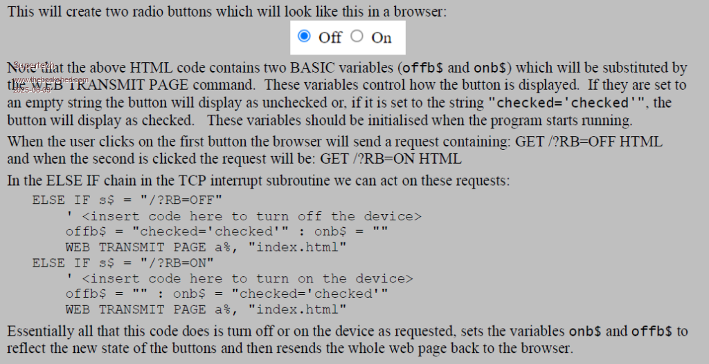

Anything missing in all manuals to date? See who notices....?
Why not scan Manual for 'MMBasic syntax typos', like say MMEdit would do, before publishing it even as draft. This would save us humans to try to see the obvious errors we miss over and over, and our precious time to find them!
Webmite, Grand QUESTION to Publishers:
Geoff, the publisher of Webmite Manual, 'Have you ever copied and pasted "your own typed examples" into say MMEdit (set as Webmite), sent to correct hardware and "Run"' to see that YOUR examples "actually work" FROM ANY of your manuals?
I acknowledge the huge work in this. it is exceptional and thank you all.
Regards to All. Supertech.
