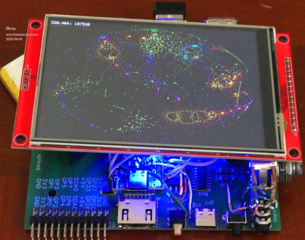

Posted: 08:53am 09 Jun 2025
I'm fine with the 3 suggested options, I don't see any point in continuing to develop the 2040, the 2350 is just as cheap, just as easy to use. I've never had a HDMI problem, driving everything from a HDMI to VGA dongle to an old Dell monitor with only VGA, through a 15 year old Dell monitor with HDMI to a Samsung 40" TV & using a Adafruit HDMI header. If you *really* must have VGA use a HDMI to VGA dongle, they are self powered from the 5v on the HDMI & cost less than £/€/$5 on Ebay. Yes I do still have several 2040 Picomites, which can just continue using 6.02 for the rest of their lives, I'll probably try to upgrade my GameMite to 2350, we'll see how that goes.
As an experiment, I just converted one of Peters original 2350 HDMI references designs to use the new ST7796S LCD, because I didn't have a LCD 2350, it was easy & I gained 2 GPIO pins 26 & 27, which are already brought out to the edge connector, & yes it's significantly faster. On an older LCD using a program that hammers the display it sped up from 496mS per screen update to 378mS per screen update, if I also used screen updates in the background I could get 320mS per screen update, on a HDMI screen the max I can achieve is 220ms per screen update, so not too shabby.
Photos really do not do LCD screens justice, this screen is very bright and clear, if you use font 7 you get 80x38 in the editor or 60x24 with font 1, yes you might need glasses to use Font 7, I do, it's crystal clear.
Regards, Kevin.

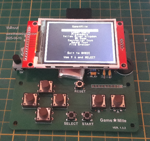

Posted: 02:39pm 09 Jun 2025
  Bleep said  I'll probably try to upgrade my GameMite to 2350, we'll see how that goes.
Hi Kevin,
That works, but you need the "alternate install" from Tom's documentation, and in several of Tom's programs small modifications must be made. (avoid reserved keywords and such). I have a Game*Mite running 2350 with RC25 on it.
I don't know how to create a UF2 file from it's memory, but otherwise I could send you the patched files (or Tom may do this on his Git once 6.00.02 is released)
It is hard to get the old pico off, so I did build (with Toms generous offer for a blank board) a new one. The new one I have a small 500mA lipo between 2350 and LCD, mounted the aux connector top side, and am still looking for a small speaker. So the whole thing is very low profile. Thinking about a housing. And replace the 3 switches (RESET/SETUP/START) with a slightly taller stem.
Edited 2025-06-10 00:45 by Volhout

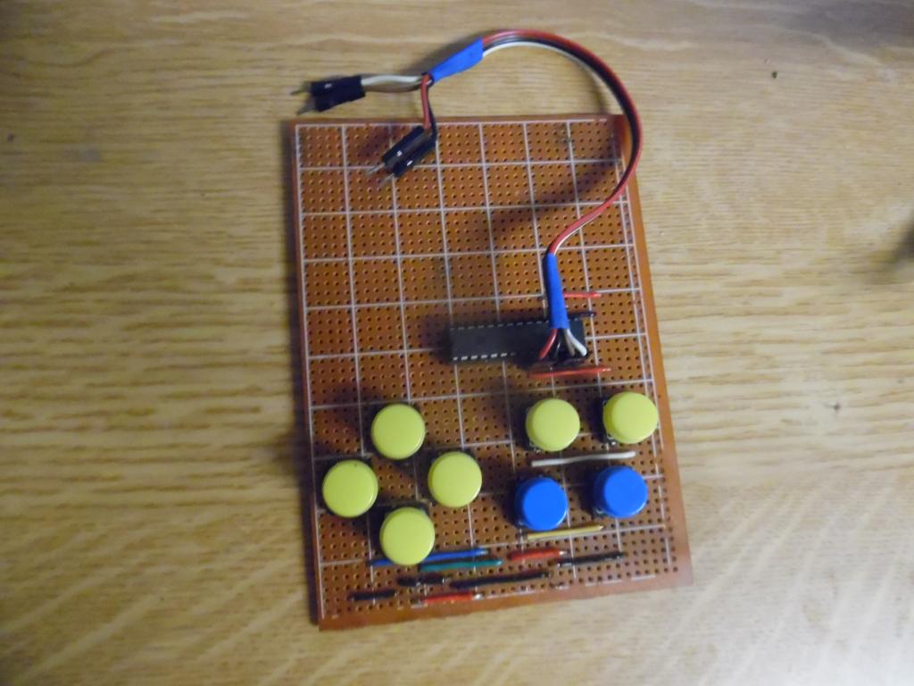

Posts: 2807
Posted: 09:07pm 09 Jun 2025
mcp23017 got told off for using this but it got loads of pins that can be input or out put.
dunno why i2c not more popular as I had this and vlox rangefinder  and oled didplay all going same time
Edited 2025-06-10 07:11 by stanleyella
Hi Kevin,
Hi Harm,
When I get it done, a UF2 dump would be great, but I won't be getting arround to it for a while, I haven't even got a Pico2350 going spare at the moment.
Regards, Kevin.

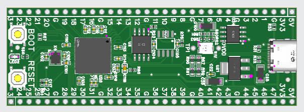

Posts: 12061
Posted: 11:27am 10 Jun 2025
Let's be clear. No-one is saying you can't keep using your old RP2040. 6.00.02 will simply be the last release for functional changes for the RP2040.
Likewise, I won't be making changes to VGA. Why support more colours on VGA when HDMI already does it and, as noted, cheap HDMI to VGA adapters are readily available.
In fact, there will probably be little or no future changes to HDMI either. The functionality is already cpu/bus limited. For, example, why doesn't 800x600 support RGB555? Answer, there simply isn't enough bus bandwidth to feed the HSTX peripheral with the data fast enough and PSRAM is far too slow to be used for anything "real time"
My intention post 6.00.02 will be to focus on the RP2350B PSRAM PicoMite using my DIL module as the standard platform.
I've just ordered another 5 of these from JLC and total cost fully built was USD70 including shipping and taxes (USD51 without) so pretty competitive with commercial alternatives and BETTER (he said humbly)
Using the 64-pin chip with PSRAM opens lots of opportunities for direct coupled LCD displays including SSD1963 etc. Carrier boards can easily be designed to connect the DIL module to the displays and with in-memory framebuffers and PSRAM there are opportunities to do lots of new interesting stuff.
Edited 2025-06-10 21:33 by matherp
