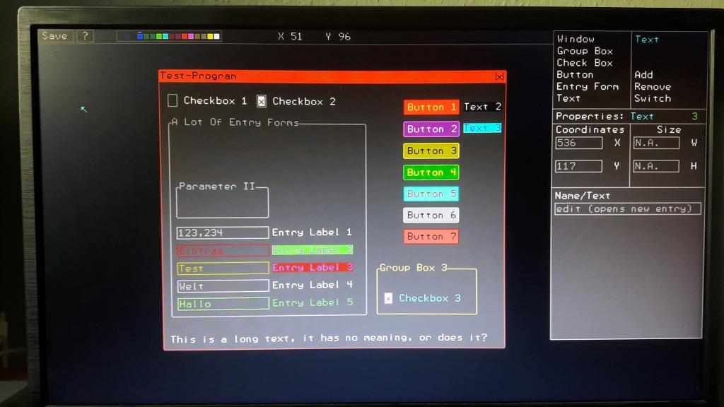

Update:
- Added selection between Numbers only / All Chars (Entry Form)
Now supports these resolutions so more users can test or play with, if they want:
- 848x480 (Widescreen)   <- as seen on the image below
- 720x400 (Widescreen)
- 800x600 4:3
- 640x480 4:3
- small bugfixes
File:
gui_editor_b22a.zip
Greetings
Daniel

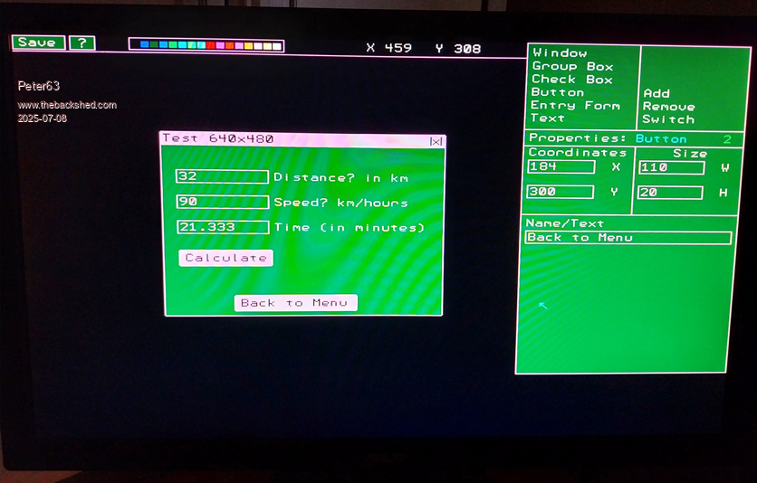

Peter63
Joined: 28/07/2017
Location: Sweden
Posts: 217
Posted: 03:52am 08 Jul 2025
Tested resolution 640x480:
/Peter63

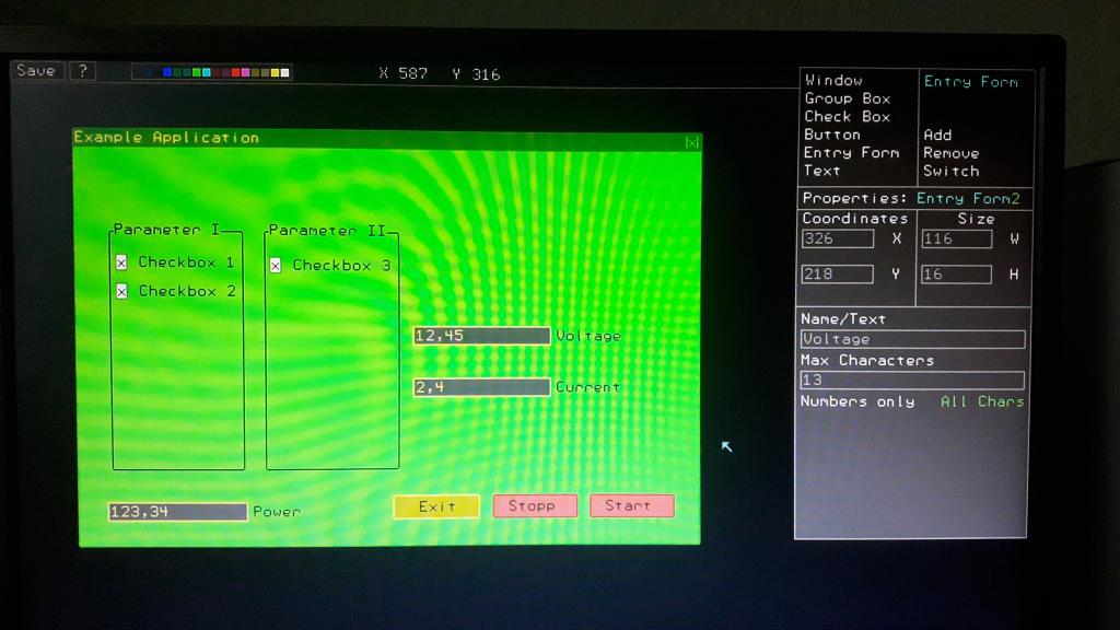

Posted: 10:48pm 08 Jul 2025
Update:
Now everything "basic" is integrated and all is functional...
- Text Item is working now and allows long text line
- Window Item is now completly removable (not everyone wants the window frame!)
- Resolution adjustments and fixes
For the next update, I will finally add the option for more items (of each sort)
current maximum is 3 per item category.
gui_editor_b22a.zip
Greetings
Daniel

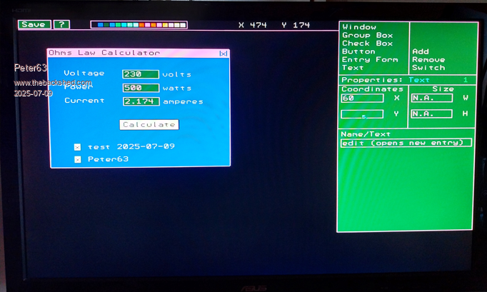

Peter63
Joined: 28/07/2017
Location: Sweden
Posts: 217
Posted: 03:53am 09 Jul 2025
/Peter63

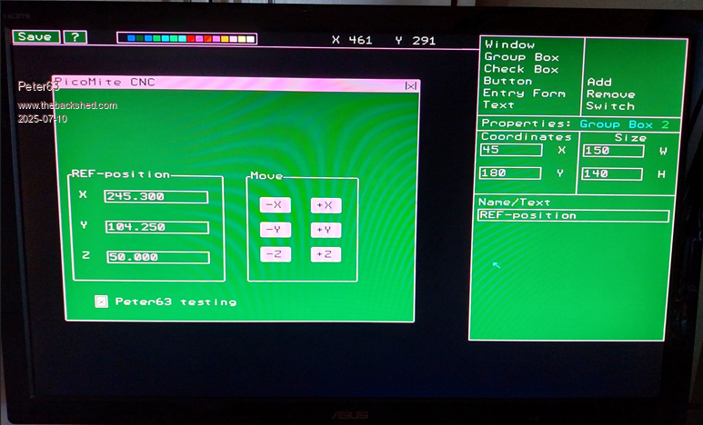

Peter63
Joined: 28/07/2017
Location: Sweden
Posts: 217
Posted: 04:27am 10 Jul 2025
testing...
/Peter63
Amnesie
Joined: 30/06/2020
Posts: 763
Posted: 09:40am 10 Jul 2025
Peter63.
thank you a lot for the testing! It is funny I had the same in mind you are showing in your test with your buttons, but reached the out of memory error. Now this problems is solved with library and I will allow up to 12 buttons, this way you can integrate a complete Numblock 0,1,2,3,4,5,6,7,8,9 and for example ENTER etc.
Dropdown menu would be nice, too. I am trying my best to implement one.
