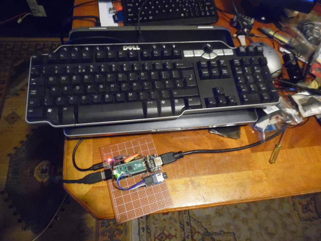

Posts: 2807
Posted: 07:51pm 05 Jul 2025
I not got problems with usb key board, I tried this dell with usb ports and plugged usb mouse in and it showed mouse and kb is fine. using usb a to mini from kb
the keyboard got 2 usb sockets, usb mouse plugged into one
Edited 2025-07-06 06:11 by stanleyella
