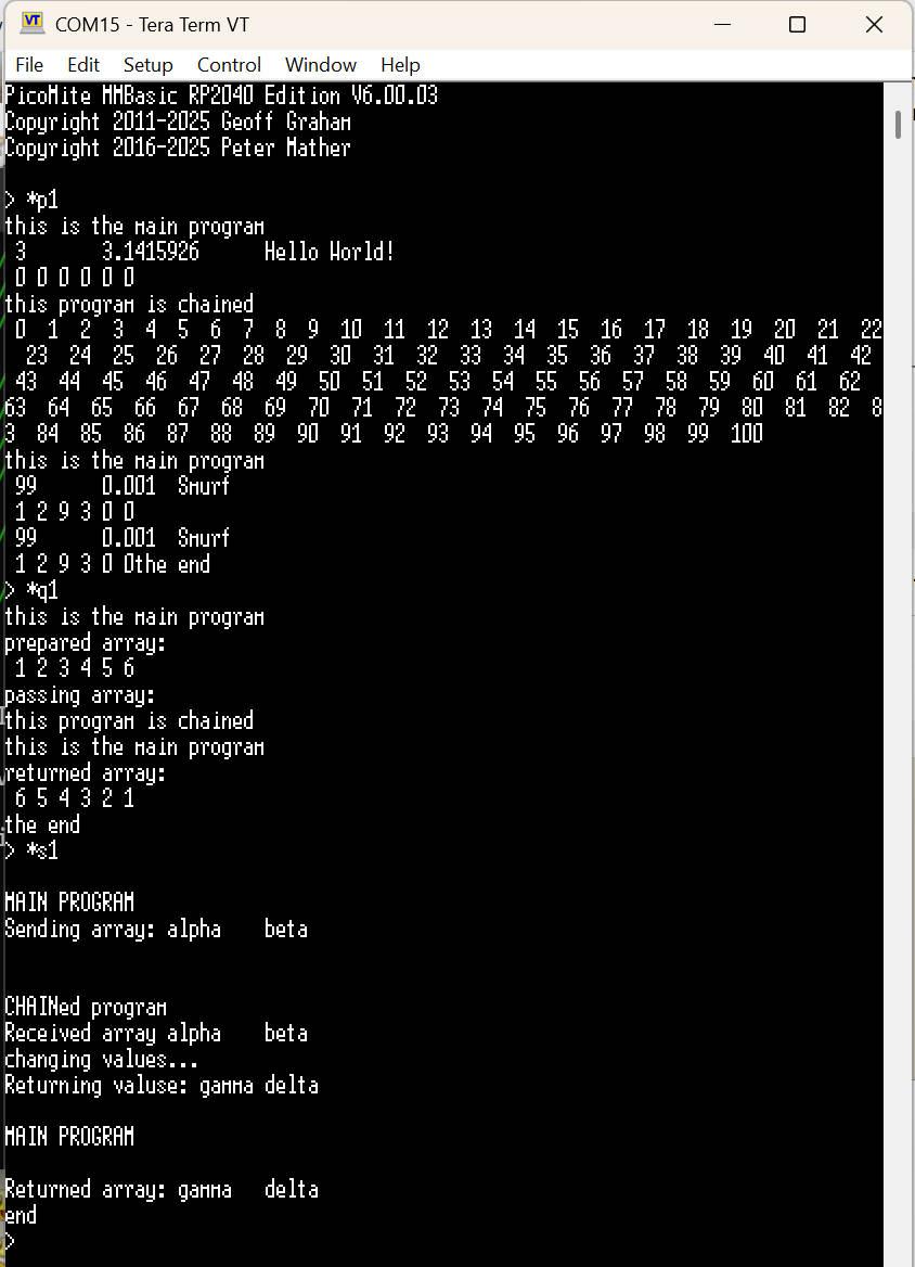

If sending a simple string array it gets chopped off after the first element:
Print
Print "MAIN PROGRAM"
If MM.CMDLINE$ <> "chainret" Then
 Dim a$(1) = ("alpha", "beta")
 Print "Sending array: ";a$(0),a$(1)
 Chain "a:/s2.bas"
EndIf
Print
Print "Returned array: ";
Print a$(0),a$(1)
Print "end"
Print :Print
Print "CHAINed program"
Print "Received array ";
Print a$(0),a$(1)
Print "changing values..."
a$(0) = "gamma"
a$(1) = "delta"
Print "Returning valuse: "a$(0),a$(1)
Chain "a:/s1.bas","chainret"
> RUN
MAIN PROGRAM
Sending array: alpha    beta
CHAINed program
Received array alpha
changing values...
Returning valuse: gamma delta
MAIN PROGRAM
Returned array: gamma
end

Posts: 12060
Posted: 08:55am 12 Jul 2025
This makes no sense. All the code does is copy the entire heap to disk and then restore it. I'm beginning to think it therefore must be a caching issue or similar.
More investigation needed.....

Posts: 12060
Posted: 09:25am 12 Jul 2025
  Quote  With this firmware it only copys the firmware onto the drive of the pico (yes I pressed and hold boot button).
That means it is the rp2040 firmware on the Rp2350 or visa versa.
Check you are using the second zip I posted not the first.
NB: I think I have found a workaround for the CHAIN issue
declare a dummy string which you are not going to use before any other variables
e.g. for Mick's test
Print
dim dummy$
Chain "a:/s2.bas"
EndIf
Print
Print a$(0),a$(1)
Print "end"
Please check this and confirm for me. Assuming all OK I'll try and find a proper fix
Posts: 9241
Posted: 09:56am 12 Jul 2025
That certainly works on my last test. :)
Posts: 12060
Posted: 10:04am 12 Jul 2025
OK: Please try this
PicoMiteV6.00.03.zip
Amnesie: I've checked the PicoMiteRP2040VGAUSBV6.00.03 is definitely correct in this zip
Edited 2025-07-12 20:04 by matherp

Posts: 9241
Posted: 10:39am 12 Jul 2025
Nope, sorry. It still only works on the standard 2040 with dummy$ dimensioned.
This is seriously weird...  There's nothing on this thing. The flash slots are empty and only my test files are on A:. It was a new install from 5.08 when I started playing. I'm only using the console, no display, standard, original Pico.
> option list
PicoMite MMBasic RP2040 Edition V6.00.03
OPTION COLOURCODE ON
OPTION CPUSPEED (KHz) 200000
Posts: 12060
Posted: 10:50am 12 Jul 2025
Just checked - standard RP2040 PicoMite - no options set. Your p1/p2, q1/q2, s1/s2 test programs all work perfectly as posted with the latest firmware. Try downloading again/clear cache etc.
Edited 2025-07-12 20:53 by matherp

Posts: 9241
Posted: 11:21am 12 Jul 2025
Thanks Peter, that was the answer - clear cache. :)
Things are much better now. :)
