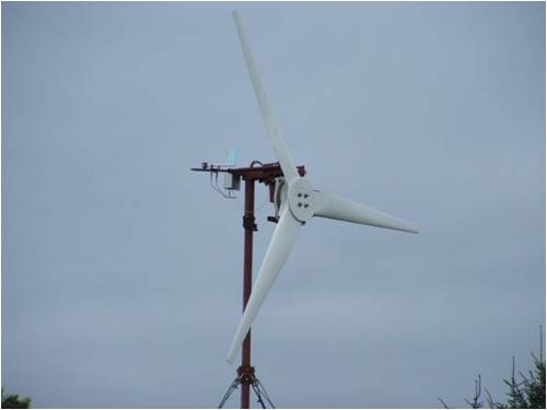

interesting morning...
it was pretty breezy so it let it run a while ,
as i was standing under it a few gusts hit it and it suddenly furled up ...almost horizontal ...scared the absolute wits out of me
very surreal ...if you had a joint and watched it i doubt youd ever recover
the action seemed pretty smooth ..its hard to tell looking over your shoulder
it just seemed to float back down ...after that i shut it down ...when i double check everything i,ll run it again and get a pic..
looks like lots of issues with tracking in low (even medium) winds ...
but worth building it just to see the furl ...
....thinking a bit more about this its strange it went all the way to the upper stop during the highest gust ..at this stage the springs are starting to relax and dont have a big influence Edited by niall1 2009-08-01
niall

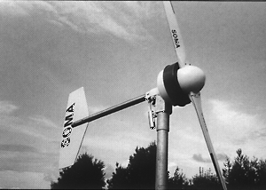

You have reached the most difficult and fun part of the whole project. I would have been thinking... when will the wind blow?...
I have enjoyed reading your post and I look forward to the updates. I have thought about building a downwind turbine for years. I suppose I did have one once. Here's the story on otherpower. http://www.fieldlines.com/story/2006/12/3/18522/2088
I remember the 'downwind' version of my turbine not having the same fast response to wind shifts. I attributed that to balance and not enough tail (blade) surface area to turn it. I thought about flipping the blades around and letting it fly. At the time, it was winter and I needed the lights and heat for my greenhouse, so I repaired it and put it back in the air.
Proven Energy has a vane you can probably adapt to yours if the need arises.
The thought of having a true downwind unit still crops up. I've got to try this design. Thanks for the post!Edited by philb 2009-08-02
philb

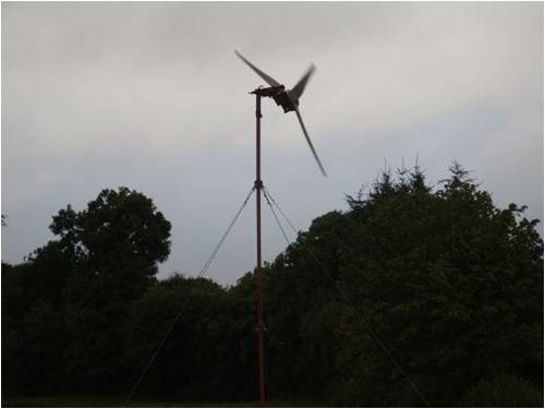

finally got a pic of the furl....its been doing this a good bit all evening ...the frisbee effect is the best way to describe it..
Edited by niall1 2009-08-05
niall

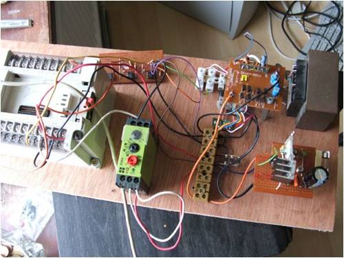

the small up wind vane sends right/left signals back to a plc via a toy car transmitter..even with the dodgy wiring this is working well ,this way i can leave the plc next to the computer
the plc can send signals back the same way to a yaw motor (no ideas yet for the motor ...)..it shouldnt need to be active very often , maybe once every hour and hopefully make a correction (with some feedback from the vane) and then the yaw should lock...if i can rig a motor it could be a lot of fun (not quite so practical though)
ps.......Gordon i did try improving the yaw bearing action (alignment) with a temporary roller bearing at the base of the yaw pipe which made it a lot more responsive to changes in wind direction ..
....the unexpected side effect was the strange rotation during the furl...Edited by niall1 2009-09-23

the precess or sponsored walk around the mast (at least in mine) seems to be a gyro effect ..its always in the one direction
adding a fin MacGyver would help but i think it would need to be big enough so as not to be counter productive ...
my mast is only 3inch pipe but it does leave a small wake , enough to make a small helicopter noise effect, if the fin didnt sit properly into the wind it might leave a very big wake behind it , right up to the blades ...cant be fully sure about this but thats why i,m reluctant to squeeze one in (the small tower offset limits things now)
Rodin the offwind action during braking effect on your mill has similaraties here too...in my case it happens when the mill is close to a stall condition , it gets a
bit peaved , and seems to go offwind a little (but its unpredicable)..
warts and all clip... http://www.youtube.com/watch?v=hWRyLk4H8-s
conta rotating props needed then. ...
because i cant.... play with coning the prop , for now i,ll cheat and stick with the active yaw cause
ps..thinking a lot more about this it seems a bit like flying a kids diamond shaped kite ,both are downwind machines ..
any good kite like this will have a few degrees backsweep on its sides leaving it more stable ..now take the same kite and make it a pure flat diamond shape , chances are it,ll never leave the ground , if it does it,ll have very little idea which direction the wind is coming from and constantly hunt for it ....... Edited by niall1 2009-09-24

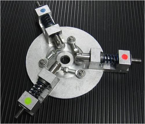

(down wind) furling?
found this pic on the web and wondered if it could be simplified. the hardest part would be getting the spring tensions correct. it looks simple enough, but would it be worth all the trouble of extra bearings, could it be made to work in the weather?
hans
Dinges
Joined: 04/01/2008
Location: Albania
Posts: 510
Posted: 05:58pm 24 Sep 2009
Hans,
I've seen that picture a few weeks ago too; think it was from a commercial site, someone who also converted car alternators to windgenerators?
At the time the site was still heavily under construction; can't for the life of me recall where I saw this, RonB gave me the link. At the time we were having a discussion about it, as I don't see how all three blades would vary pitch at the same time. The way I understood the mechanism, it was possible for each blade to have a different pitch, leading to imbalance and (most likely) self-destruction.
The price of the contraption in your picture was pretty reasonable too, I remember. And should be doable to modify it in such a way that, as with the Jacobs mechanism, all blades will always be set at the same pitch. So, it needs to be 'complified', not simplified, to make it work reliably. At least as I understand it so far. I may be overlooking something though.
Sorry, not really related to this thread, but the first thing that popped into my mind when I saw the picture. Maybe Ron can chime in too if he sees this.
Peter.
