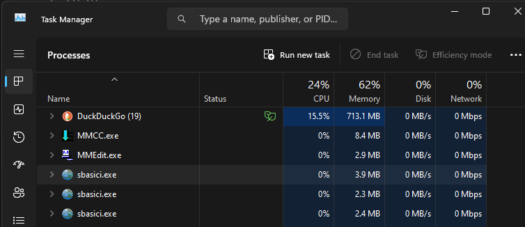

PhenixRising
Joined: 07/11/2023
Posts: 2100
Posted: 12:42pm 02 Sep 2025
Three instances of SmallBASIC talking to PicoMites:
