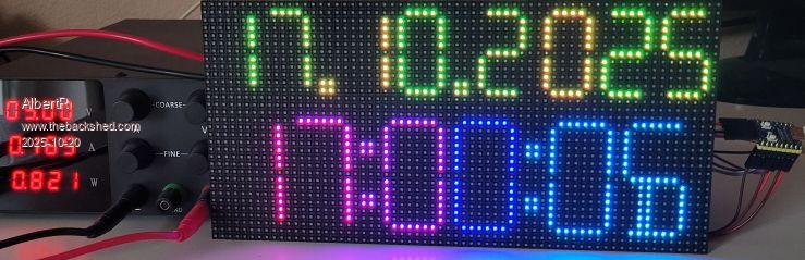

AlbertR
Joined: 29/05/2025
Posts: 111
Posted: 08:11pm 14 Oct 2025
Hi Volhout,
I made a try with Ring-Buffer for the Hub75. For the sync I had to expand the PIO in two parts. When running all is perfect, no flickering no shaking, also the systemspeed increase, because of no interups with no reinit the PIO.
The video shows a RP2040 @48MHz and it works very well.
Hub75TwoPiosRing.zip
But there are some problems after breaking the program (ctrl+c).
First the PIO continue working, the display continues to show last content. That is no great problem. After entering the edit-mode this stops.
But when I start the program again, it hangs up. "MM.Info(PIO TX DMA)" is 1, the PIO TX DMA looks like it is still running. "PIO DMA TX OFF" or "PIO stop 1,0" have no effect.
For an other run the CPU must be resetted !
I am not lucky with this. What am I doing wrong? Has anyone an idea what the problem is?
Albert

Joined: 29/05/2025
Posts: 111
Posted: 08:14pm 19 Oct 2025
Hi Don,
I got the displays and was able to reproduce the error. I tried a few settings with it, but only the Hub75 version with the second state machine fixed the error. Also it reduces flickering so much that an RP2040 can run it at 48 MHz CPU speed.
I once created a program version with it. Just remove the demo outputs at the beginning.
TwoSmMorph.zip

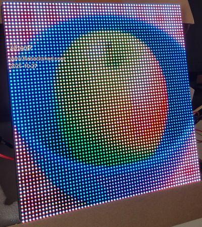

Posted: 04:29pm 26 Oct 2025
Hi all,
I try a new version with 12bit colordepth.
I also add some functional features, text could have a backgroundcolor, also a clearcolor could be used. The Stringbox can use x-offsets.
I still use no CFunctions. Without the PIO all is Basic and hopefully understandable.
By trying the pictures: I'm not sure if dithering is necessary and practical here. There are very few pixels at a resolution of 64x64.
At the moment I use 24bit-bmps, they are very easy to handle. The lower 4bits are removed while loading.
Hub75_12bit.zip
I'm excited to see what you can do with it.
Albert

Uff... Albert,
this is impressive! What is the exact name of the matrix? It seems there are quite some out there, which one do you use? Maybe you have a link for me? I would like to buy one.
Greetings
Daniel
AlbertR
Joined: 29/05/2025
Posts: 111
Posted: 06:59pm 26 Oct 2025
Hi Amnesie,
I think it is the cheapest 64x64 pixel-display on Aliexpress(with shipping costs).
P3Matrix64x64
