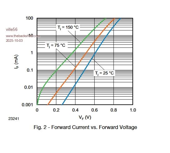

ville56
Joined: 08/06/2022
Location: Austria
Posts: 646
Posted: 09:02am 03 Oct 2025
If you look at the datasheet of the 1N4148, I think you will need some more diodes to get the voltage drop you want at this low current and you are a bit dependent on the temperature. So your milage may vary ....
73 de OE1HGA, Gerald
Posts: 6197
Posted: 09:13am 03 Oct 2025
Maybe use a resistor voltage divider in stead of diodes.
For the lithium cell battery, to determine the charge level from the battery voltage you need to measure very accurate (milivolt accuracy) and even temperature data.
Silicon diodes forward voltage changes 2mV per degree kelvin (Celcius). 3 diodes in series = 6mV/C. You can only measure milivolt accurate on the voltage level when you keep the battery circuit within 0.16 degrees C... Big NONO.
You need a resistor divider.
P.S. It can be done with diodes as well, but that requires a lot of engineering where you use and NTC or PTC and a selected set of accurate resistors that change the current through the diodes depending on the temperature. Basically compensating for the 6mV/C by changing the forward voltage. Don't go that way. It has been done by companies like HP where they needed to compensate of forward voltage drop in an old RF detector probe. Too much hassle.

Posts: 9238
Posted: 09:36am 03 Oct 2025
A silicon diode is a great way to measure temperature because the Vf-temperature slope has quite a good repeat accuracy over a sensible range. So, never use them where temperature change may be an issue. :)
I don't like measuring the voltage of a lithium cell to determine it's remaining capacity. It tells lies. You really need to log the charge into the cell and the load current from it. Without doing that anything else is pretty much a guess. The capacity varies with temperature and load current. Also, the difference in terminal voltage between half remaining and unusable is very small as you are very close to the knee point of the discharge curve.
