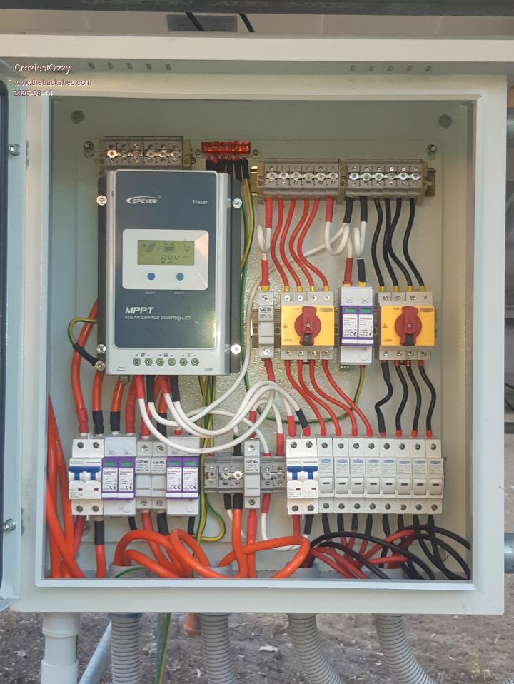

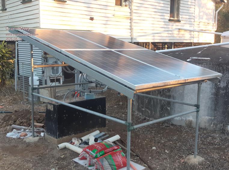

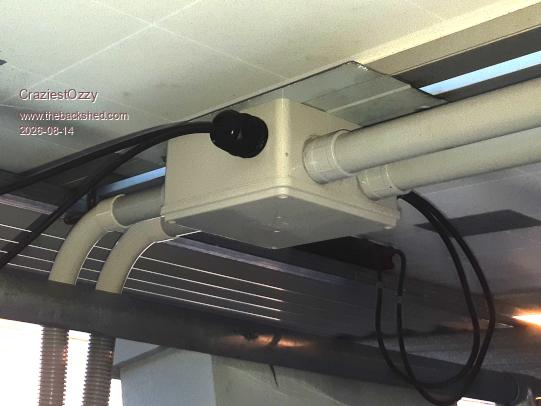

This is an update showing the progress and changes made since the start of this project:
Changed the 12v panels to 24v panels.
Redesigned the framework from a horizontal panel to an angled panel that points panel surface better to the sun in Winter and to support the larger 24v panels.

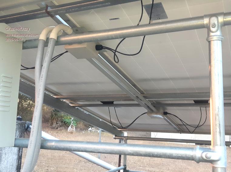

Cut off al MC4 connectors and enclosed the rewired connections inside junction boxes.

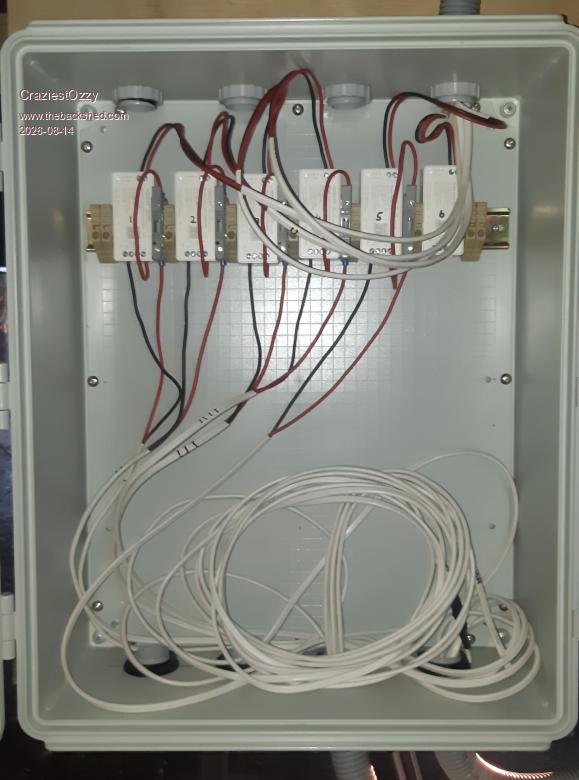

Added another ABS plastic electrical box, to enclose all the WiFi remote controllers for the lights.

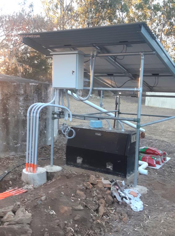

Repositioned the solar electrical box to under the solar panels, with a corrugated iron sheet overhead to protect box from rain.
Junction boxes under panels, hold the wiring that connects the panels to electrical box.
Conduit protects the soft silicon insulated wiring running from junction boxes to electrical box. Yet to secure the black cables from panels.
The revised frame structure, additional underground conduit for future expansion.
Trench is shallow, due to all those bloody rocks.
I will add some 45 degree diagonal bracing to the vertical supports before the storm season. Sand filled bags ready to fill in the underground cable run.
Completed main electrical box. MPPT controller raised so the wiring behind the controller does not impede the heat sink. Negative/Positive inputs from solar panels all have ceramic sand filled fuses.

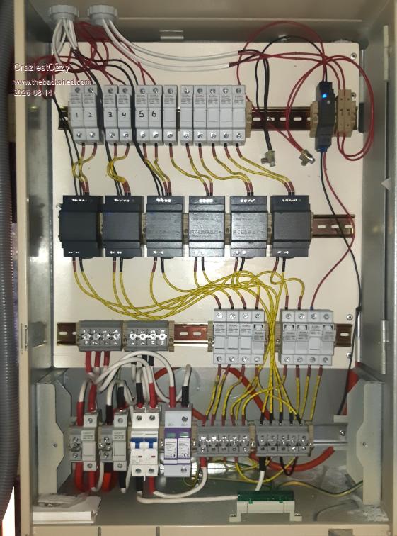

The electrical box under the house, with the DC/DC isolated controllers, fuses and switches.
Have had to include an additional SPD (coloured purple) as the underground cable run is over 10m.
Top right is a new addition, a 24v/12v isolated converter to run touch/dim lights under kitchen cabinets.
ABS plastic box under house, has the WiFi light controller. Each controller output controls one light and has a din rail fuse next to it valued to 500ma.
Lights inside the house do not require wired wall switches as controlled remotely here.
Yet to tidy the wiring and add another two din rails.
