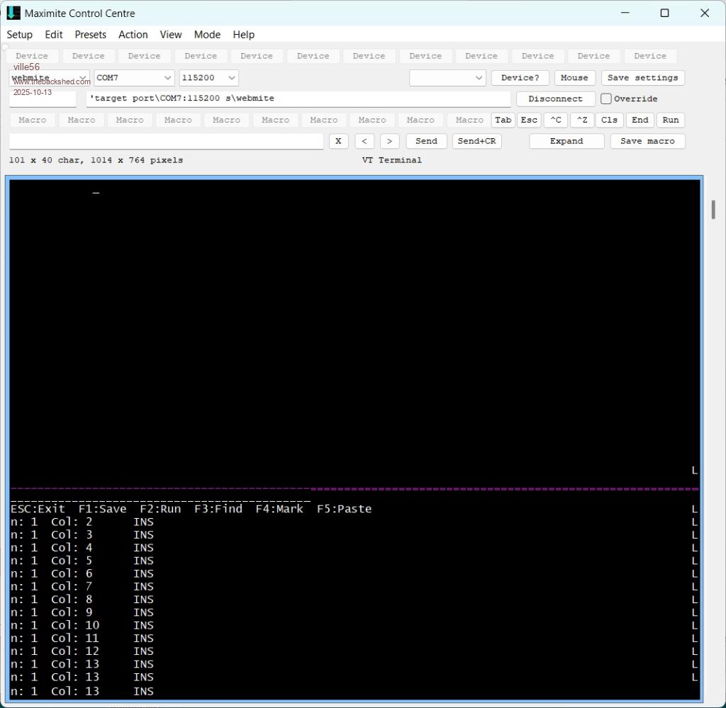

Posted: 02:23pm 12 Oct 2025
with RP2350 webmite I get the following screen when using "EDIT" ....
for each character I type in, I get an additional line at the bottom.

  Quote  for each character I type in, I get an additional line at the bottom.
Try setting MMCC display to match the 'mite 145 x 45
