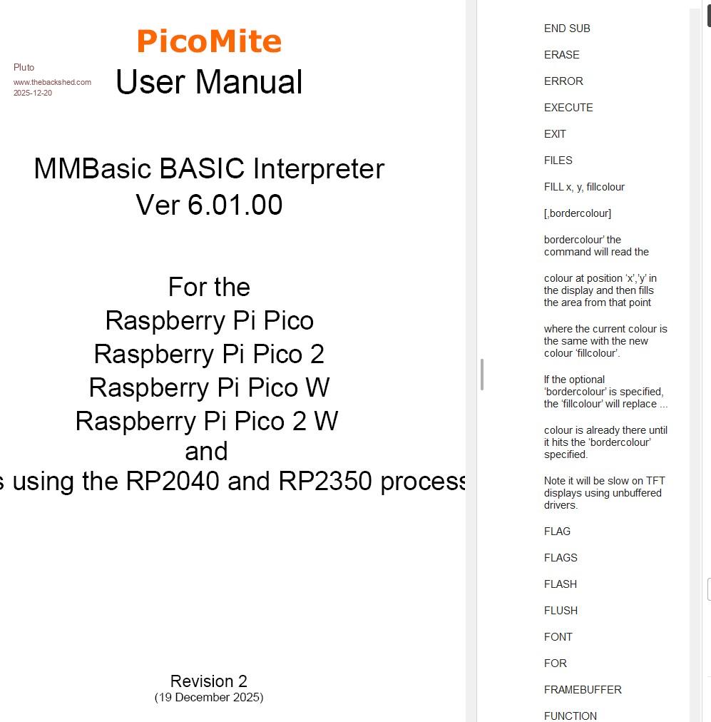

  Pluto said  Command list also corrupted in my user manual. Dated/downloaded 16.12.2025.

Posted: 05:54pm 19 Dec 2025
This is what I see:
Maybe something wrong with my pdf-reader? Updated Adobe, but the "corruption" persists.
Posts: 12058
Posted: 06:38pm 19 Dec 2025
Confirmed there is a buglet in the doc. Some content is being picked up in the contents list - Revision 2

The firmware download now has an updated version of the manual (revision 3) which fixes the bookmarks, but the major change is the inclusion of the MATH SINC command.
Quick link to the updated manual:  https://geoffg.net/Downloads/picomite/PicoMite_User_Manual.pdf

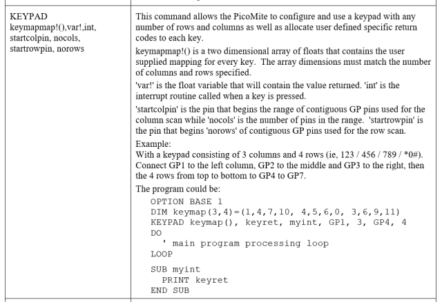

I'm missing some commands and functions in the manual. (program)
They're included in the "The 3D Engine" PDF, but not in the program function list. Draw3D(
Is it present in the command list, but not in the manual? Stepper (there is a separate Stepper PDF). Is it better to have it in the manual?
In the "Advanced Graphics Functions" PDF, I also see the following functions: CLICK(DOWN), CLICK(UP), CLICK(LASTX), CLICK(LASTY), CLICK(REF), CLICK(LASTREF), and PAGE, but they might not work in PicoMite Basic? (Page = GUI Page?)
In the manual on page 132, in the example for KEYPAD, the values ​​of the numbers are not all correct. Compare this with the following:
KEYPAD keymapmap!(), var!, int, startcolpin, nocols, startrowpin, norows
So, for example, if I have a keypad with 3 columns and 4 rows: 123 / 456 / 789 / *0#
And I wire gp1 to the left column, gp2 to the middle, and gp3 to the right, then the 4 rows from top to bottom to gp4 to gp7
My program could be:
GP 1 2 3
4  1 2 3
5  4 5 6
6  7 8 9
7  * 0 #
Option base 1     ' columns   columns  columns
Dim keymap(3, 4) = (1,4,7,10, 2,5,8,0, 3,6,9,11)
Keypad keymap(), keyret, myint, gp1, 3, gp4, 4
Sub myint
 Print keyret
End Sub

Posts: 3369
Posted: 12:51am 21 Dec 2025
Jan,
I'm not sure what to do with commands that are documented in separate PDFs.  Some times they are repeated in the main manual, sometimes not.  This should be consistent and I will have a look at it.
I agree, the KEYPAD command is a mess.  Below is my attempt to rewrite it and fix the example program but it needs checking.  Peter?
Geoff

Posts: 3416
Posted: 01:01am 21 Dec 2025
On RP2040, latest firmware update.
> LIST
Option base 1
Dim float keyret
Dim float keymap(3,4) = (1,4,7,10, 2,5,8,0, 3,6,9,11)
 ' main processing loop
Sub myint
  Print keyret
End Sub
End
RUN
[4] Keypad keymap(), keyret, myint, gp1, 3, gp4, 4
Error : Invalid syntax
The original format works as per the manual.
Replacing the above code gives the expected result.
Option base 0
Dim keyret
'Standard 4x4 keypad layout 1,2,3,A - 4,5,6,B - 7,8,9,C - *,0,#,D
Dim keymap$(23) = ("0","1","2","3","4","5","6","7","8","9","*","#","","","","","","","","","A","B","C","D")
' HEX 4x4 keypad layout 0,1,2,3 - 4,5,6,7 - 8,9,A,B - C,D,E,F
'Dim keymap$(23) = ("D","0","1","2","4","5","6","8","9","A","C","E","","","","","","","","","3","7","B","F")
'or for integer HEX value
'Dim integer keymap(23) = (13,0,1,2,4,5,6,8,9,10,12,14,0,0,0,0,0,0,0,0,3,7,11,15)
Keypad keyret, keyint, gp0,gp1, gp2, gp3, gp4, gp5, gp6, gp7
Sub keyint
  Print keyret, keymap$(keyret)
End Sub
End
It appears the new syntax isn't in the firmware.
Edit.
See "PicoMite Firmware Release Version 6.01.00" thread.
Keypad keymap(),... is a RP2350 command only.
Manual to be updated on pages 59 (Special Devices - Keypad Interface) and 132 (Commands).
