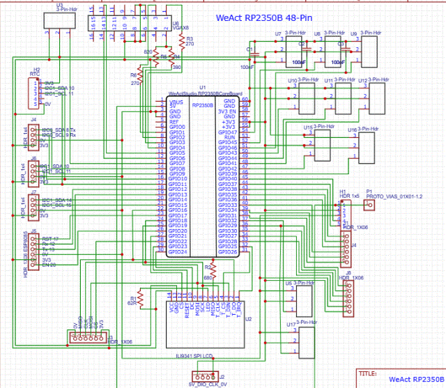

Ok, here's my first pass at a PCB for this module: $6.15 for 5 from JLCPCB, including shipping and sales tax, no tariff mentioned.
It may well need a V2 (and V3). Gerbers, zipped EasyEDA, & module files attached.
It uses an LCD (ILI9341 or ILI9488), a 5-pin RTC module, an SD module, an ESP8285 module, and optionally a VGA connector module. Provision is made for a 4-channel relay module to be plugged in.
I don't know which pin is used to address PSRAM.

Can I ask why on the external connector pins you always put 0 and 3.3V next to each other?
Not a criticism, just curious because I always thought it best to seperate them, that avoids accidental shorts

On the 3-pin connectors I put 3V3 in the center to prevent reversing of V+ and 0V. On the connectors with more pins, I find that often what I want to plug in has them next to each other (those 1-, 2-, 4-, 6-, 8-channel relay modules). The RTC module has them on opposite ends, so you really don't want to plug it in backwards with the battery on it.
The 37-sensor kits typically have data in the center, so YMMV.

PSRAM select is on GP0. It is linked via R14 (zero ohm link) so it could probably be changed with careful soldering. There are only 5 possible pins that can be used. I would suggest leaving it as it is.
Circuit diagram is Here. Interesting that it uses a crystal rather than a clock module. The regulator is linear.

Thanks for that. GP0 is the only pin I left unconnected (I think), because I had a vague recollection that it was used for something onboard.
Thanks also for the link to the schematic.

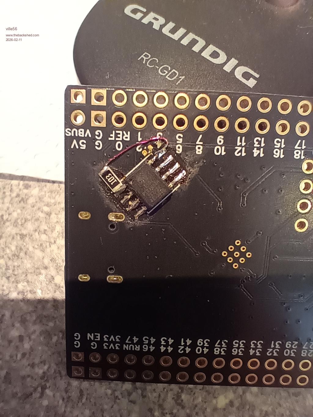

If you add the PSRAM, don't forget to also add the pullup for the CS signal. Otherwise you will get unpredictive behavior. I'll post a picture of my module with the pullup if you like.
Gerald
73 de OE1HGA, Gerald
Posts: 3885
Posted: 07:32pm 10 Feb 2026
Ah, I had missed that wrinkle. Please do post a pic.

Posted: 08:40am 11 Feb 2026
I did use 10k as pullup, but any other value bt 1k and 10k should do

Whether you need the pullup on PSRAM_CS is questionable, unless you find that it won't work without. It only does anything while the RP2350 is booting. Once that is over the QSPI select pin is probably driven high or low in the usual totem pole mosfet way. You definitely need it if you are going to run with the PSRAM connected and with the CS output pin floating though. Winbond don't actually specify a pullup, they only say that one can be used.

I own two of this modules with retrofitted PSRAM. From my experiance, for reliable operation, it is absolutely necessary to have the pullups. Reason: after flashing a new firmware the PSRAM pin is usually floating (equal to option psram disable) thus booting up in this virgin state is not reliable if successful at all. Once you get "option psram pin gpxx" to work, I did not see much problems except a few occasional boot failures (hangs). Also if you look at the schematics from WeAct for the modules, they have a pullup provided for CS of the PSRAM.

You're right. It's always a good idea to pull CS signals in the "disable" direction so that they have to be deliberately enabled.
