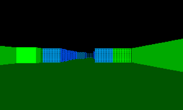

Martin H.
Joined: 04/06/2022
Posts: 1573
Posted: 05:52pm 14 Feb 2026
I have optimised this a little to keep the calculations within the DDA loop as low as possible.

I have revised the map again. Now you get different values when you hit a wall. Here, I have planned to colour different areas differently (as in Wolf3d), which should help with orientation. The value found is stored in 'cll' but not yet evaluated.
Have Fun
Martin

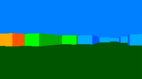

Martin H.
Joined: 04/06/2022
Posts: 1573
Posted: 12:08pm 16 Feb 2026
Addendum: I have adjusted the above listing. Different colours for areas are now taken into account by the programme.

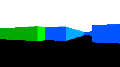

Posts: 6195
Posted: 01:25pm 16 Feb 2026
Hi Martin,
You may need a small fix. The use of floor and ceiling color is essential for the program to run. If I change them to rgb(black) and rgb(white) I cannot navigate anymore.
Martin H.
Joined: 04/06/2022
Posts: 1573
Posted: 01:45pm 16 Feb 2026
  Volhout said  Hi Martin,
 Well, I don't understand that, because
colSky = RGB(White)
colFloor = RGB(Black)

This is really nice, many thanks for sharing!
I've tested it with an ILI9341 LCD and it runs fast and smooth.

@dddns Thanks for the feedback. I don't have an LCD Pico myself at the moment, but it's good to hear that it works there too.
Here I have further optimised the routines and now pre-calculate the angles in lookup tables.
On an RP2040 @225, image rendering now takes 40-85 ms.
I don't see any further optimisation possibilities at this time.
If you can think of any further optimisation possibilities, please let me know.

The next thing I will try is to replace the box commands with Blit to save a few ms.
Additionally, it would be possible to draw the depth darker using dithering.
Martin

Because it's Sunday. Version 0.86, some calculations have been sped up again, and it is now possible with the dither%-switch to darken the walls depending on
'the distance (selectable dithering).
Everyone is free to use and improve the routines.
