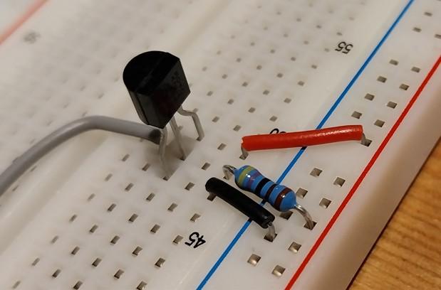

Peter63
Joined: 28/07/2017
Location: Sweden
Posts: 217
Posted: 02:31pm 25 May 2026
Hello, Phil99
Have connected a DS18S20 (Power mode parasitic)
I have about: 25 degrees in the room, but get 69.8125 from the routine.
Do you have any ideas why?
/Peter63

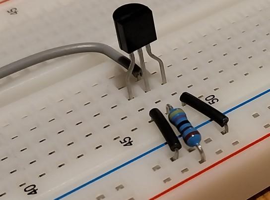

Posts: 2552
Posted: 03:30pm 25 May 2026
try not using parasitic/phantom power; connect the Vdd pin to 3v3. also, are you sure that resistor you are using is not 470 ohms? the fourth band should be brown, while in your photo it looks closer to black.
rob   :-)
Peter63
Joined: 28/07/2017
Location: Sweden
Posts: 217
Posted: 05:25pm 25 May 2026
I have connected the DS18S20 with external power supply.
But I also had to change a little in the program code to make it work.
Attaching the new version here...

  Quote   are you sure that resistor you are using is not 470 ohms? the fourth band should be brown, while in your photo it looks closer to black.
Jepp, 4.7Kohms
/Peter63

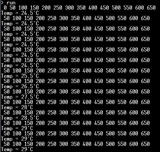

Posts: 3416
Posted: 06:10am 26 May 2026
Glad you got the function working.
I forgot to mention parasitic powering was omitted to keep it simple, my apologies.
I see you had to revert to Jim's "Case 16" code to get the right result. I attempted to reduce the number of lines but will have to rethink that.

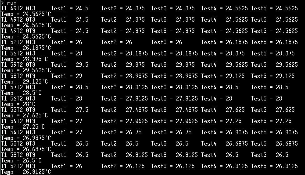

Posts: 3416
Posted: 06:42am 28 May 2026
A dreary day, so playing indoors. Had a go at condensing the Function.
Using the example data in the datasheet I am reasonably confident this will give 0.5°C resolution correctly with a real DS18S20, but the method for extending the resolution to 1/16° shown in the datasheet looks strange to me and there is no example data given for that.
If you have the time and inclination could you test this?
At the end of the Function there are 7 decoding versions.
1) 1/2 degree resolution - this should work
2) 1/16 degree resolution - using the equation in the data sheet, might work.
3) Same as above for positive temps. but if negative temps are wrong it might be better.
The test is:- does the part after the decimal point increment / decrement smoothly with a slowly changing temperature? If it jumps about I have got it wrong again.
A check below zero would also be good. Something from the freezer touching the sensor perhaps.
4) to 7) If that doesn't work try these.

Peter63
Joined: 28/07/2017
Location: Sweden
Posts: 217
Posted: 01:52pm 28 May 2026
I have tested the new version, this is what comes back as a response.
> run
Data Output - T1 48     T2 0    T3 15
6144
Data Output - T1 48     T2 0    T3 14
6144
6144
6144
6144
6144
6144
Data Output - T1 48     T2 0    T3 13
6144
6144
At the time of testing, I have 24 degrees in the room.
/Peter63

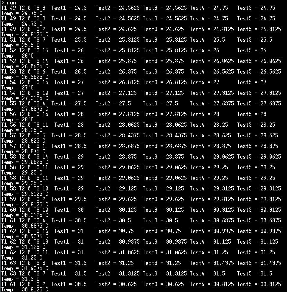

Peter63
Joined: 28/07/2017
Location: Sweden
Posts: 217
Posted: 02:15pm 28 May 2026
Tested all variants:

Peter63
Joined: 28/07/2017
Location: Sweden
Posts: 217
Posted: 06:03pm 28 May 2026
Have also tested DS18B20, works OK. (Got 2 in the mail yesterday.)
Print tempr(GP2)
gave answer 24.75, which matches the temperature in the room.
Using: PicoMiteHDMI MMBasic USB RP2350A Edition V6.03.00RC12
/Peter63

Another test version, from your data was able to eliminate 2 versions of getting the decimal part.
Removed the unnecessary variables by recycling T3.
This one prints the tests of all 5 versions in each run to save time.
Could you please run it while touching the top of the DS18S20 so it's temperature rises slowly by about 2°C. From that I should be able to eliminate a few more versions.

Peter63
Joined: 28/07/2017
Location: Sweden
Posts: 217
Posted: 11:14am 29 May 2026
Tested the new function, it gave this out:
Then I tested the other program:
And finally I tested the last program:
Seems like it works...
/Peter63

Posts: 3416
Posted: 01:52pm 29 May 2026
There are a lot of gaps in the test data, a slower rate if increase or decrease would be needed to fill them. Plus the T3 values.
However I think this is the most likely high res. output line for the first program:-
DS18S20 = Str2bin(int16,Chr$(T1)+Chr$(T2))\2 -0.25 + (16 - T3)/16
And this for the second:-
Value = Str2bin(int16,Chr$(T1)+Chr$(T2))\2 -0.25 + (16 - T3)/16
After all that this is as per the datasheet.
I had imagined the high res data would simply add the fractional part to the low res value.
But instead it appears the high res goes from 1/2° below the low res value to 1/2° above the low res value, with T3 going backwards from 20 to 4.
Peter63
Joined: 28/07/2017
Location: Sweden
Posts: 217
Posted: 03:46pm 29 May 2026
here comes a new run with T3 values...
/Peter63
