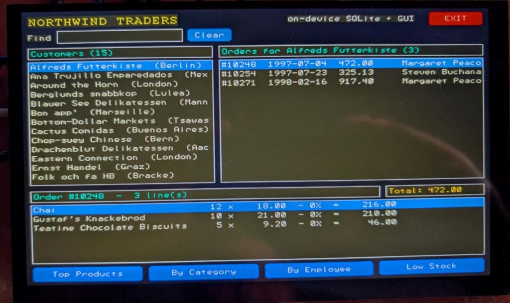

   On-device SQLite — import usqlite — a full SQLite 3.47 database engine is now built into the firmware. usqlite.connect("/data.db") gives you real SQL — tables, indexes, transactions, parameterised queries and cursors — with the database an ordinary file on the flash disk (/) or SD card (/sd) that survives a power-cycle. SQLite runs in the board's 8 MB PSRAM heap, so non-trivial queries are practical. Hardware-tested (create/insert/select, REAL round-trip, persistence across reconnect). The PC emulator has it too, so import usqlite behaves identically there. See User Manual §17.
Simple test program for sql

Posts: 12051
Posted: 09:46am 23 Jul 2026
  Quote  I can smell a SQLite
Might be

lizby: this has been tested with your test program and works perfectly both with the emulator and the real firmware (both flash and sd)
