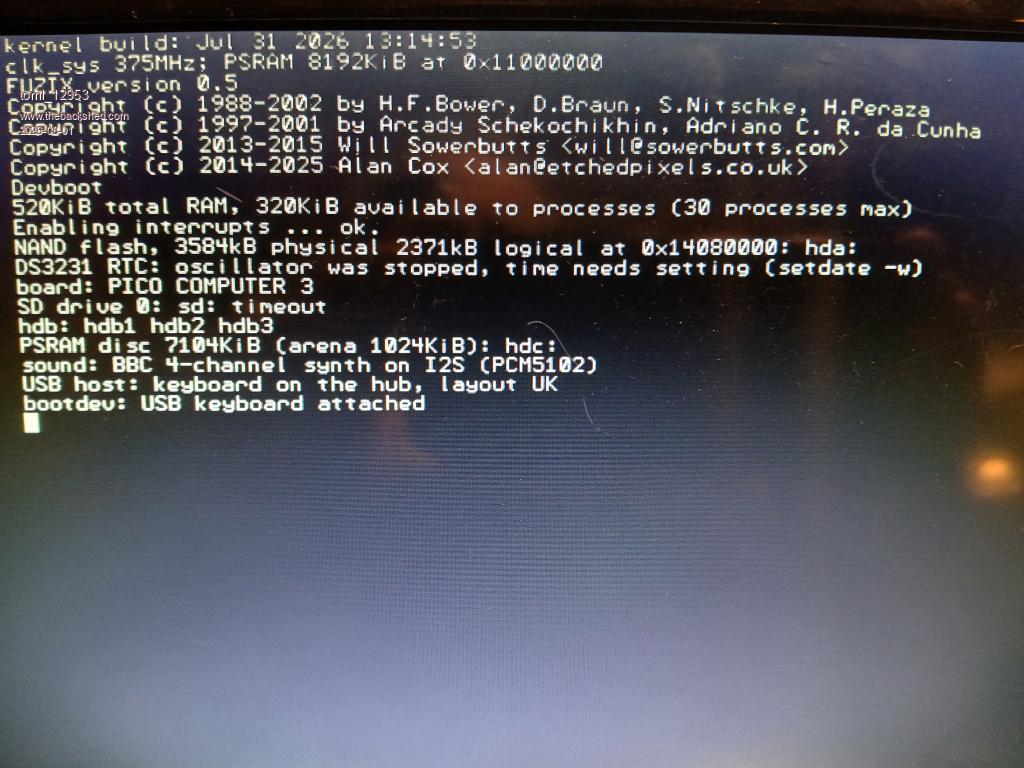

I'm trying to run 0.3 of FUZIX. This is all I get. The machine goes no further.
Posts: 11779
Posted: 06:55am 01 Aug 2026
select the boot device which is hdb2. i.e. type hdb2

Now all I get is
Starting /init
then nothing. It's been over half an hour.
Does a larger SD card take longer? I'm using a 1TB card imaged with your card image
The first partition is formatted DOS16.
Posts: 11779
Posted: 12:28pm 01 Aug 2026
Download and flash the new v0.4. Do the sdcard image first and insert in the PC3, then flash the new kernel. At the bootsel: prompt type hdb2<cr>

  matherp said  Download and flash the new v0.4. Do the sdcard image first and insert in the PC3, then flash the new kernel. At the bootsel: prompt type hdb2<cr>
That should get you to the login prompt - type root and you should be in. Remember to always shut the system down before turning off (shutdown). This is a unix system and the filesystem need to be closed properly.
Probably easiest to work from teraterm first and then try the USB keyboard
I did the steps exactly. It still hangs at Starting /init. Maybe my Pico Computer 3 is bad. I gave the others away so I can't swap it out to check.
bootdev:  hdb2 hdb3
bootdev: c 7104KiB (arena 1024KiB): hdc:
bootdev: C 4-channel synth on I2S (PCM5102)
bootdev:  keyboard on the hub, layout UK
bootdev: hdb2
Mounting root fs (root_dev=18, ro): OK
Starting /init
Edited 2026-08-02 05:47 by toml_12953

  matherp said  sounds like you aren't creating a valid sd image, what are you using
I tried both Raspberry Pi Imager and balenaEtcher
I did make it work, however. Instead of the 1TB card, I tried a 256GB card and now have the login: prompt and can use FUZIX. You might want to include the way to exit BBCBASIC in your manual, though. rebooting causes all sorts of errors on the SD card.
The way to cleanly exit BBCBASIC is
*BYE
I didn't see that in the FUZIX manual.
