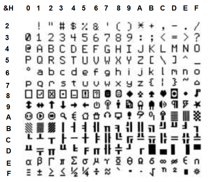

Posts: 3361
Posted: 10:39pm 06 Aug 2026
That link
https://www.thebackshed.com/forum/uploads/JanVolk/2026-08-07_082405_FONT%20#1%20en%20FONT%20#4.pdf
doesn't work in my browser, but this does:-
https://www.thebackshed.com/forum/uploads/JanVolk/2026-08-07_082405_FONT%20%231%20en%20FONT%20%234.pdf
Edit.
The advantage of Hex is there is no mental arithmetic needed.
> ? chr$(&h41), chr$(&h51), chr$(&h3F), chr$(&h23)
A       Q       ?       #
Just pick the row then column.
Jan's link
Curioser and Curioser, in Jan's original link "#" symbols have replaced "23" in the correct link.
Looking at the ASCII chart with Hex values shows &H23 = #  !!!!!!
Jan's uploads are at https://www.thebackshed.com/forum/uploads/JanVolk/
Scroll to the bottom of the list and you can see the uploads were successful but the clickable link was created incorrectly.
Edited 2026-08-07 10:06 by phil99

  Quote  Just pick the row then column.
So ≤ = &hF3 and ? = &h3F.
Posts: 9081
Posted: 12:35pm 07 Aug 2026
&h30 is "0". The pattern follows along the numbers row until &h39 is "9".
Sometimes it's easier to see the ASCII table in binary where a certain bit changes a mode. e,g, setting bit 2 makes a capital into lower case.

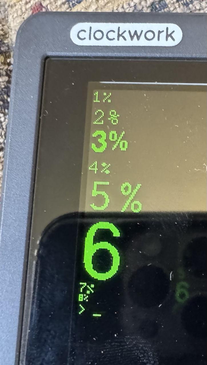

OK, this is one of those bugs that makes me think I'm just too pissed for mere words...
In Font 7 (and only Font 7) the percent sign ("%") is backwards!
Appears on PicoCalc ST7365P and the SSD1306I2C
(On mature consideration, maybe don't change it   )
Posts: 3361
Posted: 02:00am 08 Aug 2026
Also on PicoMiteVGA MMBasic RP2350A Edition V6.03.01 so probably has always been that way on all versions.

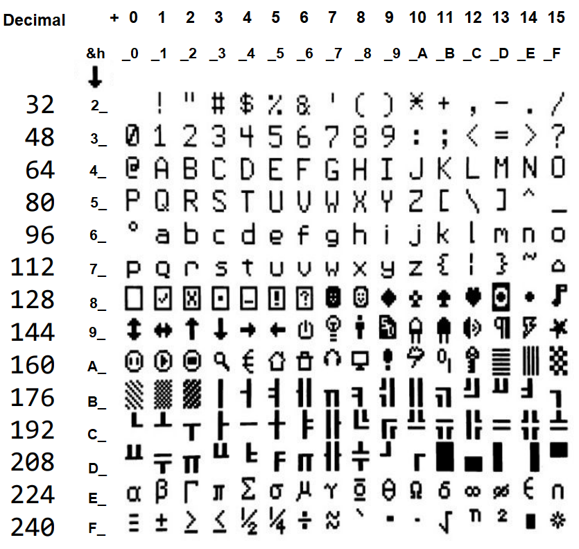

ekaL moT
Posts: 3361
Posted: 03:49am 08 Aug 2026
A less ambiguous version.  :)

  Quote  Would something like this do?
  Quote  A less ambiguous version.  :)
Thanks Phil
BarryH
JanVolk
Joined: 28/01/2023
Posts: 406
Posted: 04:10pm 08 Aug 2026
phil99,
Thank you. Even better for the PicoMite manual.
Jan.

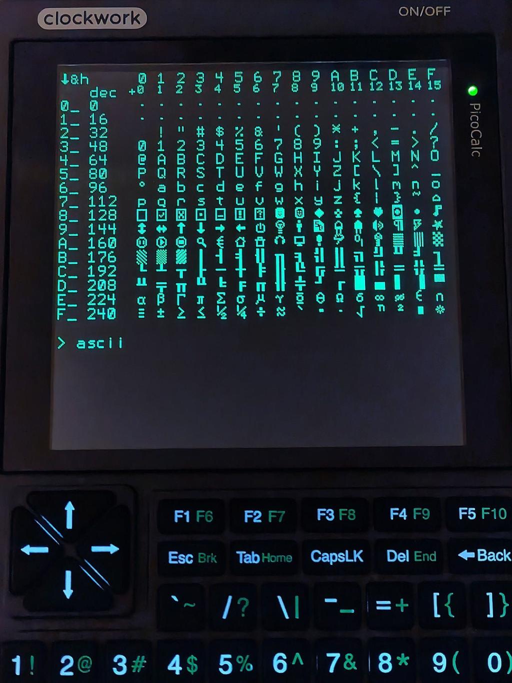

  phil99 said  A less ambiguous version.  :)
and for the library ;-)
Matthias
ascii
Sub ascii
Print Chr$(27)+"[2J"+Chr$(27)+"[H"
CLS
Font 1
locate 1,1
Print Chr$(147);"&h"
locate 2,4
Print "dec"
locate 2,8
Print "+"
For i=0 To 16
 For j=1 To 16
   c=(i-1)*16+j-1
   If c Mod 16 = 0 And c>=0 Then
     locate i+2,1
     If i>10 Then Print Chr$(54+i); Else Print Chr$(47+i);
     Print "_"
     locate i+2,3
     Print c;""
   End If
   locate i+2,j*2+7
   If c<32 Then
     If c>=0 Then
       Print Chr$(&hfa) '"."
     Else
       locate i+1,j*2+7
       If j>10 Then Print Chr$(54+j) Else Print Chr$(47+j)
       locate i+2,j*2+7
       Font 7
       Print Str$(j-1)
       Font 1
     EndIf
   Else
     Print Chr$(c)
   End If
 Next
Next
locate 20,1
End Sub
Sub locate(r,c) 'row,column
 Print @(MM.FONTWIDTH*(c-1),MM.FONTHEIGHT*(r-1));
End Sub
Edit: Print Chr$(27)+"[2J"+Chr$(27)+"[H" 'clear terminal
Edited 2026-08-10 00:34 by homa
