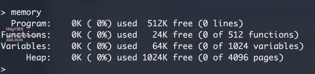

that is right. meanwhile i tried my programm on my pico computer 3.
dim a(781250) is no problem. the memory is filled at 96%.
perhaps it depends on the memory? mmb4m shows not so much memory.
or it depends on the DOS fork...
pico computer 3 (6mb psram)
mmb4m

I'm currently researching the respective limits, but I can't say for certain whether they are accurate. As Thomas mentioned, MMB4L, and therefore MMB4M, is based on  MicroMite / MMBasic for DOS code, which is why those limits apply.
My current plan is to use the limits of the Windows version. What's still open is whether the simulate parameter should also use the limits of the respective hardware. I need to check how much effort that would take. It would require an extension so that RP2040 and PSRAM can be distinguished there as well. The advantage is that the limits would be "comparable". Since the internal structures in MMB4x differ, though, this would only be an approximation.
This also shows once again that all platforms except the RP2040 (probably because of its tight RAM) are 32-bit, with the exception of Linux and Mac.

MMB4M 0.2.0 is out.
Changelog and download
You can also update with brew upgrade mmbasic.
This version adds many commands from PicoMite V6.04, including BIT() and BYTE(), DO UNTIL, TRIM$, commands that work on whole arrays, AES encryption, and Base64.
Most limits now match or exceed those of MMBasic for Windows: 128 MB for variables, arrays, and strings, a 1 MB program size, and arrays can have more than 32767 elements per dimension.
@hhtg1968, that settles both of your recent questions: BIT() is now available, and DIM a(781250) runs.
MID$ as a command, TIMER, END, and BOUND now behave as they do on PicoMite. You'll find more in the changelog.
Please test it and let me know if something doesn't work that the changelog says should.
