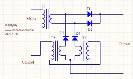

In my view, the operation of the "magnetic amplifier" in the silicon chip article is a bit of a misnomer as I think it is more of a current amplifier using an external current to control saturation which is the actual control mechanism. In layman terms, with no control current the control transformers quickly achieve a level of saturation thanks to the DC steering diodes and passes high current to the load.
The trick is to feed some current during the 180 degrees of no current flow ie causing a net change in the control transformers inner flux that will alter the current passing to the load on the next half cycle - ie we can reduce or increase the final load current.
It appears to me that by varying the control flux level we can now control the point that saturation occur, ergo controlling output energy. So I guess it is a pseudo magnetic control but I don't concur with the simple term "magnetic amplifier".
I also don't concur that the circuit is in its simplest form as the two LHS diodes of the diode bridge could be opened and have the control flux transformer primaries in series with them (yes change the phase of one...) and save 2 diodes. Then the AC inputs to the bridge connect directly to the 20VAC from the main transformer with less diode losses overall.
To restate, it appears that the small milliamp control signal does its magic during the 180 degree off portion of the control transformer - it needs that off time to alter the existing flux with the small control current without having to fight the output current flow flux which it would otherwise need to overcome.
This is why I believe that a control current to fix our sine asymmetry would need to happen when it is not trying to overcome the low impedance drive from the H bridge ie during an off period.
I decided to check magnetic amplifiers in Wiki before I post the above as I wanted a second opinion, their definition is;
"A relatively small DC current on the control winding is able to control or switch large AC currents on the AC windings. This results in current amplification."
Simplified topology
From here I will concentrate on the code fix solution going forward. However I am also wondering if a solution which could add extra dead time (with external circuitry not affecting the code) to in effect reduce the drive only to the unloaded 180 degrees. I did some quick maths and a change of ~1% should be able to be achieved by adding up to a few hundred nano seconds of dead time to each of the HFPWM drive pulses...

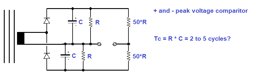

Although the average voltage of your sensing secondary will always be 0V there might be some distortion of the positive or negative peak that is closest to the saturated side of the primary current. If this is the case comparing the positive and negative peak voltages may give a consistent indication of which way to adjust the PWM offset.
To test this idea vary the PWM offset** between +1% through 0% to -1% while monitoring the output of this circuit. Some experimenting with component values will be needed. This voltage may be quite small so amplification could be needed. Depending on the voltage of your sensing winding this circuit's + & - rails might be able to power an op-amp.
Edit.
Thinking about it a bit more, perhaps the time-constant should be 10 or more cycles (200mS).
If the caps. are 22µF then R = 10kΩ for 220mS
Use 1% resistors for the voltage divider.

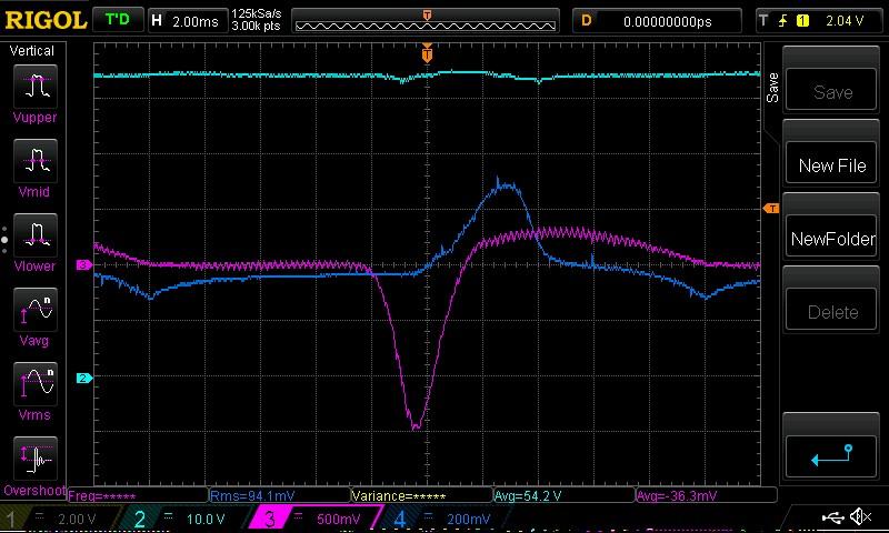

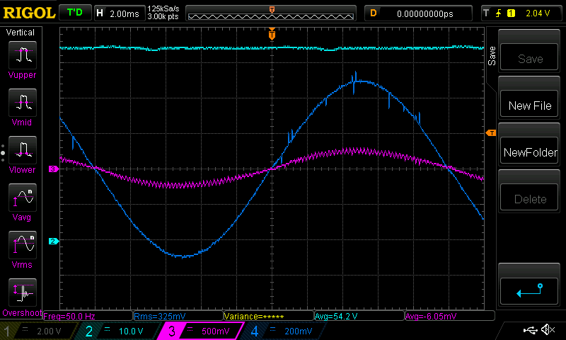

I have modified my inverter test bed.
I now have a 1600V 70A diode in series with the 240V AC output
which I have added a switch to short this diode.
this way I run it "normal" or "perverted" just by flicking a switch.
I run this supply against my 100 - 400W resistive AC load.
there is a current sensor, 0.0208 V/A on the primary winding.
Light Blue is DC volts, measured at the +DC bus location on the inverter board.
Dark Blue is AC volts, as supplied to the load.
Purple is smoothed DC current in the primary winding.
at 200W, with diode shorted is this:
and with the diode in circuit it is this:
notice the Purple average value, lower right in both images.
With the diode in circuit there is rather a lot of noise
from the toroid, as to expected.
My plan is to modify SPWM amplitude to make it not symmetric
and use as input the primary current.
I will go for a value above some small offset, say about 7mV from the
0.0208 V/A current sensor.
Depending on the sign of the offset, I will modify one or the other 1/2 cycles,
bring it's amplitude down a bit, until the current gets below some threshold.
but it's time for beer now so code changes will have to wait for an other day.
p.s. thanks Mike for the box of goodies you gave me. I used one of the VS70HF160 diodes you gave me. perfect for this.

The dark blue mains voltage seemed to collapse with the diode in circuit (second pic) something doesn't look right?

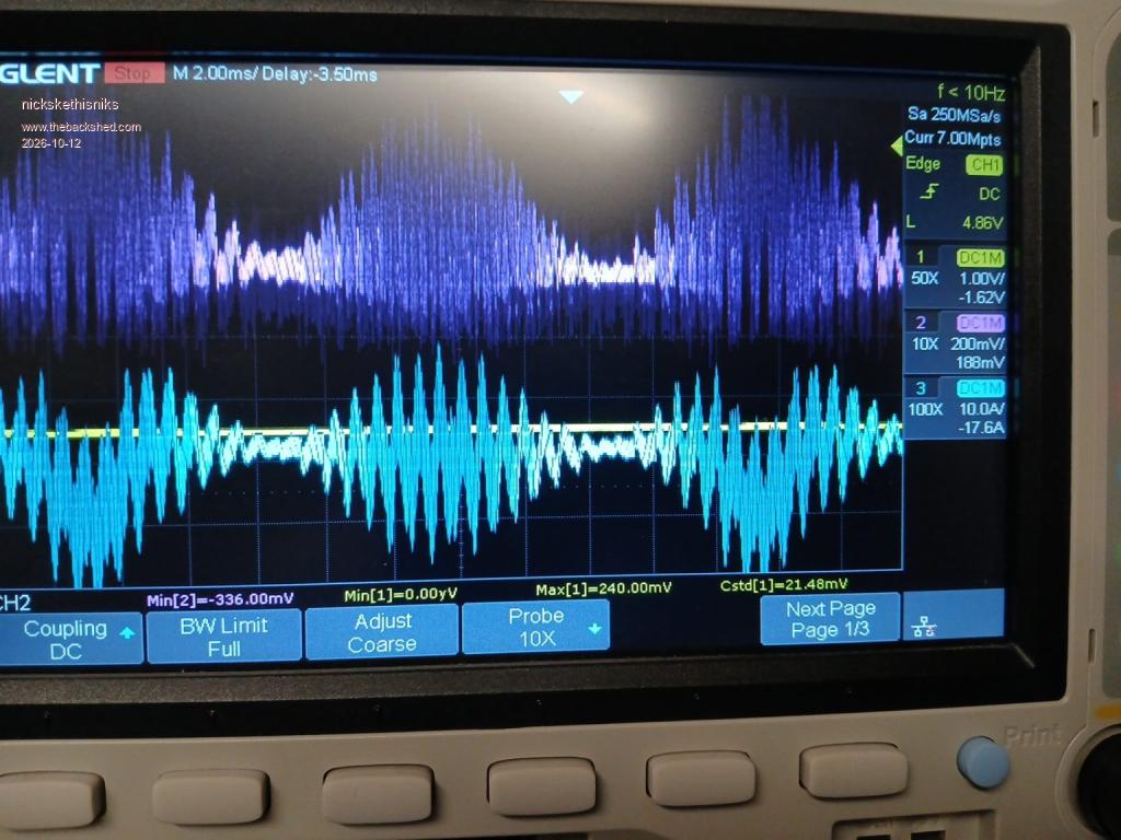

I do something like this:
I just calculate the error = setpoint - measured balance.
If:
error = negative then pos + 0.1 and neg -0.1
error = positive then pos -0.1 and neg +0.1
I can adjust the deadband so it's not reacting to fast.
But maybe the direction is wrong and that's why it drifts to the wrong way.
I do find that ultimatetly measuring current is the way to go, here you can see a no load situation with a current measurement: (but the transformer with a noticeable buz). When there is no buz the current is 100% symetric.
The blue is the primary current (between inductor and transformer) wave measured with a micsig CP2100B probe the other is random CT (2500T 70A rated) with a 100R burnden resistor after a full bridge rectifier (no rc, only adc as load).
You can clearly see a shifted current during a half period, so something is possible based on just the peak current alone. This is a no load situation so this could be even easier to spot with high currents.
(next time I will try to capture the scoop images over the ethernet instead of taken a gsm picture of it. )
I sampled the AC voltage at the exact point where the load is applied,
that is, after the 1uF filter cap, tiny Vfb transformer etc.
It's fun switching the diode in and out of circuit while the inverter is
powering the load.
when in circuit, the lights dimmed a fair bit and we can see why in the AC waveform.
There are much lower voltages and in the case of one 1/2 wave, not a lot at all.
The lights are pure resistive incandescent lights so power is proportional to voltage.
I feel very confident the AC voltage trace is what is output.

or
What current sensor are you using - is it the TLS76? If a second sensor is placed on the primary winding, with a resistive divider the same ratio as the primary/sec turns in theory they should be able to be ~neutralised. Then if saturation starts there will be a steep rise in primary with no corresponding rise in secondary. If the rise passes a threshold the rest of the PWM pulses for the remainder of the 180 degrees could be truncated by the nano - any further pulses are just going to make a bad situation rapidly worse, we need to pull it out of saturation not drive it in further.
Not sure if any of these thoughts are useful but maybe it could be a second level "fix" if the +/- 1% tweak fails to keep the Sine drive under control ?
Enjoy the beers.
Thanks for getting the scope captures. Current sensing solutions should be more robust.  The CT primary current waveform makes the imbalance very clear.  Comparing the peaks is probably fine for no load but might be too simplistic for real loads.
