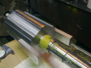

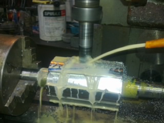

Here are the finished pics of the rotor.
We slid the magnets in just to double check the slot was the right width.
We had made the slot about 5mm deep , to make sure i didn't lose much power the diameter of the shaft was lathed down 2mm. leaving a 3mm slot.
Now comes the fun part EPOXY.... Edited by Smart Drives 2009-10-28

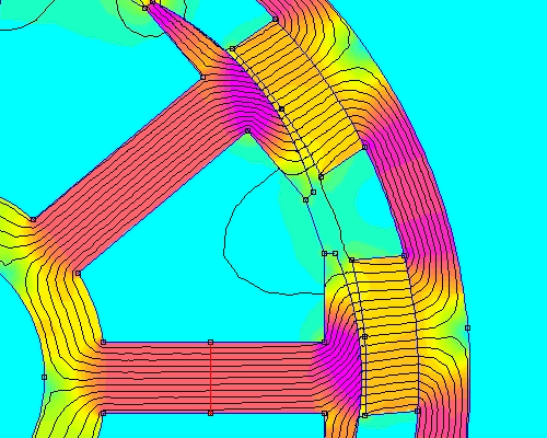

Here, let's see if this will help. Peter's the man with the graphics in this arena, but maybe mine are good enough for this. I've included the scale in case anyone is curious, but it doesn't really matter in the discussion. Just look for the squiggly field lines and you can judge the intensity of the field by the colour scale.
This is one quarter of the cross section through the rotor and stator of my Toshiba conversion. Bigger than SmartDrives' conversion, but scale up or down it all looks about the same.
In this quarter section, you can see four magnets. The two on top are half of a "N" pole, the two on the side are half of a "S" pole. To see the whole rotor, you can imaging a mirror image to the side and to the bottom. The whole rotor has 12 magnets around the circumference. Because it is so big, there was room for 3 of these magnets per pole. On yours I see there is room for 1 mag per pole on the circumference, and 2 along the length. Those are big magnets - you have lots of potential there (haha sorry for the pun).
The N magnets send their imaginary lines of flux up into the stator, because the iron in the stator attracts them. They "flow" around the stator to the S pole and they pass back through the teeth there, jump the gap, and into the S pole magnet. The circuit is complete when they pass through the solid iron rotor to the bottom of the N magnet again.
In your case, SmartDrives, each pair of N and S poles of your rotor are only 60 degrees apart, unlike this 4-pole rotor, where they are 90 degrees apart.
Whether you're getting all this or not, it looks like you're on the right track with that rotor. If I was trying to make it "perfect" I would look for a set of magnets that fills up the pole as tightly as possible. "Cover the rotor with magnets" is my new philosophy!

Covering the rotor with magnets is the philosophy used on Pacific Scientific brushless servo motors. Essentially the same config as a motor conversion, but with curved samarium/cobalt magnets and a smaller rotor dia.
The coloured FEMM scaling is close to only a 10% change for each colour change, so this explains a lot. Visually indicates a small change clearly.
In your Toshiba example, I think the same polarity magnets would be better to be effectively be 1 large magnet face per pole.
Gordon.

"SparWeb, If I was trying to make it "perfect" I would look for a set of magnets that fills up the pole as tightly as possible. "Cover the rotor with magnets"
Hmm....Do you think that those extra magnets would make a significant difference ? Its just that i am so close to finishing that waiting for more magnets might drive me nutty....
I have bought some epoxy that is a paste, no need for a cage to hold it in place. The guy said a little bit on your but and you could hang from Sydney Harbour bridge !
It is important to buy an epoxy that can be lathed when fully cured, the cheaper ones might not be able to be lathed.
BRAND of epoxy is Epirez 633 NON-SAG expoxy binder.
compressive strength 85 MPA , tensile strength 12 MPA

I carefully set the scale of the colours (you can do that in FEMM) so that the numbers were easy to relate to the colours. I had made several different models of Toshi before converting it, but the outputs were hard to compare. I made the three models' colours scale the same so that I could hold up all three and pick which set of magnets would be best.
Of course I'm limited by the choices of magnets available. A curved magnet with a 5" OD would have been perfect, but you can't just buy one. You pay 1000 dollars a piece or you order 100 from China for 20,000 USD.
On retrospect, I could have made my Toshiba conversion even better, by making a new solid rotor instead of using the laminated rotor. That, too, would have been more costly.
