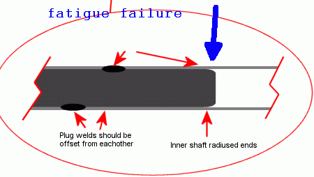

Peter and Oz both have very important things to say, but in all the detail of the explanation they give, the critical instruction is lost:
If you're going to mount that blade to the hub with a tube, the tube has to go the WHOLE way out to the tip.
The mounting tube is the structural member and it must resist radial tension, bending and twisting all at the same time. Don't expect the plastic or aluminum extrusion to withstand any of that. The material of the blade doesn't make the slightest difference. I was dumbfounded to see anyone using short little stubs in the plastic airfoils. How much does a few meters of 25mm rod cost in AUS? It's darn cheap here. Now you're shelling out for 4140 steel.
This is your problem:
Stop doing that.

Steven,
You make some important observations, but there's one important thing still missing from your drawing. You do round the ends of the steel bar, but that's not enough - there's still a very large transition from a solid steel bar to a (hollow) pipe, causing practically all stresses to concentrate into a small area (see blue arrow). One can predict with certainty where that blade will fail: at the blue arrow. With or without a fillet - it makes no difference. I suppose you too know that adding material (i.e. making some parts stronger) can actually cause it to fail sooner, rather than later.
The only solution I see is to *very* gradually transition from solid bar into hollow pipe, by drilling a cone into the solid bar. Not easy though. A completely solid bar through the *entire* blade (very important, as you say) would probably be much easier, but that would leave a lot of (unnecessary) material at the tips and thus be heavy. And I'm still not 100% convinced that it'd relieve all fatigue problems, as there will likely be torsional modes of vibration too, and more complex forms. If something similar to wing flutter were to occur, all bets are off anyway, no matter how big/large/heavy/strong you make it.
The remarks about adding a few rivets/bolts to 'help' or 'insure' the adhesive bond is plain silliness. It contributes absolutely nothing and will likely actually weaken the construction by adding stress points where cracks may initiate. That's the beauty of an adhesive joint. And as for strength... 25+ N/mm^2 should be easily achievable. 50-60 N/mm^2 is achievable with good epoxies. Taking into account the surface area for glueing (pipe 25mm dia, length, say, 1m; assuming half of the surface area is used (see contour alu extrusion profile) that's 40000 mm^2; at 50 N/mm^2 (shear) that's 2.000.000 N, or 200.000 kgf (for a 1m long blade). Yes, 200.000 kg. But, feel free to add one or two extra M3 screws, 'just to make sure'.... Btw: the previous deals only with static shear, not with fatigue.
Those plug welds don't have to be an issue either, as long as you make sure all residual stresses and carbides are removed by a proper heat treatment afterwards.
There's nothing magical or radically new in anything I (or you, Steven) have said - all this stuff has been known for 50-60 years in industry. There's a reason there are autoclaves, different welding techniques, preheating, postheating/cooling, heat treatment regimen, surface treatments (shot peening), etc. to solve the problems us amateurs are getting into by trying to use steel/aluminium blades.

Peter, the drawing isn't mine. It was taken from Homegrown power's website. You can find it yourself from the home-page and clicking on the "kits and parts". It's the first time I went looking for the page myself, because previous discussions I thought people were just making up their own mounting. Now I see that HGP is suggesting this.
Gizmo / Jarbar:
Sorry for this - it's not a deliberate bashing but I am on a roll today and if you care to correct the problems that Peter is pointing out to you, then we can put the guns away.
You can either take our suggestions, or hire a local engineer to work out the details for you because there are some dangerous details to be worked out.

First up, thebackshed has nothing to do with OEM and the PVC/Aluminum blades other than providing the web space for Anthony and Phill to advertise their blades.
The drawing shown on th PVC blade page is how I made my blades. At the time I thought it was overkill, but I like making things stronger than I think they need to be. Some said it was too heavy, but I prefer a heavy turbine than a broken turbine. My windmill with the PVC blades has been up since day one, several months now, and through several storms. Its working fine.
The original OEM prototype windmill design only used (very) thing wall tube, about 50% of the blade length, with no inner rod. Their blades fell off on several occasions I know of, and the PVC started to bend back permanently after the end of the tube.
On this forum we've seen several builds using the PVC blades that, at construction time, the builder said would be strong enough, only to fail days/weeks after.

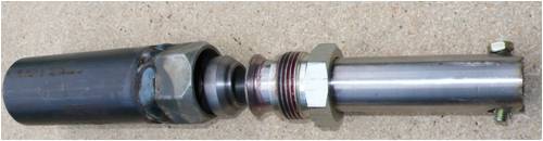

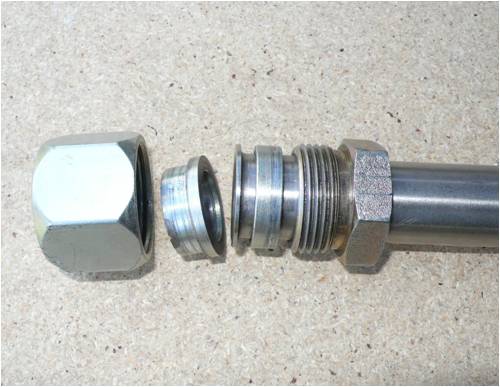

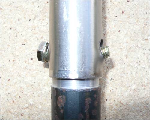

I Agree and with gizmo , that a lot of what is being put forward here to do with design paramiters is very much out of the relms of what we/I are trying to achieve , that being to come up with a cost effictive , strong ,secure and safe way of mounting a set of Aluminium / PVC blades .
Cost effective , I mean by not having to buy products like expensive special adhesives , chrome moly or cdw tubing , both of which I spent a day on the phone costing . When it came down to it 4140 solid was the same price as cdw tube but would still need the solid in it for the first 25% , the solid would be then turned down which would further weeken the root . I think 4140 is by far the strongest for its price for the load it has to bear .
My objective is not to use welding at all , and to have an easy to assemble blade hub and spigot system . I have spent a lot of time designing making testing and scrapping ideas , one being the crimp clamp , but now the clamps will be the basis of the latest design and used as the main rod supports .
Below is a picture of another I recently went down the road with , a highly strong individual mount machined out of a 1" JIC hydraulic fitting allowing the 36mm nut to lock the s/s tube while the 4140 solid as locked into a boss in the tube(cant be seen) as well as the collar , which would be a split collar and the bar under cut to suit , would not allow the bar to move out , and some one would say " what if the nut came loose" then the boss in the tube has a grub screw lock into another under cut in the solid , then what if the s/s flare lock let go , at 80% of the solid length a 6mm bolt would then lock the blade , s/s tube and the 4140 solid as one . See pics below , at 2 ton that is what happens to the bolt solid and tube ( I did not have a nut on and tight for the test , the flare did not budge , the boss is welded in and the idea was to slot the heavy walled 2" tube up to the boss and it could then be welded to any hub , ok for me , but the cost in machining says no for anyone without a lathe .
This was the origional with a 37 deg flare , scraped that , still good for 2ton+
New flare 90 deg , makes machining the collars easy , again scrap , again good for 2T , but as you can see below the bolt starts to tear through the s/s tube at 2.2T
So onto the next clamp and tube now , and yes I do get a bit annoyed when all the advise on how and what to do and why , when no one has actually worked out what loads we are dealing with , how much centrifical force is exerted by a 4kg blade @ 1000 rpm and can they reach 1000rpm ,so why not set that as the bench mark , I've seen 780. How much axial forces are we dealing with in the gyroscopic forces wind forces furling/yawing forces at 75% in from the blade tip as well as at the root . Can it be worked out here on the forum in a constructive manner ?
To throw another senero in to the thread , my origional set of 3.15D pvc blades which are still flying and have been subjected to every wind storm , even the one that destroyed the ax fx 3.2 set , have been out of controll yawing , furling violently and hitting 750rpm constantly on the F&P and are now on the Ax Fx and recorded the 3.2 Kw @ 550 rpm in 57klm during the last lot of storms .
These mounted on 150mm solids with 800mm ss tubes plug welded , these are the same blades that started to elongate the rivet holes in the PVC . The plug welds are not located near the load point as was the blade that failed .
That is greater than 90 / 10 leverage ratio and for all the axial forces and they have not let go YET , I think it is relevant when all we can come up with is , solid all the way , solid 50% of the length .
With what I have seen in the load tests on the s/s tube, at any thing over 2T it deforms and this point would make me think that it should be tearing away from the plug welds or easily tearing the tube if the forces were greater than 2T at the load point of the solid to tube .
Which gets me back to the question , How much force are we dealing with ? and is adding extra weight that is not needed only going to cause additional failure areas due to the increase in axial loadings ?
