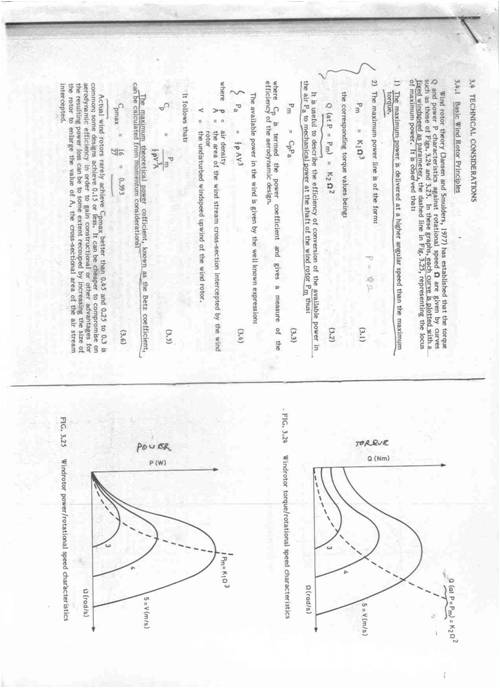

Don B
Joined: 27/09/2008
Posts: 190
Posted: 05:07am 04 Dec 2009
Hi again Bob,
As indicated in my earlier post, I have been tinkering with MPPTs for some time, and this is the sum total of my experience to date.
Theory tells us that the maximum possible output from the blades of a wind turbine occur at a particular tip speed ratio (TSR), which is the ratio of the tip speed to the wind speed. Thus, if the wind speed doubles, the blade RPM also needs to double.
Unloaded alternators with permanent magnet excitation will output a voltage that is proportional to their rotational speed. If you double the RPM, you will double the output voltage. As you indicate, the output voltage of a loaded alternator is reduced by the voltage drop through the winding resistance (a function of current), and by the drop through the winding reactance (a function of current and frequency or shaft RPM).
Theory also tells us that the available power in the wind tracks the cube of the wind speed. If you double the wind speed, your output power potentially increases by eight times.
If you double the wind speed, then your alternator wants to put out double the voltage, less the amount of the increased internal voltage drop. In order for the alternator to output 8 times its previous power at this new voltage level, the alternator current needs to increase by four times.
If the alternator load was a pure resistance then, by doubling the output voltage, the current also would double, and the power delivered would only be four times the previous value. The load resistance would actually need to be halved in order for the current to be four times its previous value. If the load is a battery with a more or less fixed voltage, then matching a wind turbine to it to permit maximum power to flow for any given wind speed within its range is quite an exercise.
So long as the alternator output voltage does not exceed the battery voltage (ie spinning but below normal cut in speed), then useful power can be gained from a boost circuit such as yours. Once the alternator voltage equals, or wants to exceed the battery voltage, then you need a buck circuit to achieve maximum power extraction, however, buck circuits have their difficulties at high power, as Gordon points out.
Another point that Gordon has made is that, by the time you need a buck circuit, there is so much wind power available that you usually don’t need to worry about any possible additional gains.
The problem with a circuit that tries to track the maximum power point with only the turbine speed as its reference is that you don’t know the actual wind speed at any instant. In the absence of that information, you can’t know whether your turbine is spinning at the optimum speed for that wind. Unfortunately, real wind is constantly varying in velocity, so it is difficult to tune the device to give the best output for all winds within range.
The only way that you can know that you are actually tracking the maximum power point, rather than some lesser degree of improvement, is to plot the output power (battery current would be near enough) against turbine speed (volts would be near enough). If the MPP is being tracked, then the current should have a squared relationship to the turbine speed (ie double the volts gives four times the current)
Unfortunately, measuring the speed of the wind actually arriving at the turbine has its difficulties, as the instrument ideally needs to be directly ahead of the turbine. Other locations will degrade accuracy, but would still provide a big improvement in control. At one time I did have an analogue TSR tracking circuit operational, and one interesting finding was that I had to delay setpoint changes as the wind speed changed in order to let the turbine accelerate or decelerate to its new speed value.
More recently, I have been experimenting with a boost and buck circuit controlled by a microprocessor and operating open loop. The idea is that the processor is constantly changing the voltage reference value for the alternator. The processor changes the value by a small amount, then pauses to see if there is an increase in output current. If there is an increase, then it adds a further small change in the same direction. If there is a decrease, then the next change is in the opposite direction.
It’s a great theory, but I can’t say that it is outstandingly successful as yet. I am also probably complicating its task by having both a solar panel and a wind generator connected to it at the same time.
I think that Gordon’s scheme of using capacitors in a doubler arrangement (see visual effect of capacitors thread on this forum) is probably the simplest and potentially most effective arrangement for wind turbines once the correct values have been determined. As your arrangement charges 48V batteries, this a great help. It is also sobering to think that Gordon has experimented largely with MPPT devices before arriving at the capacitor arrangement. It’s the KISS principle in operation, I guess.
I also think that if anyone wants to pursue maximum power point tracking, they would be best off starting with a wind speed input together with their turbine speed, and perhaps some simple analogue circuitry controlling their boost circuit.
Don B

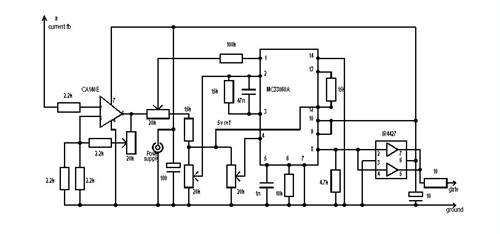

oztules
Joined: 26/07/2007
Posts: 1686
Posted: 11:17am 04 Dec 2009
Firstly Bob,
congratulations on a fine machine all up.
Looking at your power graph, you have built a very low resistance machine. Looking at it from backwards off the graph, I get a cut in around 120-130 rpm at about 12-13mph.... thats with it's loaded/design TSR of about 7... I'm guessing. So cut in is in real life may be around 75-80rpm at unloaded TSR. On a 20 footer, that should leave you with enough room for a few in hand of fencing wire of low turns.... less than 30?
This puts this machine squarely in the camp of a well designed late cut in- low resistance axial flux 20 footer... good for bursts of 6kw or more in the sub 30 mph winds I suspect.
This has to be an absolutely perfect candidate for the style of converter you have designed.
It's not how I was going to do it, but you have crafted a working, easy to replicate, common parts converter, which seems to have replaced the part of the capture curve you have designed out of the stator, and pulled it back in. You must have decent blades to match that graph. A cp. > .3 I suspect.... Glass or wood?
My congratulations. Many talk about it, not many do it.
I've talked about it, and I designed my 4m mill accordingly for late cutin specifically to take advantage of the power curves matching up better in this configuration, and was going to build a converter. (design cut in of 11-12mph at loaded TSR, actual unloaded tsr cut in about 6mph).
I never built the converter, as I discovered that we don't have winds less than about 8-9mph. It is either 9 or more, or dead still (rare)..... so a converter was never required.... part of living in the roaring 40's part of the world I guess. So on what we call calm days, it ticks along at 80-500 watts. Because of the low turns/resistance, on the windy ones 500w-3kw or so.
I still mean to do it one day as an exercise.
If you are going to take on board some of the comments, so far, I would agree that a PWM chip with on board Fet driver simplifies things, and I would sense the current rather than the implied voltage as Flux suggests for this style of control
But it is working well as it is.... so perhaps just sort out the switching of the Fets at least.
I still like to see analogue stuff.

EDIT: Not sure I would call it mppt in the strict sense, as it will not suite most axial mills.... I say most, as most of us are greedy and wire them for early cut in... where this would be of very limited help.......perhaps call it a boost converter for late cut in mills.
Probably quite useful for the motor conversion crowd too, as with their small diameter magnet rotors I seem to recall that they cut in late.
Edit2: [quote]Gordon:
You are right; there are many PWM chips available that can be configured to serve the purpose of the (lowly) 555 that I used as shown in Figure 2 [/quote]
Actually, most pwn chips have a regulated vref for your use (usually about 5v), a fet drive, and a few op-amps on board... and a dead time control accessible as well, a single chip may replace most of the discrete components. Switching at 30khz with some ferrite may bring the inductor down in R as well... just a thought. Edited by oztules 2009-12-05

bobshau
Joined: 22/11/2009
Posts: 27
Posted: 04:53pm 04 Dec 2009

Joined: 26/07/2007
Posts: 1686
Posted: 10:55pm 05 Dec 2009
I was able to look at your fieldlines story....anything fieldlines at the moment is a chore to be sure...
Very impressive and interesting approach to building a biggie. A lot of thought has gone into it. I like the heat exchanger idea.... neat.
You clearly see the merits in boost converting and designed for it by the looks. It is the best way to go I think..... I just don't need it. It's just another "bursts of 3kw" day here.
Here is the circuit ( from Flux) I was to base mine on. I would have used a different pwm chip, so I would not need the driver. I have a few hundred l4990 here, which incorporate a driver. However, tl494's are in abundance on any PSU computer power supply, and a few 3 cent driver trannies in a totem pole solves the driving problem.
You have it under control as I see it anyway. Best wishes with it.
...........oztules

While it is possible to use a small measure of positive feedback around the op amp to hasten its switching, (or per haps use an actual comparator) it is still preferable to use something like the hex driver to switch the gate cleanly, and with sufficient grunt to quickly charge and discharge the gate capacitance.
On the topic of fast switching, the effect of fast changes in current (and/or voltage) on leads associated with the FETs is exactly the same effect as having them operating at very high frequencies. They need to be kept as short as possible, and clear of each other. Curly tails in the wiring are inductances, and these serve to slow and radiate the switching impulses, and should be eliminated (in the Beta version).
Your IRFP150 FETs have an on resistance of around 0.055 ohms each, and I believe that you have three in parallel, giving a potential on resistance of .0018 Ohms. If they are passing, say, an average of 10A of current in total, their individual power dissipation will only be around 0.6W each, which I would not expect to make them even perceptibly warm. Of course, the power dissipation increases with the square of the current, but I would still think that noticeable warmth in operation suggests the need to look more closely at the cleanness of the switching. An oscilloscope is an inestimable help for this.
Finally Bob, I was most impressed at the description of your complete turbine set-up that you gave to Oztules. You have obviously gone very thoroughly and methodically into all aspects of your project, and the results do you great credit. As Oztules indicated, arranging the alternator output voltage to be such that a boost circuit can be usefully employed for the lower (and otherwise wasted) winds prior to what would be the normal cut in point certainly lets you suck in the last few drops of the free stuff.

oztules,
Thank you for posting the PWM circuit that Flux provided to you. I'll check it out.
Also, thanks for the encouragement.
Blessings and peace.
Bob
Don B,
Thanks for taking the time to answer my questions and providing the constructive comments and recommendations for the PWM Boost circuit. I believe their implementation will improve circuit efficiency. Lots to chew on.
Bob

Hi Bob,
once you drive the mosfets harder and square up the switching edges, you open up a new can of worms. RFI interference. You will need to pay a lot more attention to loose conecting leads and probably need to go for a PCB layout. The curly wires are not part of the required layout. My early designs like you have wiped out TV and radio reception for me and the neighbours.
The cap boost arrangements do not suffer this problem and open style wiring is still possible.
It is difficult to screen the high power switching energy emanating from air cored inductors.
Gordon.

Hi Gordon,
Thanks for the "Heads up" regarding possible RFI interference after squaring up the switching edges.
Right now, the circuit works great as it is. I don't believe I get any more RFI from the MPPT booster than I get from the Outback inverter based on the amplitude of "static" in my AM radio earphones. We get no interference in the house. All this without any attempt to shielding.
The heat sinks are able to maintain MOSFET temperatures well below being "hot to touch". They are able to carry over 20 amps to the 52 volts of battery bank (1000 watts). Maybe, I should not fix what is not broken.
By the way, I'm almost done comparing the Cap booster to the PMW booster for my 20'. I think I'll publish the results today or tomorrow.
Bob

[quote]The heat sinks are able to maintain MOSFET temperatures well below being "hot to touch". They are able to carry over 20 amps to the 52 volts of battery bank (1000 watts). Maybe, I should not fix what is not broken.[/quote]
If temp is stable, and no rfi, then leave well enough alone is a fair deal I think. Because it is a booster, it won't see any unforseen power surges as it would if it were a buck carrying full power.
So even though it may not follow the ideals of PWM practice, it works. It has tested all limits it is able to incur....and is still alive and well, and so will continue to work indefinately.
It seems to avert the RFI by slope switching.....small expense in efficiency. With a 20 footer..... you'll never be aware of this loss
I'm a great believer in don't fix what aint busted.... but I'm a lazy slob too
...........oztules

Thanks oztules.
I plan to incorporate some of Don B's and your recommendations on the next one I build. Shorter leads, better driver, different op amps, etc. Much appreciate your comments.

Hi Bob,
I agree with oztules re the mosfets in your application. This is a large windmill and the slow switching of the mosfets will keep the RFI in check, with some associated losses. The boost maximizer I made that is on my older AxFx mill passes all the mill power. I have a single mosfet with no heatsink [SMD mounted on PCB] and the power passed is up to 450W[close to 20A at around 22V]. There are pics and description of operation on the early MPPT thread. Before I looked at micro alternatives. Mine is into 3rd year of operation now, since 2006.
PWM is the best solution for multi kW windmills. Maybe the commercial operators will adopt the system you have presented on the big windmills.
Gordon.

Hi Gordon,
Glad to hear that your MOSFET driven boost maximizer has worked reliably since 2006. If you add a few more op amps, etc, you could teach it to do MPPT. Since our windmills require our time and $, we might as well get the most out of them.
You said:
"PWM is the best solution for multi kW windmills."
I agree. They allow easy calibration to assure they run at the maximum power point for a wide range of windspeeds. For this very reason, PWM is a good choice for the smaller mills, as well.
Bob
