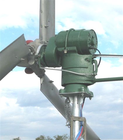

A very early version?
Found the serial number --- 1762.
Two wired, geared head, with -20 to +20 DC Ammeter, so that says it the 32V version? Right/wrong?
Now, there is an additional bit - a voltage regulator(or other?) appears to be a later version (rather less weathered with plastic covered wiring rather than cloth) with capacitors etc. but it does say 'Phillips 20 AMP 8824" on one of the covers covers (each attached by two screws) on the outside. The other cover appears to have '750' (plus other undistinguishable markings) on it. It has six wires (3 red, 3 black) coming out of it. There is nothing to say where are these attached - as there is no wiring diagram in the manual.
Thanks.

Neil,
I have little knowledge of the 750 watt machine as I don't have one nor have I seen one, however I would say that all of your asumptions are correct. The 'additional bit' you refer may be a mechanical 'cutout relay' or a seleniem rectifier. It's purpose is to prevent reverse current flowing back through the armature and field windings when the battery voltage exceeds the voltage level the generator is producing. If you look at page 10 of the manual (Pearen site), it explains where the 6 wires go. This model did not use a voltage regulator, but instead relied for regulation on compound connected field windings, unlike the later models L & M which have a single shunt connected field winding and use a voltage regulator. The seleniem rectifier is the predesessor of today's diode. You could probably replace your cutout relay with a heavy power diode as I am doing with my machine.

Hi neil0mac,
The turbine you have there is most likely a 750 watt, 32 volt (you will have a 4 blade fixed pitch prop?) with a later version voltage regulator. The wires are 2 from the turbine, 2 for the battery and 2 for the load. This is the link for the turbine manual http://www.pearen.ca/dunlite/32v/32v750wGearDriveManual.pdf .You should find most of the info reqired in this manual (wired the same as the old regulator, read under the heading of RELAY)You will have to identify which is the B, G and L wires
A connection diagram can be found in the model L/M manual from the same site (ignore the power control unit in the diagram. This is used on field controlled turbines)
The other method is do what most of us are doing nowdays is to just connect the turbine to your battery bank via a large diode (at least 40amp) and use a shunt regulator to regulate.

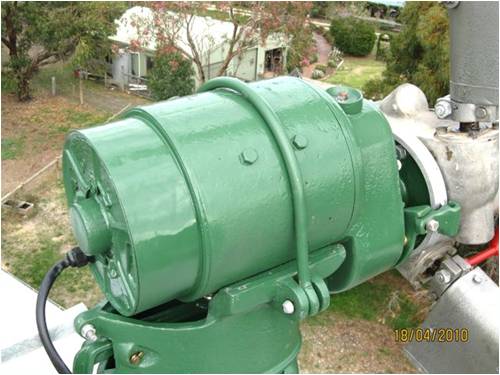

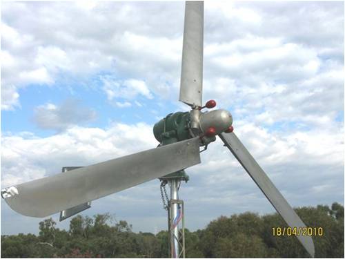

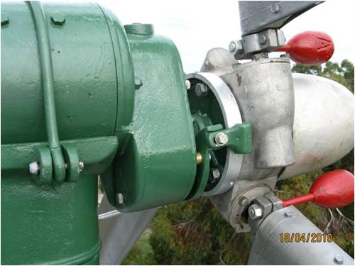

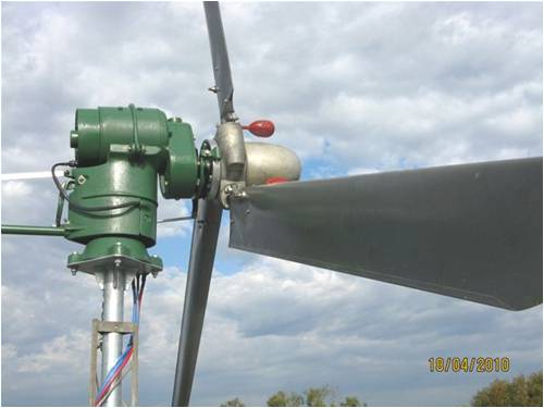

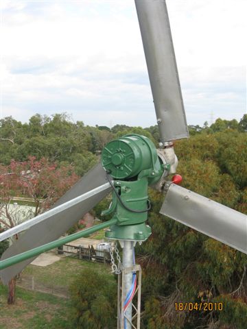

My Dunlite Model L is finally up and running, however I still have some blade balance issues. I havenot had a decent wind yet to test it properly but early indications are good. See attached photos.

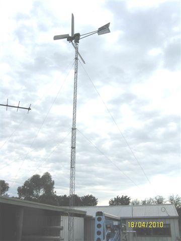

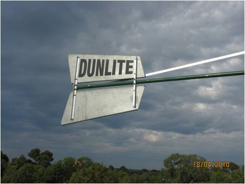

Another pic showing art work on the tail, it is the same on the other side but with the artwork slope reversed. If enough people are interested, I can have more made, price depends on how many.

That is a beautiful machine Don. Thanks for posting the pictures.

  b351267 said   My Dunlite Model L is finally up and running, however I still have some blade balance issues. I havenot had a decent wind yet to test it properly but early indications are good. See attached photos.
Hi , you may have already ballanced your props but if you havent, some friendly advice. Many people used screws and washers for ballancing as well as other methods of ataching weights. I have found , tinning a section of each blades trailing edge and then soldering or lead wiping that section a much better way. Once the solder or lead is in place it can be filed to adjust each blade individualy. If you are going to be playing with the dunlites ( and I hope you stay with them ) building a ballancing stand , using the gearbox casing from a scrapped unit will prove an invaluable tool in years to come. These Dunlite units are by far the best wind turbine units ever made I.M.O. They are relliable require almost zero maintenance and the squeek of a correctly set ( timed ) brush set is a sweet sweet sound.
Hope you have as much fun as I have had over the years and continue to have today.
Cheers, Charlie

Charlie,
Thanks for your advice on balancing, I only wish I had known or thought of lead wiping when I had the blades off. My solution was small strips of lead pushed up the joint at the propeller tips with a self tapper through to stop them flying out. Nowhere near as elegant or aerodynamic as your method. My blades are now reasonably well balanced but not as good as I would like them to be. The method I used was to mount each one on a piece of 1" pipe, suspended from the ceiling with a weight at the opposite end. Starting with the heaviest blade, using a spirit level, I then added weight to the opposite end of the pipe until it hung perfectly level. I then substituted the other two blades using the same weight at the opposite end, then added weight to the blade tip until each hung level. I really believe that to get them perfect I need to balance them on the hub as I believe the hub has imbalance also. The only way I can think of is similar to the way they balance wooden aircraft props, they mount them on a shaft with the shaft sitting on knife edges to eliminate almost all friction, then they adjust the weight of the blades until the prop will sit in any position. The problem doing this with the Dunlite prop is that I can't think of a way of extending a shaft through the front of the hub, or any other way of mounting it to eliminate all friction. The ultimate way of course is to do it dynamically, but it would be a big job to build a rig to do this.
You mention brush timing, unfortunately I don't know how well mine are timed as I had no way of driving it on the ground while observing the commutator, it does however squeak rhythmically at low speeds but I am not sure if this is good or not.
Overall I am quite pleased with its performance and it is now driving two SWEA grid connect inverters and doing something useful. In fact I have been known to sit watching it spin in the sea breeze for long periods of time while enjoying a beer/s on a nice summer evening. Don.

Are you sure that tower mounting is strong enough?
