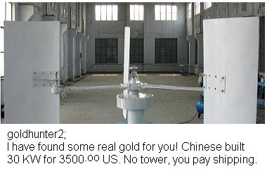

goldhunter_2
Joined: 10/03/2010
Posts: 57
Posted: 12:52pm 13 Mar 2010
I love how every forum for the last 10-12 years I get the same kind of comments towards my user name it was the first user name I took and chosen for my coin collecting
They have this one also I will just have to check into how much more difficult all the extra restriction form local power company are for have a generator rated over 10kw as I was trying to stay with in there restrictions. I was thinking of a little different blade design but for the price of complete unit they aren't to bad
VAWT(vertical axis wind turbine) is one of our leading products, out put power from 200w-30kw, ON/OFF grid tie inverter, Ultra lightweight, small size, low wind start, fast generating, reliable speed-restricting and stable running, rated frequency 50Hz or 60Hz and different output voltage, high wind energy utilization rate, suitable for different wind speed area, low rotary speed but high power output, quiet operation and low wear, low starting wind speed, high strength improved composite GRP blades for higher efficiency, powder-coated cast aluminum corrosion protection body, new controller design with electronic torque control...
$1000 us each required purchase 3 units
http://qingdaoarena.en.made-in-china.com/product/oMnmibIlOpR h/China-VAWT-Vertical-Axis-Wind-Turbine-.html Edited by goldhunter_2 2010-03-14
GWatPE
Joined: 01/09/2006
Posts: 2127
Posted: 01:48pm 13 Mar 2010
  goldhunter_2 said   is one of our leading products, out put power from 200w-30kw,
The unit pictured is probably the 200W version.
Unless dimensions and other specs are given, It is difficult to make any useful critique.

Here is some Info on the 10 kw version that is similar to the one goldhunter2 has pictured. this blade has 7 pieces rather than 6.
INFO LINK
Technical parameter, power curve, and other details of our wind generator will be pesented to customers, so Please contact me if you are interesting on our wind generators.
QM-VAWT-10KW/100RPM TECHNICAL PARAMETER
Power 10KW
The diameter of wind wheel 4.5m
Numbers of blade 7PCS
Rated rotate speed 100r/min
Maximum Speed 120r.min
Start up wind speed 4m/s
Working wind speed 4--20m/s
Security wind speed 40m/s
Rated wind speed 10m/s
Rated power 10kw
The max power 11kw
Output voltage(DC) 120/240v
The height of tower/weight 12m/2400kg
The top part weight 800kg
Output control system charger control inverter Edited by Greenbelt 2010-03-15

GWatPE
Joined: 01/09/2006
Posts: 2127
Posted: 10:37pm 13 Mar 2010
A typical high end commercial windmill of 3.7m rotor is rated at 1.8kW in 10m/s winds. This is 1.8kW/10.7m^2, or 167W/m^2 of rotor.
These units pictured in links above have 10kW rating for 4.5m dia rotor, and what would appear to be 2.4m high sails, so 10.8m^2 area.
The same area of wind somehow produces 6x more power.
I don't think so.
Maybe the units are rated at 20m/s.
Maybe a performance graph would be in order. I remember reading the MW HAWTs having high efficiency, around 50%. getting close to Betts limit.
I would be put OFF with the weight in a first instance. A job for engineers, and a skycrane.
Gordon.
