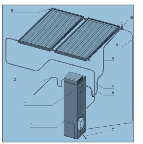

here it is from someone who did EXACTLY what you are looking at doing here.
20 tubes, circulating pump and controller BTW link for prices is as good as my guy on ebay-well done.
Tank -200L+ is pretty much mandatory or you WILL have problems as they can get real hot.
PTR 850KPA at one end of the collector, burp valve the other end.
Typically your storage unit will have three connections water in water out and one for the PTR valve.
If you dont have a fancy three way fitting or cant use the one supplied (i couldnt due to the pressure dome inside the tank being in the way) plumb the return on the opposite side (T piece with the PTR) to the hot water outlet or at night you'll get cold water.
Place a simple flat plate type one way valve $10-15 in the line going to the roof (cold side) this will prevent thermo cooling at night.
pretty much done. Turn off the gas in Summer, Autumn and spring, turn it on to vacation or slightly higher for winter and it will work a treat.
MUST have 600Kpa pressure limiting valve on the inlet to the HWS or you will have problems with any solar system as the temp fluctuations are greater thus thermal expansion will hit 800KPA no problems.
MUST have a Tempering valve as one of the other guys said or you'll be burning yourself regularly.
INsulate all the pipework with armourflex the thickest you can get, run you lines to the collector in 1/2" copper and use some old square downpipe to run the lagged pipes in. It may be UV stabilised (the armourflex) but the aussie sun still destroys it.
Be careful with the tubes as they are fragile, pull the copper heat pipe out of the tube 4", lube up with transfer paste (will come with this) push it fully home into the manifold THEN insert the evacuated tube into the manifold. This is the trickey bit if you tap the end of the glass tube on the frame while wiggling it in it WILL break!
Lastly for summertime hook up the dishwasher to HOT supply as you wont be able to use the hot water fast enough and dishwashers use 30-50L / load!

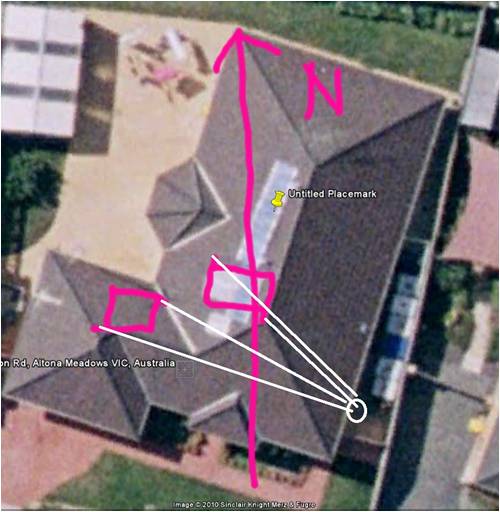

Now a evacuated tubed orientation question.
i do have a north facing bit of space where i can place the 15 tube frame, but the tube runs will be nearly 14 meters.
or i can go on a west face an it will be around a 8 meter run. shorter runs
So will the evac tubes work ok/ good enough from a sun strike point that comes from the side for say 1/3 of the day?
tubes are 1980mm by 58mm type
my crude dwg show my house the house is scewed of to the east a little, the pic is from google earth
Edited by rgormley 2010-04-17

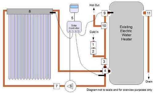

ok more questions
my DUX tank has two inlets (left and right bott)
and two outlets (left and right top) the left side connections are currently used.
as for how i connect the solar collector, should i simply connect using the right hand side connection using the top as a input from the panel (hot) and bottom back to the panel (cold) as per first pic
OR connect on the left side using a 4way conversion valve

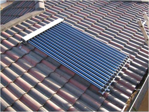

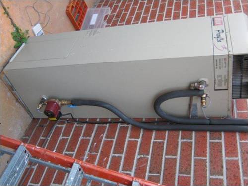

OK IT`s DONE!!
this is a letter/update i sent to the supplier, it has a few updates and info....
Hi Alex,
I will give you a breakdown in numbered form so you/we can expand if needed
Also have attached a few photos, they are in reduced quality for transmission

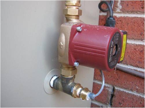

QA: is the pump good for a copper loop run of 30 meters (4.5 mtr rise) hope so…..???
QB: I can’t do a flow test (is this bad?) or not a problem, I presume the proof will be today, as the suns out and water temps are rising)
QC: What Setting Should I have the pump on low/med/high ?? (remember it`s a 30 mtr copper run)

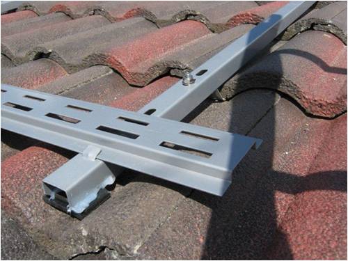

1: All 20 tubes arrived unbroken, there was a few side scratches from where something (fork lift blade) and hit and punctured the side of the box, but very minimal scratches.
2: Plastic Wrapping was open in a few places (could have let water in, if it rained) but no problem for my package, all dry and good
3: Package was asked to be signed for (my wife was home as it happens) signed on the hand held portable PC gizmo the couriers carry.

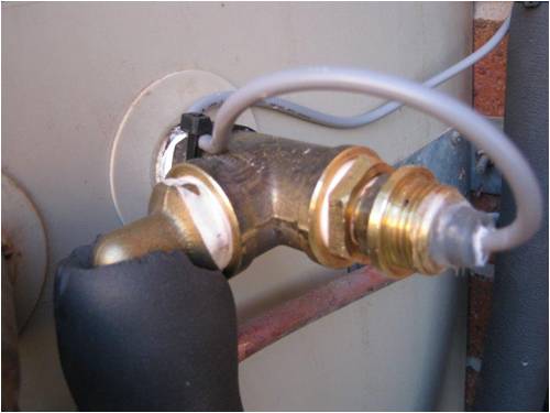

3: roughed the copper pipe in the roof last week ($85 for AS standard ½” 0.91 mm soft annealed coils)
The run is fairly long, at 15 mtrs from pump to manifold, hope the pump copes with this

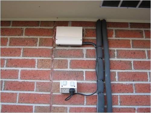

4: insulation is Armaflex 1/2” by 13mm wall thickness (normal plumbers use 9mm wall) but I upped the thickness to the next size of 13mm wall ($3.41 per 2 mtr length)
5: run the external double gpo (looped from a nearby gpo in the bathroom) Clipsal ip53 rated GPO, 4 mts of electrical TPS2.5mm, and 1 junction box (parts only compliments of the sparky at my work)
6: bought the usual brass/copper fitting from a local plumbing wholesale store and bunnings
7: the drywell insert!!! What a hassle!! (lucky i`m a backyard engineer, read on !!)

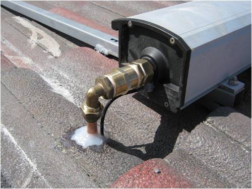

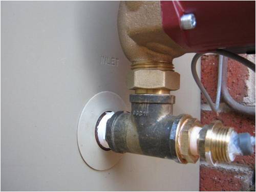

Not one of the 6 or so local plumbing stores had these things…. Some did not even know what I was talking about…
So not be put off I went to bunnings to “make” a dry well insert, the guys at bunning`s understood what I wanted to buy or make but said there was nothing like that in the store. (millions of bits of stuff in a bunnings store, anything can be made!!)
So i put my thinking cap on and made this….
Got a solid brass tap repair kit and pulled it apart, the insert has an internal 3/4 thread in it and the shaft diameter is around 12mm thick, so I measure the temp probe and core drilled the centre of the the tap repair shaft, reassembled the whole lot backwards into a ¾ te piece inserting the temp probe in the newly drilled hole with some thermal grease and bingo one “drywell” insert, works like a charm!!
Photos will explain this better, I should have taken photos and documented this but sorry did not.
8: connected all the plumbing fittings with some good quality pink boston tape (no it`s not gas tape) just slightly thicker plumbers water pipe tape.
9: bled the air out,
10 turned on the electrics on, unfortunately I can’t do a flow test (is this bad?) or not a problem, I presume the proof will be today, as the suns out and water temps are rising)
11: used the “test” mode to turn the pump on and all sounds ok, I can feel temps changing through the pipes so the pump must be flowing.

13: 7:52am sun just on edge of roof line 14 Deg
7:58am sun just striking the top edge of manifold panel 15 Deg
8:17am sun 1/2 on sun 21 Deg
9:07am panel has full early morning sun 39 Deg
Will keep you updated for a while as the day progreses
