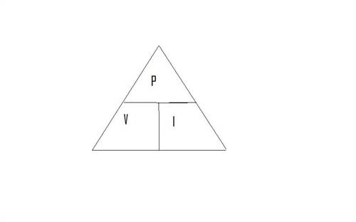

Maybe the old VIR, PWV triangles would help as well.
Cover the one you want to calculate. ie. Power(P) = Volts(V) x Amps(I). Amps = Power/Volts

I have added a bit and now send for your correction / critique I tried to include the wire resistance table but the format was lost any suggestions? I don't know how the format works on the forum.

OK. Please don't take offence. There's a couple of things here I'll add my views on - it'll be up to Gizmo I guess, to make the final call on...
Also referred to as “EMF” {Electromotive force}
Not sure that references to EMF add anything. Perhaps a seperate entry for EMF saying simply "See 'Volts'" ?
