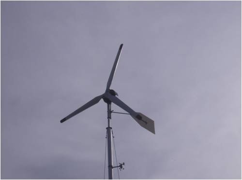

I have five turbines flying and a hodgepodge of different photos of them being built, generators that I've built, etc.. It's always nice to see the finished product so here's a photo of one of my 13's perched on it's 52 foot steel lattice free-standing tower (yes, I built the tower too), taken with the zoom on the camera

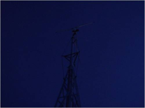

And one that shows more of the tower for that machine

niall1
Joined: 20/11/2008
Location: Ireland
Posts: 331
Posted: 01:56pm 19 Jun 2010
hi Chris
thanks for the pics...it must be quite the view underneath that 52 foot tower with the other machines running nearby...with 5 machines i,m guessing you have very nice neighbors.....or possibly none at all .. Edited by niall1 2010-06-20

ChrisOlson
Joined: 19/01/2010
Posts: 60
Posted: 03:10pm 19 Jun 2010
Pretty much no neighbors at all. We own and run a 3,200 acre grain farm here in Wisconsin. Two of my machines are 12 volt - one runs my shop office (lights, microwave, computer, cordless tool battery chargers), the other powers our lake home which is 7 miles away from the farm.
The others are 48 volt and power the house, rest of the shop, machine shed and outdoor lighting.
The bulk of our power is generated with a Cummins N14 465 hp 250 kW diesel genset. We don't have grid power because the utility company wants too much money to run lines to our place. With the price of diesel fuel we try to keep the genset silent as much as possible. But even so, our diesel fuel bill runs around $30,000 a month during harvest in October and November when we have the grain dryer and all the handling equipment and combines and trucks running.
We'd like to get a Jake 31-20 but can't afford one. We've applied for USDA REEP grants to get one, but the government is broke and no funds available after paying for cleaning up oil spills in the Gulf of Mexico, and other such pet projects that make it look like politicians are worth voting for. My hope is that, someday, we'll get some of our tax dollars back in the form of one of those grants. But I'm not holding by breath in wild anticipation.
Chris
off-grid in Northern Wisconsin, USA
