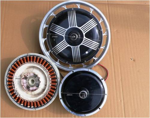

Anyway getting back to what keeps us all comming here , Karl you asked whether there is a 48V version of these , I have posted a picture below of a larger motor that was sent to me with the Kits to have a play with .
As you can see the difference in size between the 500W motor and a F&P and that in lathe testing I was able to get over 1000w out of the small one , compared to a max of 350W out of a F&P . The bigger one definatly holds hope for a 48v . To get 48v out of the small 500w motor would mean a cut-in Rpm of over 600rpm I would think, the bigger motor I have not put into testing as yet but I did have it connected to a doubler and spin it up by hand with a volt meter on and it gets up very quick .
I believe it has 62poles , Neo magnets like the smaller motor . The Company is making them into a bigger wind generator and rating it @ 2Kw , but I have not seen
the finished product, but I am lead to believe they are going away from up wind to downwind models.
I am currently building a full test bench using a 6.5Hp engine with a 2:1 Reduction box and then reducing again with two multi v drives of 3:1 & 6.5:1 which will give me two speed ranges of 90 to 200Rpm and 200 to 600 . This will be set for testing with full logging to a laptop of output and also with ability to measure input torque . Once i get this set up I will be able to get a better idea of what kind of grunt the bigger motor can produce as the 500w Stalls my lathe out over 1kw .
The primary reason for the test bench will be for of course the Ax 300 & Ax 400

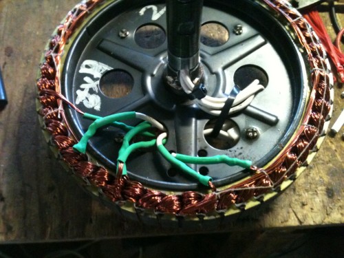

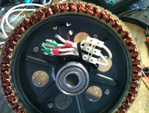

I changed my mill from star to delta on the weekend. In star its worked well for 24v, but all my gear is 12 volts, so I took Phills advise and rewired the stator into delta.
The stator connections are behind the stator, meaning I needed to remove the motor entirely from the nacelle before I could reach the wire connections. While I was at it I drilled out the center hole and pushed through 3 2.5mm wires to replace the factory 1.8mm wires. I separated the phases and poked all the wires throught the stator holes and secured them to the front of the stator. This will mean I only need to pop off the front cover if I wanted to change the star/delta configuration in the future.
Cut in for 12v has risen from about 90 RPM to 130RPM.
GlennEdited by Gizmo 2010-07-28

Glenn, The turbine I have from Phill is also now in Delta. This is because I am running 24 volt system. I am Very happy with the construction of the turbine it's self I am hanging out to get the thing off the bench and up the tower. The boxing for the cement is done and all ready to pour tommorrow with luck. I should have it running by the weekend. Like I said it's in delta and data logger is set up ready to log. So as of Saturday there will be no wind in Victoria for a week.
AMACK
P.S Should I paint the Ally blades or leave the raw?Edited by AMACK 2010-07-28

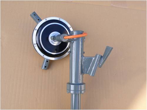

Nice work Glenn now you need some wind , then extend the blades, tail and tweek the furl point and you will be getting some good Watts .
Amack , It is personal choice to paint , I leave mine unpainted at present but I would like to paint some them in the future , remember that the paint will affect balance, also you can use paint to balance .
The pic below is another Mod I did to Amacks , it allows easier removal of the generator so you can put it on the blade balance tool , feeding those wires through the tube while holding the gen & blade head is a bit trying , I drilled a hole in the back of the generator mount and in the side of the yaw bearing tube and it makes it a whole lot easier getting it on and off .

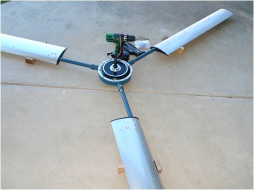

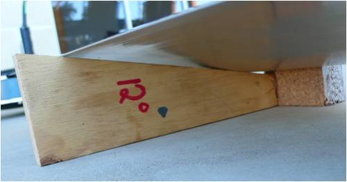

The pics below show an easy way of setting all the blades at the correct angle when doing the blade extension mod . The blade tubes have approx 3deg of movement in the bolt holes , if you set the angle with the tubes in the centre of their movement @ 12deg then the blades can be adjusted to their min and max Angle of Attack ( 8 - 10deg through the cord or when you set thm on the flat as shown 3deg needs to be added .
Pic shows the block cut at 12deg , these will hold the blade in position while drilling a riveting the new holes
I have been putting together a DIY guide with all the info on what I have done to these to get them performing better , I will eventually have it in the Kit&Parts section as a down load or I can email the info if required .

Posted: 12:21pm 08 Sep 2010
Hi Phill
Looks good to me a simple and effective way to adjust the angles.
Have you got a spec sheet on the airfoil as I cant finf my airfoil book to do the checking I want to do.

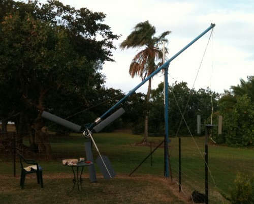

The blades should have been fully furled in that wind but with the tail kicker on the end of the tail it may not have allowed a full furl in these wind strengths .
For one of these mills in a HIGH WIND ZONE I would now recomend the blade size to be no more than 2.55m , the furl set angles to be 11-12deg side 7-8deg back and the tail kicker to be almost straight (if using the specs given on the tail mod sheet)

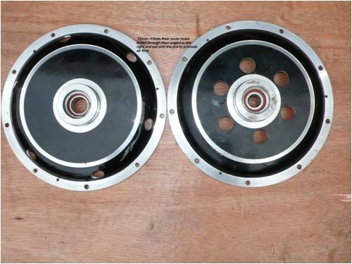

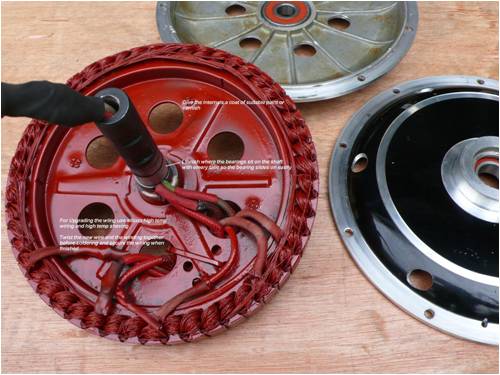

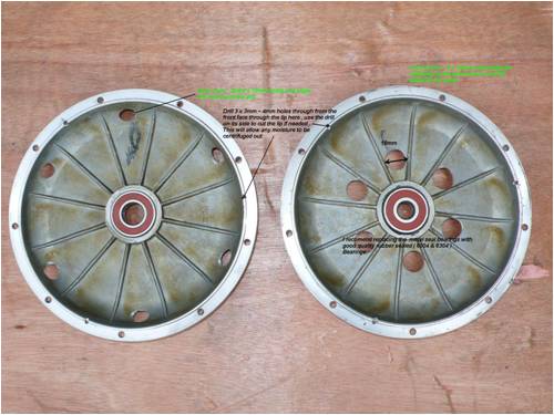

The stator and covers to be modified for cooling as shown below and the use of high temp wiring for the wiring mods .
Also if the shorting switch is to be used to stop it then to do so when it is in a wind lull or under 400rpm .

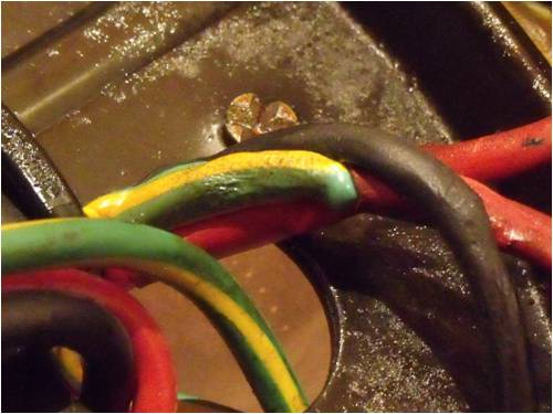

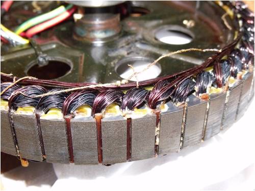

The pics below show the heat that built up inside the generator , it became hot enough to melt the plastic as well as solder . The stator windings are all shorted to the core as well the wiring is fused together.
Amack has the modified covers back now and is doing the blade size and furling and hopfully will be up and running again soon .
