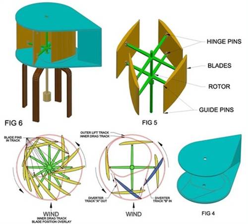

OK I have looked into solar panels and the price / watt is no good at all. You would have to be off the grid, really rich and concerned about the environment or off your rocker, keeping in mind the sun doesn't ever shine all day and panels can easily be damaged by hail, baseballs etc. If you lived in the desert maybe a good idea if you can get a really really good deal.
Yes, a turbine will not produce power when wind isn't blowing but if it isn't spinning it isn't wearing out. Rotational molded plastic is kid tuff...see Little Tykes...the stuff will last a long long time.
This 4' sand box retails for $39.95 and probably doesn't cost half that to make.
It is the cost of the molds that's the killer for me.
BulletBobber molds were cheap but only because I had them made in China for 1/10th any US quote.
Edited by VAWT 2010-09-03

  Perry said   Hey VAWT,
I question your comment that a VAWT will provide better low speed performance over a HAWT. Why do you think this?
Perry
Perry,
How dare you question an old arm chair nut case!
A SAV starts producing at lower wind speeds then a HAWT for the simple reason it takes the blunt perpendicular force of the wind to provide torque and a HAWT uses the deflective (twisted blades) force to create torque. The forces have to go thru one more transition in direction on a HAWT and a DAR. If blades have equal exposure area as shown below the little SAV starts producing power first. This has nothing to do with wind swept area just start up torque and low wind speed utilization. HAWTs and DARs don’t produce anything until wind reaches a much higher speed then a SAV requires.
Must replace VAWT with SAV to be correct. This idea isn't exactly true because the length of the blades being longer (stick out further form the shaft) on the HAWT providing some additional leverage torque. If they were the same size height the SAV would sart a lot sooner.
They have built some big DARs but the problem was they didn't hold up. It wasn't the theory that was bad it was the size and materials of construction. The other draw back was they didn't start producing power until the wind speed was high...same a HAWT. SAVs start producing at lower wind speeds then any turbine.
Here is a DAR SAV that is pretty neat but the forces work against each other instead complimenting each other. Basically it uses the SAV (inner) to start the DAR (outer) and shows a SAV starts first. On this one the DAR creates drag on the SAV reducing its low wind speed power. You must have blade pitch control to eliminate the counter productive forces. And it cost a pant load!
I did do some arm chair homework before I started this post/project!
Patent search, Wiki was most helpful http://en.wikipedia.org/wiki/VAWT, searched YouTube for VAWTs (many amaizing designs) and I also spent a lot of time at the AWEA American Wind Energy Association website http://www.awea.org/

VAWT, I challenge your assertion that you will get better low speed perf from a SAV. Primarily because just spinning does not mean to perform. There is only a set amount of power in the wind, which goes up with the cube of the windspeed. I see this argument as a red herring and a lot of the youtube experts claim this is a big deal when it is a non-issue. What you are talking about is a major design decision based on capturing the 1-5 watts of power in the very low wind regime while sacrificing hundreds and hundreds of watts on the top end. Do you have any "DATA" that supports your position or the position of the other VAWT aficionados that show I am wrong? Power curves perhaps, which would be definitive proof. Both turbines will have to come up to cut-in speed as neither provide adequate voltage at low winds to do anything. By the time the wind is blowing fast enough to spin your VAWT with it's gearbox up to cut-in speed you have enough windspeed for the HAWT blades or Darius lift blades to produce power. Claims of better low speed performance by VAWTS are often wildly made by so many but I have never seen a power curve to back it up. Neither at the AWEA conference or the NREL test reports. I was just out at NREL last week and had a discussion on the Windspire they were testing. Without saying too much I would just recommend that you locate some actual data that reinforces your position. While sitting in your arm chair I recommend that you get on the NREL website and read the Windspire test report. It is public. It will really open your eyes as to the difficulties that companies with actual research budgets have getting a VAWT to work.
As far as the DIY comments, Mac is the consummate DIY'er and a great forum member. But I think that not everyone has to be a garage builder. I like the theoretical discussions as well. I think you ware worried about protecting a design that already has gobs of prior art, has never been built, and (I could be wrong here) has no mathematical model to prove that it does anything better than current technologies. It's OK to put the horse before the cart but not so far that one can't see it due to the curvature of the earth.

OK I will build one with 4 blades that are 1'x2' out of balsa and pine. I have said I don't know how many blades to use or what blade profile is best but I will build one as practice. I am not a spammer or a joker and I really want to help create a better wind turbine. A penny a piece is all I would want. You guys build things for fun and I design things for fun.
I have contacted the wind research center at Case Western Reserve and they have read this thread and replied to my enquiry. I am asking for their help with blade design if they see potential. I'm guessing they won't but hope they do. There are possibilities for it being useful in some situations even if it doesn't make it into Wal-Mart.
Perry,
The title / subject of this post is (Is a DAR to SAV morph the answer) If I knew I wouldn't ask. I looked at the Wind Spire a month ago and the testing was never completed because it broke like a metal tricycle ridden by a very large child!
If a HAWT blade tip diameter equals a VAWT blade height the surface area is more than 20 times larger and it will start spinning first and produce torque first because of the difference. If I am wrong, give me some logic why I am wrong that I can understand. I have not studied power curves of different styles. Have you ever looked at flapper mills. My SAV is more like one of them than a barrel cut into two pieces. Flappers have the flapping problem and mine has controled swing.

As far as China inventing things... I think for the most part they just make things we invent. If the labor in the US and China were the same we would be plastic Kings and manufacturing Kings of everything that could be made. Any plastic molded products that can be fully automated are made in the US because shipping is expensive. No company wants to have things made in China but the cost of labor is so lopsided.
As far as me not understanding the force of the wind. I feel it will hold up because it is small and has very light foam blades and only testing will prove it one way or another.
As far me sweeping Perry's comments under the mat. I am not sweeping any comments under the mat. I want to know if my replies are not satisfactory.
The biggest worry I have about the design is when the blades are running in the SAV track. When they are in the DAR track they are not moving in and out and will operate like any fixed bladed DAR. But the SAV track is troubling. If you look at the plan view (lower left) the blades are not in the optimal position in the 3 o'clock thru 12 o'clock position. There is one patent that I found that uses tracks and keeps the blades in the ideal position all the way thru 360 rotation, it rotates the blades once each shaft rotation but it is strictly a SAV. I’ll see if I can find that patent again and post it. It was the only one I found that used grooved tracks and blade pins like mine. When I first saw it I thought it was the same because it had intersecting tracks.

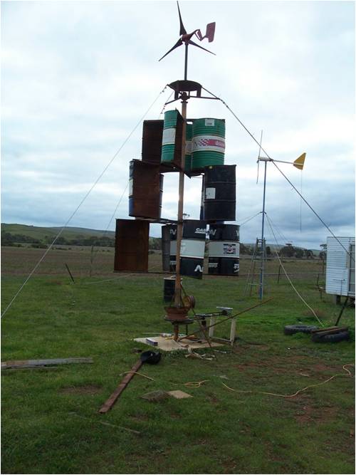

grolly
Joined: 19/05/2007
Posts: 62
Posted: 04:44am 05 Sep 2010
Hi VAWT,
Go for it buddy,the expreimenting that these guys did to aquire all this information is fun, successes and failures combined, so if you build it the wind will come and some power will be made.
this wirrlygig runs two F&p old style rewire, sat night putting out 15 a at 13.4 v, each while the house was running off the inverter.
Half the fun is in the building
Grolly
I have bought the farm...now I AM powering it...

Downwind
Joined: 09/09/2009
Posts: 2333
Posted: 04:32pm 05 Sep 2010
Thats art not a windmill
I would think it would get a fair old rattle up in a good blow.
What sort of RPM do you get out of it.
13.4 volts is a little on the low side for charging batteries, 13.8 to 14.2 is what is really needed. (for 12 volt)
