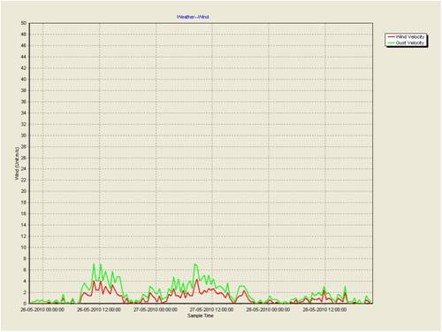

Yes the gusts can be mutch higher, but without a instantanious reading ASI its difficult to get it accurate even the weather station has it limitation for responding to gusts
This is a graph of the type of wind experienced but not at the time I was talking about as I have to replace the battery in the roof top sender, got a battery yesterday but haven't fitted it yet. The wind speed here is higher than experienced when got those readings I think the last half of the graph is more representative of what I had when I took those readings.
I have found the same thing with the GTI and partly overcome the problem by fitting a large capacitor bank across the input, on the 300 watt one I have a 330,000 uf 85 volt cap, and that makes it more stable but it needs to be larger capacity, on the 1200 watt one I plan to use a 3 farad cap out of a car woofer amp power supply. Without the caps they seem to go into a oscillation with the landing control.
Without the caps the voltage can rise quicker than the inverter can synchronize as it is unloaded, it then goes into a overload and shuts down, then repeats the process, once it locks on to mains frequency it is better but gusts can cause it to over voltage and drop out. I think some of these new super caps would be ideal but their voltage rating isn't high enough yet.
The MPPT circuit seems to have a power time constant more suited to Solar Panels. When using them on the batteries I have found that they need a bleed resistor to slowly charge the internal caps otherwise the inrush current destabilizes them and can blow the fuses. 470K 1 watt seems to work, not calculated, just tried it and it worked.

Sorry, but The graph above is pretty hard to read! I have found the DAVIS anemometer responds well. I have the same unit on my weather station as my computer logger, and the units correlate well. Apples and apples.

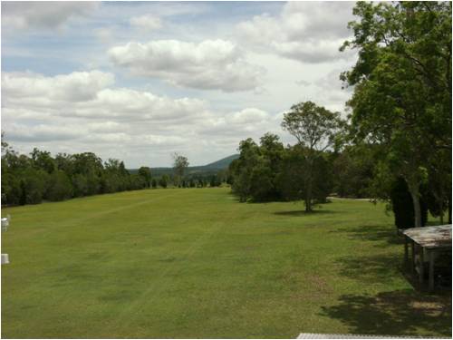

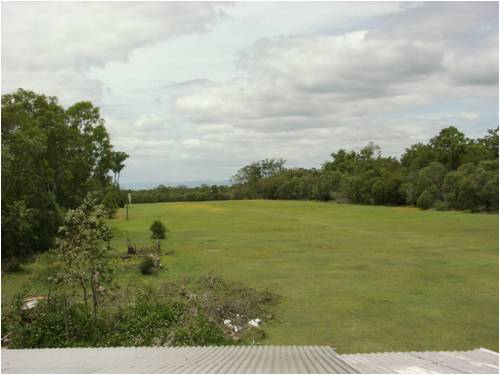

Hi Hugh
Just to give you an idea of the clear passages for wind, this picture is looking south with the rand of hills in the distance is th part of the great dividing range on the New South Wales Queensland border.
This is the primary wind direction for fronts moving west to east.
The next picture is to the north where the main heavy summer winds come from, mainly the north west from tropical storms and remains of cyclones.
The band of trees to the east is a pest but thats a work in progress.
All the best
Bob

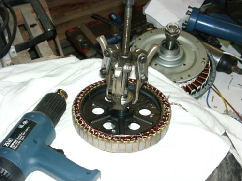

Posted: 02:28pm 18 Nov 2010
Hi All

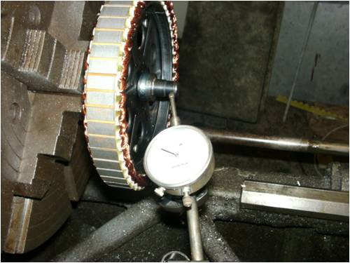

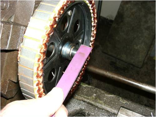

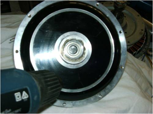

This is a neat little mill with potential way beyond its humble looks, however like all turbines I have seen from china the basic concept is good but the engineering in construction and assembly and wiring is a bit suspect, so before putting it up Phill recommends a blueprinting of the unit along with a few minor modifications for long term reliability, so I have put together a few photos to show what I did to the alternator, I got a bit carried away but in the long term I think it will make for a better and more versatile unit.
The alternator needs to be fully dismantled to carry out this work.
The fitting of all the bearings is press fit in the housings front and rear and is very tight to dismantle so I used a heat gun to expand the housings so it could be dismantled without damaging the housings.
The bearings where also a press fit on the main shaft.
The bearings where so tight on the shaft that it slightly expanded the inner race and caused the bearing to bind internally, causing the rotor to be harder to turn, not a good thing with a wind turbine as everything needs to be as free as possible to allow easy starting of the blades.
The solution.
To linnish the bearing seats down till the bearing can be a firm push fit on the shaft.

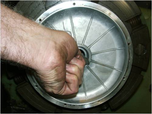

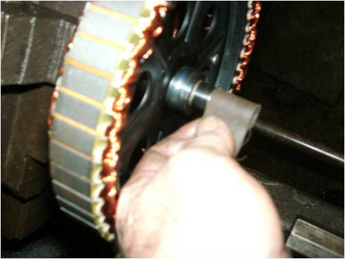

This photo is the final polishing of the bearing seat and is needed to get a smooth but firm sliding fit of the bearing, however the bearing seat was so far oversize and as hard as the hobbs of hell I had to get a bit tough with it.
This is a diamond lap used for sharpening carbide tipped saw blades readily available at hardware stores, I tried a file and it just slid over the surface without cutting the metal was so hard. Looks complex but in fact only took a few minutes.
The front bearing.
The front of the shaft was was also oversize and a little mushroomed from the pressing the shaft into the center boss on the stator so more of the same treatment.
Front and rear covers.
The idea is to just polish the machine marks out of the housing to make the cover a smooth sliding fit on the bearing, this is done on both covers. The front cover is important to have as a removable fit as the wiring is behind this cover and that allows a switch from star to delta or visa versa should that be require down the track. More on that later.

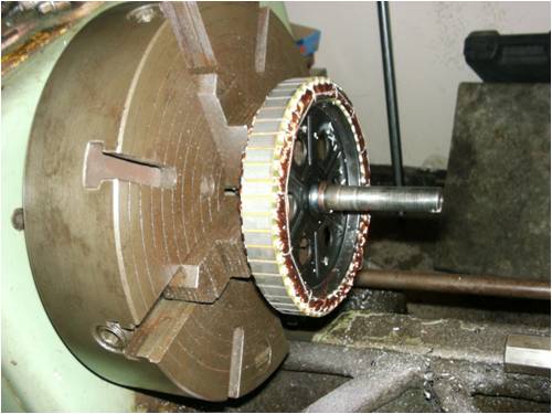

I did these modifications in the lathe as it was convenient but it all could have done by hand in a vice with soft jaws to prevent damage to the shaft.
It is important to get a good Finnish on the shaft to allow a nice smooth sliding fit without clearance, its called a size on size fit in the trade, and is used where parts need to be dismantled with ease, not like a press fit that is more permanent but harder to work with down the track.
When setting up in the lathe a dial gauge is used to set for zero run out in a four jaw chuck, I use the four jaw chuck because it can be set for zero runout whereas a three jaw self centering chuck is always a bit of center, unless you have access to a very high quality one, most of us are using what we have and isn't always ideal
Thats enough for one night,more bit following over the next few days.
