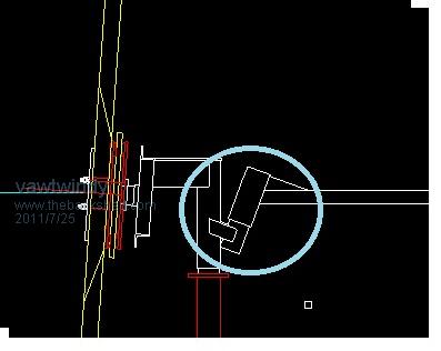

can you tell me how the furling works in it as attached in your .dwg extracted image?
usually i keep a small piece to tab for low end stop as attached.

Hi vawtwind, here are the pictures of the stationary jib furling.

I hope these pictures will have clarified the furling.

its pretty clear spitsfire, i was worrying about that tab, coz, many of the documents doesnt show much importance on that part
