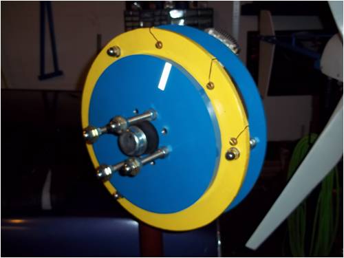

The thing with this style of alt is the that you can open or close the gap to adjust the power required to run, and i'm going to bring the coils to the outside so some experimental wiring can be made, ala "Jerry Rigged" and such. the german board has tossed that one around quite a bit, and so has vawt.net and the concensus for vawts is?. But I am going to make a platform I can test a lot of ideas because I don't need the power but I am determined to make something that can be duplicated and is my own design and usable on different platforms. I am drawing from information donated from a lot of different donors and hope it doesn't become too much of a bastard son but its like the wings; a platform for expirementation to follow.
Nice looking unit by the way Perry, are all the wires accessible or just the phases?

Only the phases are accessible on the outside. It's wired in star configuration internal to the stator

Ooh, Lloyd no problem. Did you see that my post is with a smile. What do you say to my new alternator? I think the graph is quite interesting. new alternatorEdited by miroc 2010-12-14

It is a nice unit. looks like a nice construction. I hope you don't mind me using it for an example of the way i plan to make my unit look but with an extended live shaft to carry the wings. You have a lot of power available and it is too bad the price had to go so high but the first ones are always like that . Do you think the construction costs will stay that high? The one I plan to build will be like a baby compared to it. I like the efficiency too:<)
