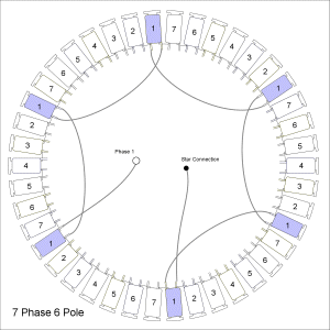

The new hub has 48 magnets, meaning we need to re-wire the stator into a 7 phase alternator. Now to keep these new 7 phase configurations separate from the old 3 phase configurations, I've come up with a new naming scheme.
7p3p
The 7p means its a 7 phase conversion, the 3p means there are 3 poles wired in series. The new 7 phase alternator has a max pole count of 6 for each phase, where the old 3 phase conversions had 14 poles per phase. We can divide the 6 poles into one group of 6 poles in series ( for max voltage ), 2 groups of 3 poles in series, 3 groups of 2 poles, and 6 groups of 1 pole ( for max current ).
So...
7p6p = 6 poles wired in series. Max volts, good for slow running windmill.
7p3p = 2 groups with 3 poles each. Less volts more current than above.
7p2p = 3 groups of 2 poles. The best all rounder, similar to the old SP configuration.
7p1p = 6 groups of 1 pole, all wired in parallel. Max current, suits a fast windmill.

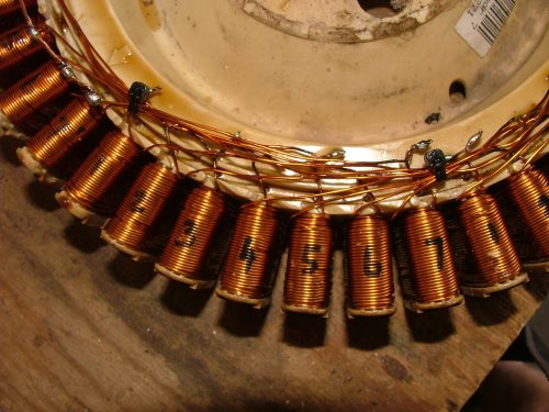

Last night I re-wired a 0.8mm wire stator into 7p6p to test on my slow turning Lenz windmill....
You can see how I numbered the coils to make it easier....

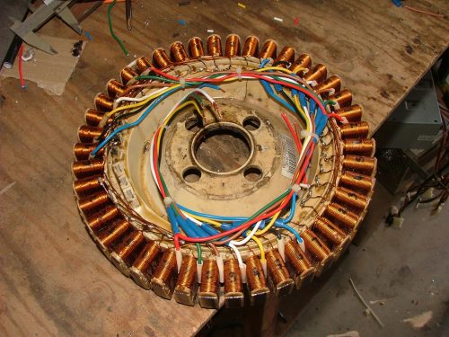

That worked a treat, no noise or cogging. Then I re-wired the stator as a 7p2p to suit my faster turning HAWT windmill....
I looks ugly, but hell, its a prototype. On the windmill it started in a slight breeze, and was pumping over 10 amps once the wind picked up. This configuration is very similar to the old SP conversion. We still use 2 poles in series, but now there are only 3 groups of these paired poles where a old SP had 7 groups. Now before you think we must be down on power since we have less than half the groups paralled together, remember this is 7 phase power, so there is no net loss. I wont go into this now, but 7 phase power is just as good ( in fact slightly better ) than 3 phase power. Just trust me for now.
Here is a zip file with some basic drawings of the different conversions.
2006-10-14_185345_7p1p.zip
Each drawing only shows the configuration for one phase, you just need to do the same for the other 6 phases.
The Star connection is a common connection to all phases.
I'll draw up more details in the next couple of days, but for now, If you used a common SP conversion, go for the new 7p2p conversion. A little tip, if you unwind the outer wire one turn, its long enough to reach the next pole ( 7 poles further around the stator ).
We've done it, a cogless F&P windmill that starts in light winds with fast blades. Not only does it start easily, but output is improved because we arnt using reshaped pole ends or skewed magnets.

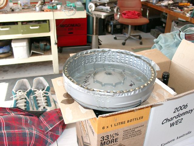

Sory guys ,the clothing is because it's for the brushcutting---the handbrake won't allow me to wear dirty grassy stuff inside ,so I have to strip off before racing to the shower---The booze, well before I found out about windmills,none of that was necessary,lol.
PS. if you use "Gaffa" tape to form a dam before you pour resin --make sure it's the fibre cloth re-inforced stuff, my ordinary plastic stuff sort of melted and some resin spewed over the edges- oh well, shi# happens.
